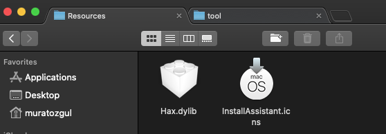

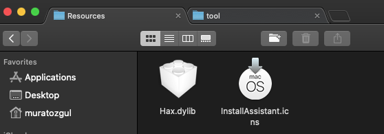

Thank you. I tried and I got prohibited sign again. I also checked on the Install macOS Beta USB Contents/Resources Looks like everything ok. But still getting a prohibited sign.

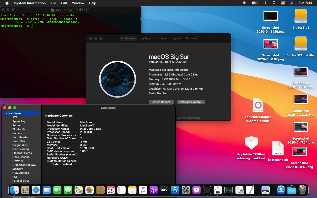

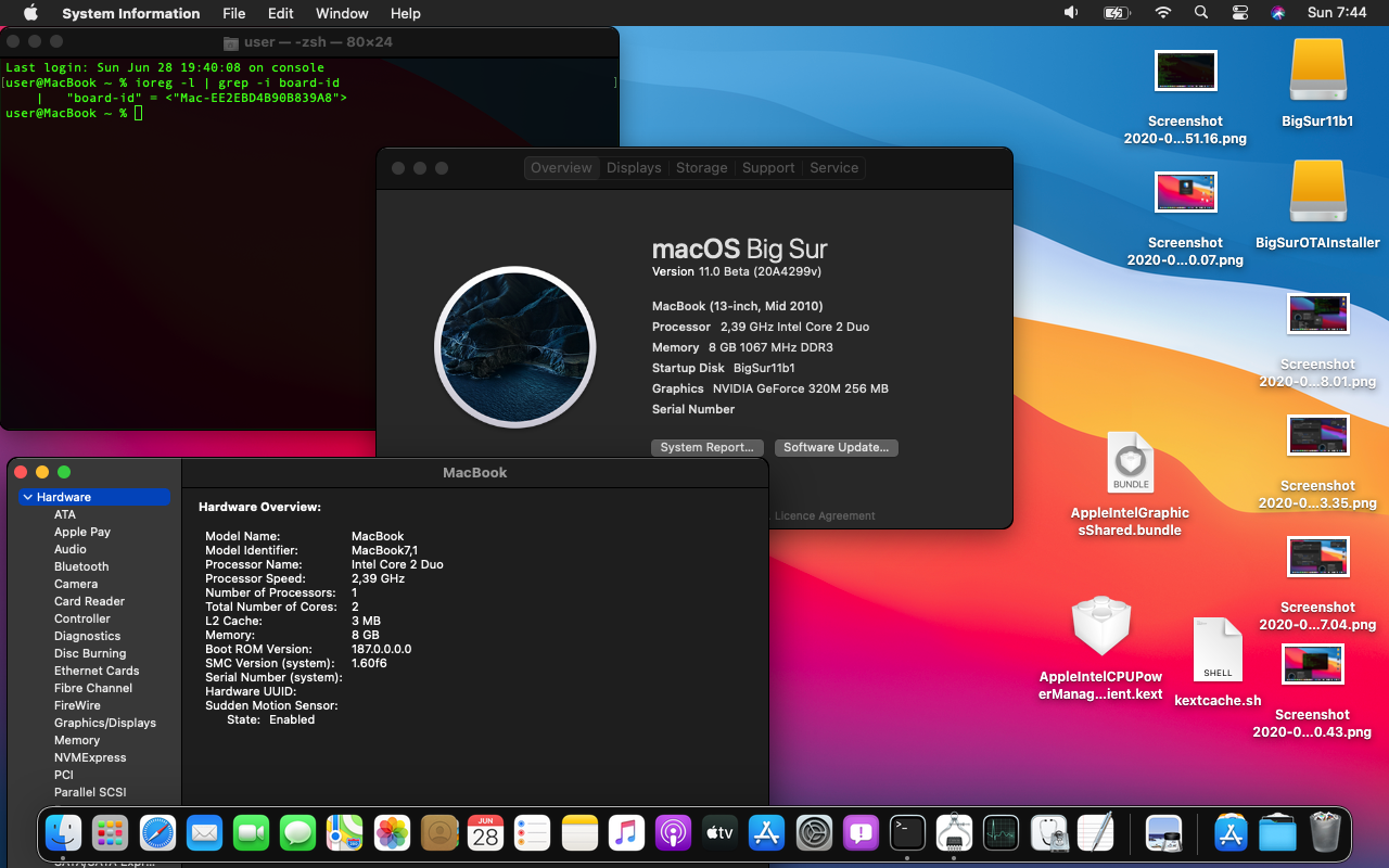

Another easy method is if you clone from a BigSur install or have an already installed BigSur on external USB disk: Example non-APFS IOUSB legacy external USB BigSur installation
You should re-install from Catalina your BigSur using this: Hax2.dylib
then you can remove telemetry from BigSur single user mode.

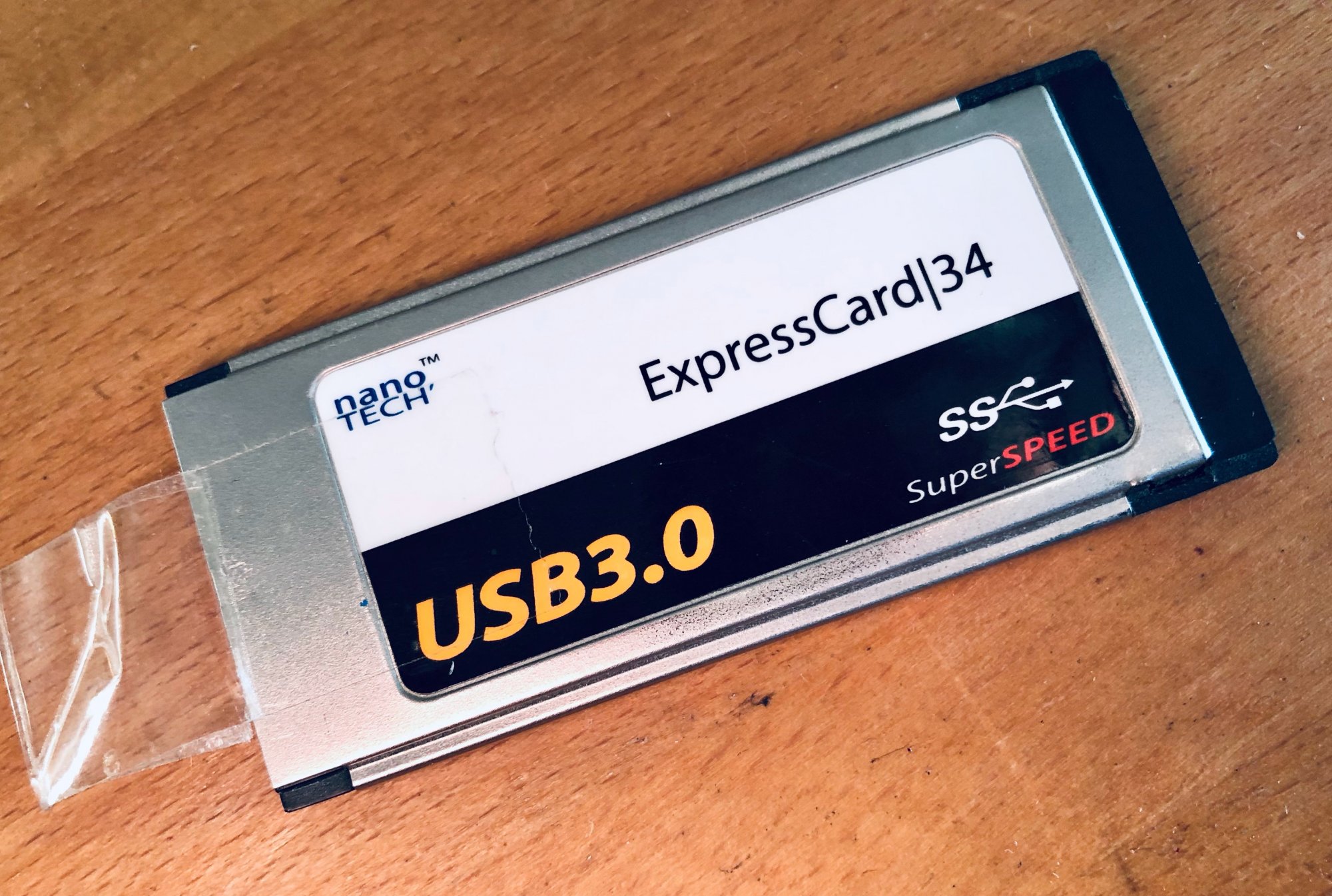

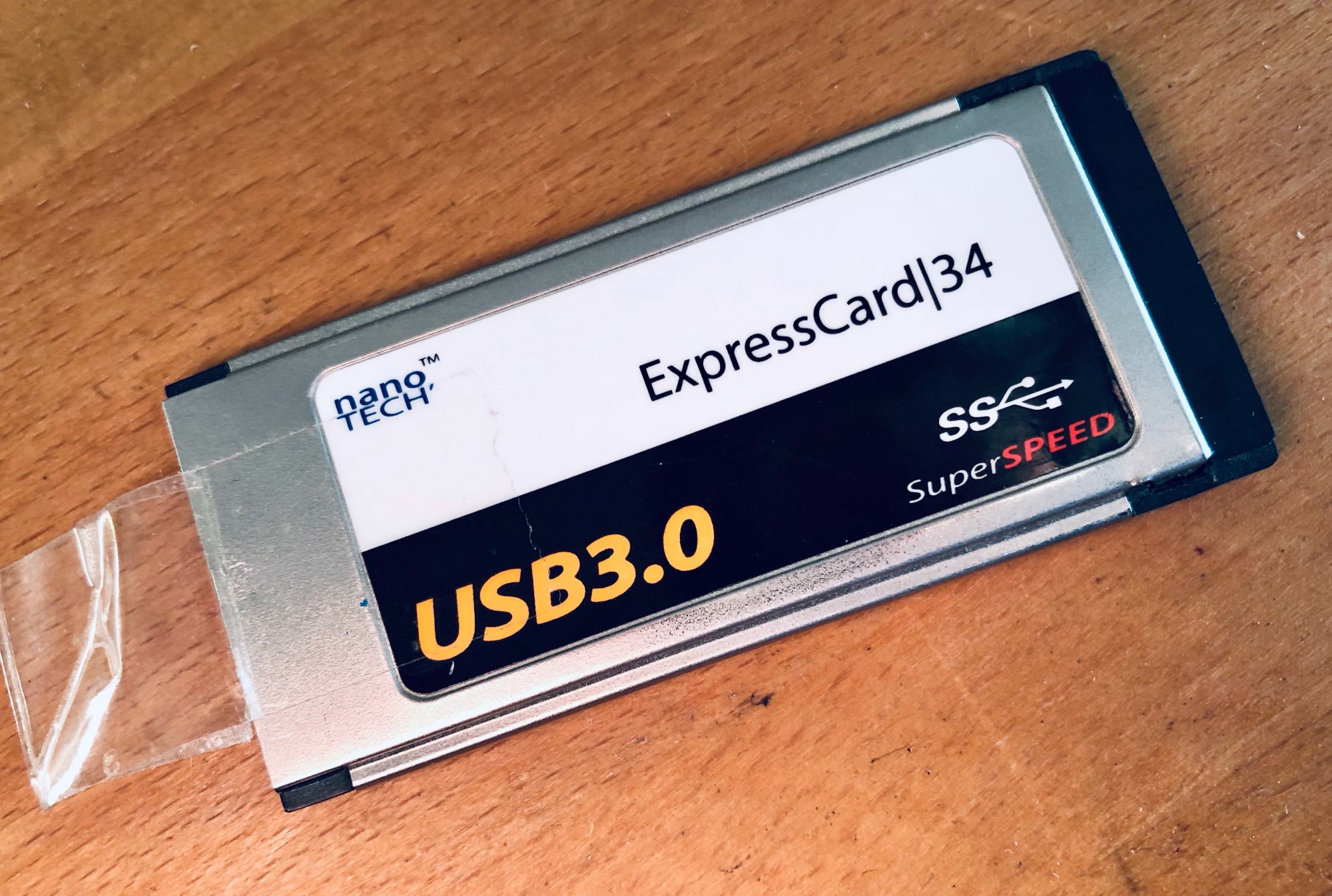

This one, will have to check the chipset used (I think it was NEC but I have to look it up tomorrow).
edit:
See vendor/product ID screenshot. It is supported out of the box, no further kexts or plist mods required.
That looks good to me. Thanks! I've ordered one via ebay.com, about 35 USD.
My hope is that one can install BigSur to disks connected this way, which is currently not possible via on-board USB connectors of older MBPs (like my MBP5,2).
Though maybe jackluke and company find a software means like they did for OTA updates to Catalina for disks connected to USB of such machines.

@hvds I also create USB installer with @jackluke USBOpenCoreAPFSloader3 but even with that I am still get prohibited sign. I will look the posts you shared. Thank you. 👍
You missed 1 step thats why it's showing no entry sign.
If you installed big sur on a separate volume then boot into Catalina-> open terminal and run this command
sudo nvram boot-args="-no_compat_check"
Then boot into big sur.
or boot into recovery and run above command in terminal then boot into big sur
