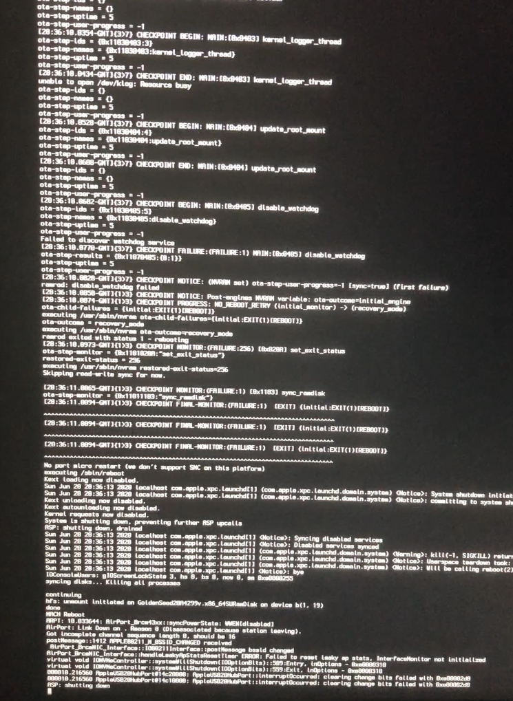

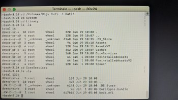

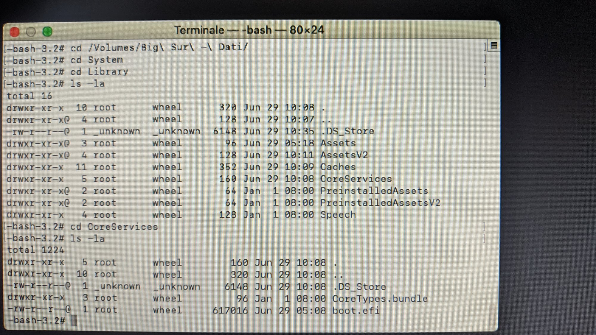

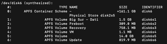

maybe i should try to remove the telemetry does someone know the terminal command for that?
Yes please, dear @ASentientBot could you show us the terminal script to remove telemetry from Big Sur volume, and from where? It seems to me to have correctly completed the installation and I have 2 volumes: "Big Sur - Dati" and "Update" but I cannot enter Big Sur recovery because It crashes after screen changing from black to white, while from Catalina Recovery I don''t find volume Big Sur's path /System/Library/UserEventPlugins/ to delete com.apple.telemetry.plugin. With It, macmini4,1 crashes before reaching first Language configuration.
Thank you! Alex

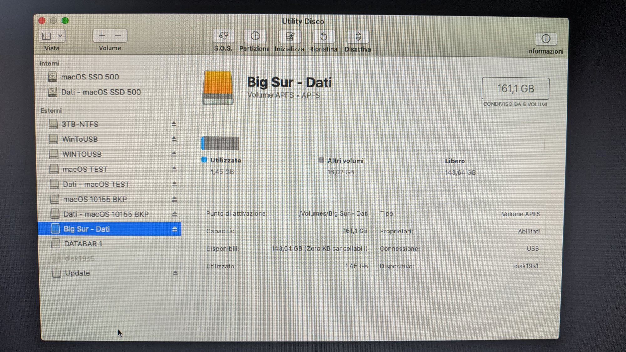

The steps are correct, now I explain how to make working Legacy IOUSB and telemetry fix on a non-APFS mac:
From your external USB Catalina diskutil mount Preboot locate your UUID-BigSur
replace and copy this file (note this file is mainly for those who use USBOpenCoreAPFSloader3 even if prelinkedkernel will work also on recent mac): BigSur prelinkedkernel fix.zip
copy (and replace) in these paths:
/Volumes/UUID-BigSur/Library/SystemConfiguration/com.apple.Boot.plist
/Volumes/UUID-BigSur/Library/Preferences/SystemConfiguration/com.apple.Boot.plist
/Volumes/UUID-BigSur/System/Library/CoreServices/com.apple.Boot.plist
and maybe also here:
/Volumes/YourBigSurSystemLabel/System/Library/CoreServices/com.apple.Boot.plist
(this step is not necessary because are used those from Preboot)

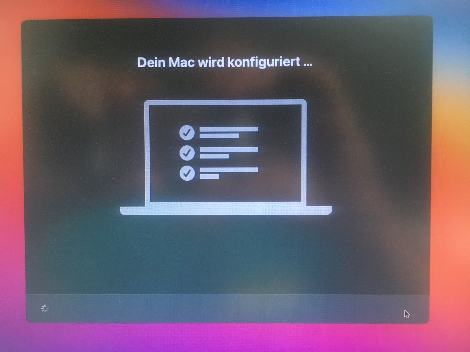

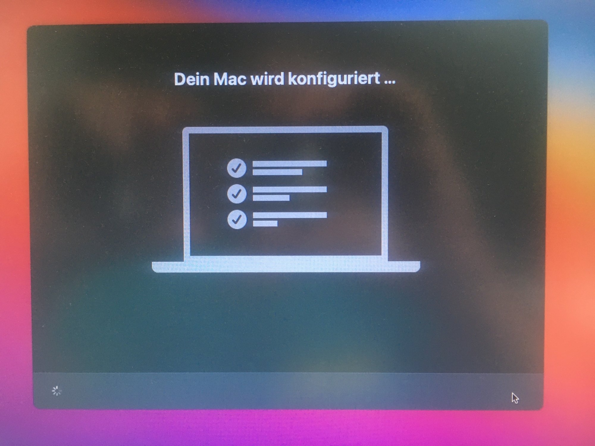

Success! Thank you jackluke.

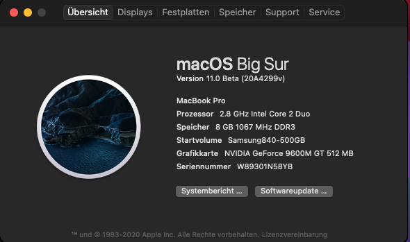

I only changed /Volumes/UUID-BigSur/System/Library/CoreServices/com.apple.Boot.plist with the plist I already had in the first 2 places.
Then booted via USBopencore and did get to the BS configuration screens, and then into the configured BS.
Will later today exercise it a bit. For now I'm working in Catalina.

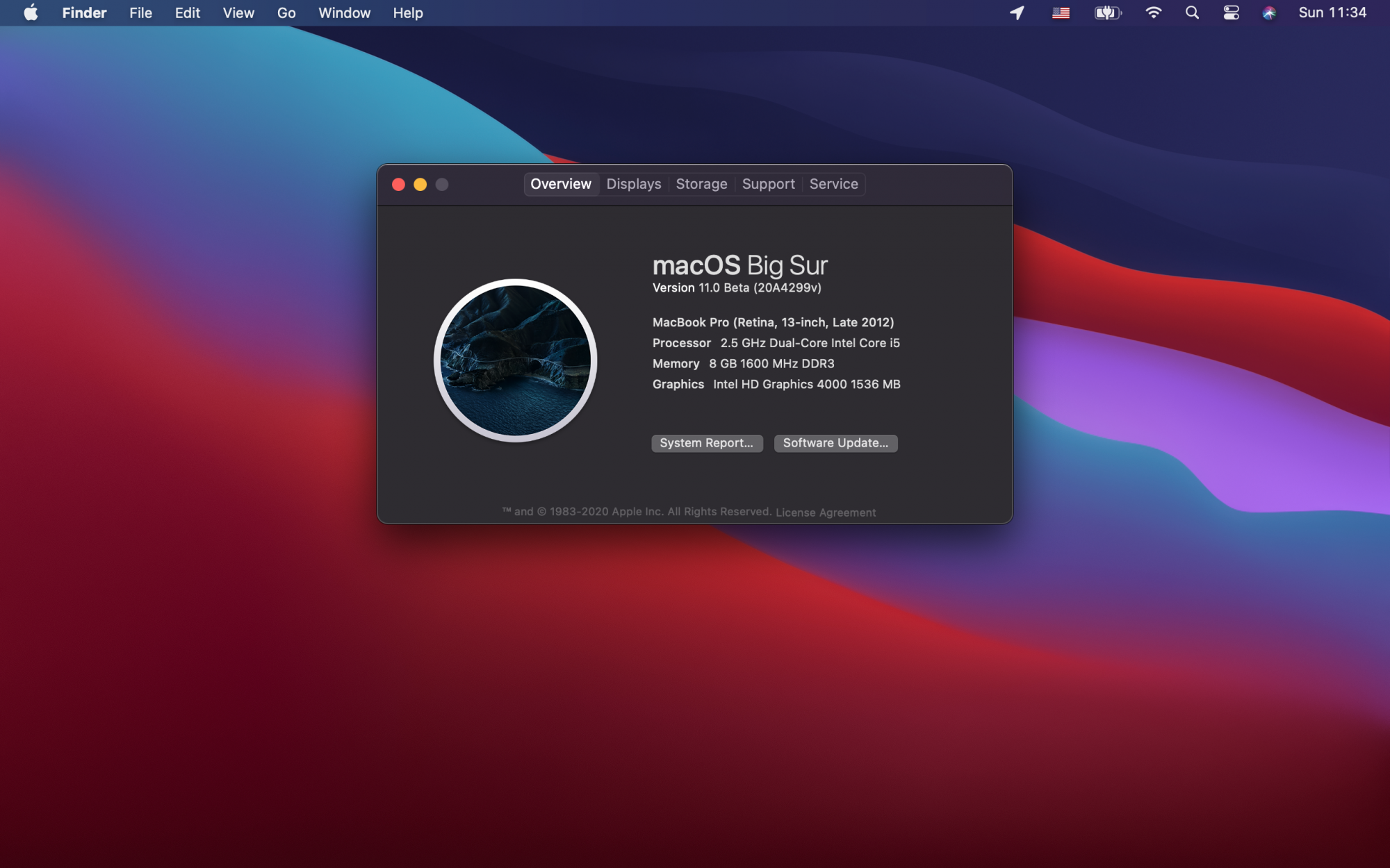

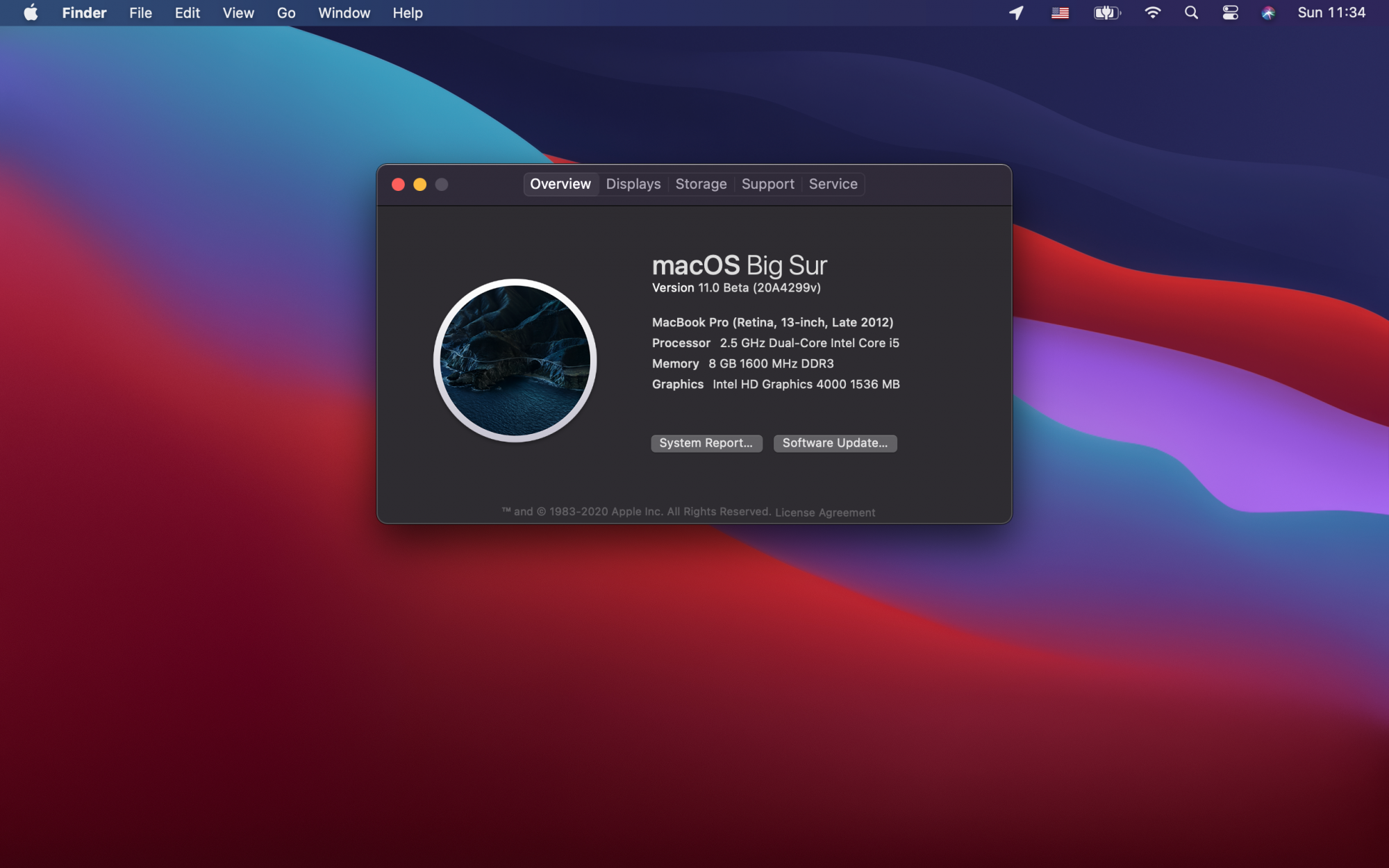

Thank you everyone! I got Big Sur running on a different partition on my late 2012 13" MacBook Pro!
As promised, let me update you on the WiFi situation. I previously upgraded the WiFi card to the 2013 MBP card (bought from Amazon), so that I could use the Apple Watch unlock feature. As a result, my WiFi worked perfectly out the box, even though on this MBP you supposedly need to use the patch. So if anyone wants to permanently avoid WiFi issues, upgrading the card might work ;).

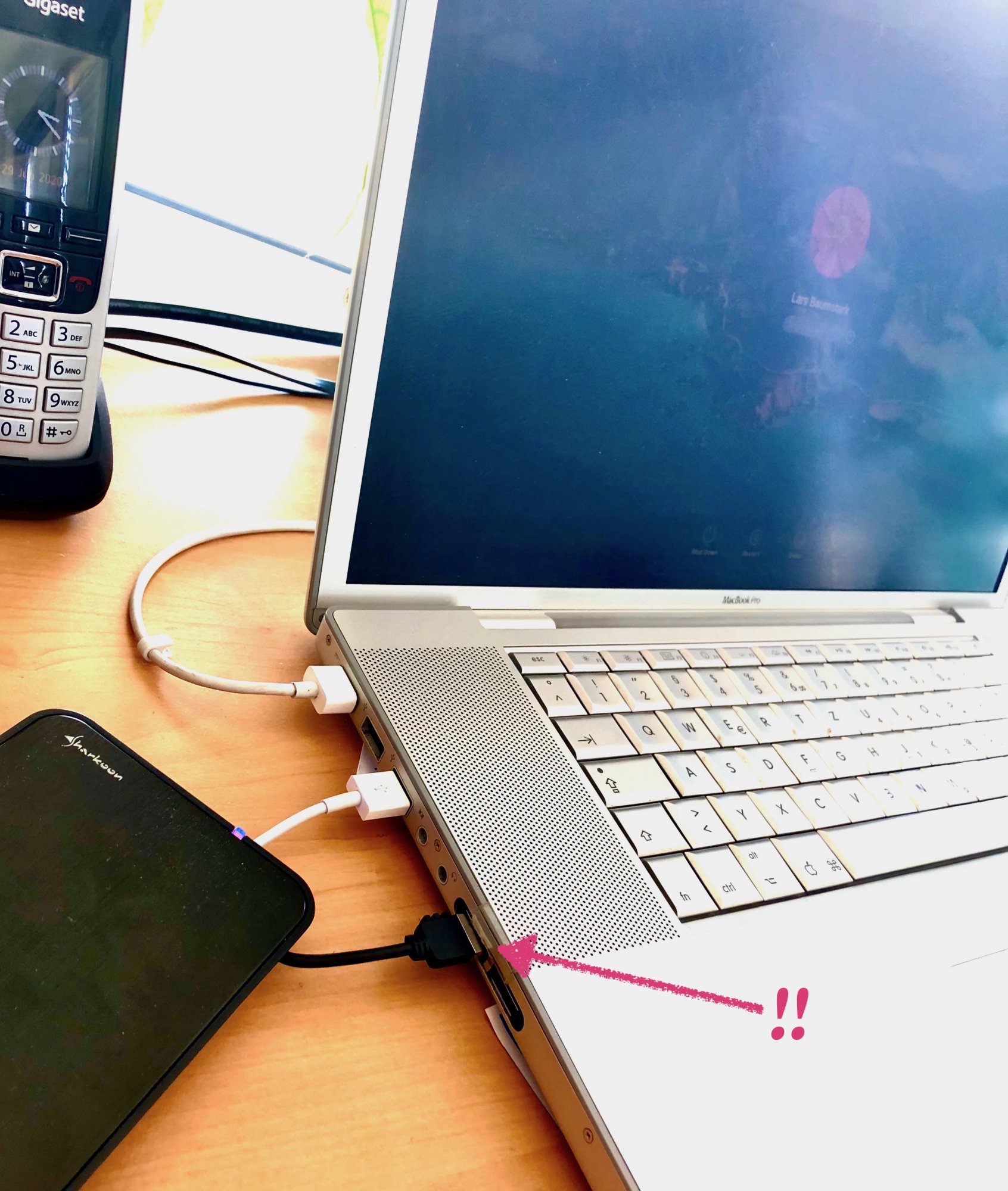

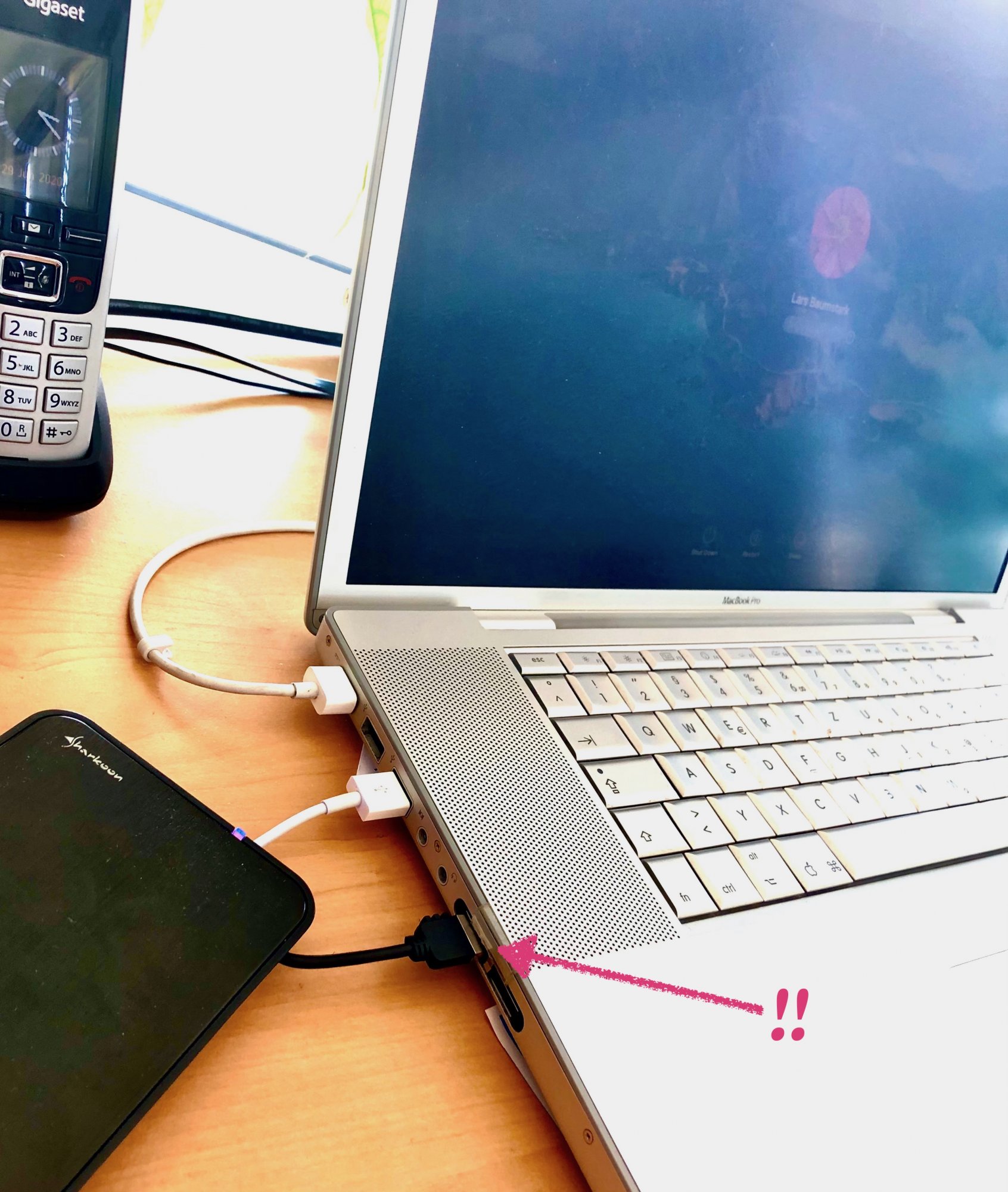

Another addition to the "zoo": Got my ancient MBP 4,1 (2008) up and running with Big Sur.
(Still to be done: USB injection).
I found an obscure boot-from-USB workaround without the missing USB2 legacy functionality:
I started booting the external USB on a built-in USB port of the MacBook. Once this loses connection due to power down / disconnect, it miraculously manages to resume booting when I connect the external drive (hotplugged) to a USB 3 expresscard (34mm) -> see photo of setup. This brings me all the way to the login... Stranger than fiction! ;-)

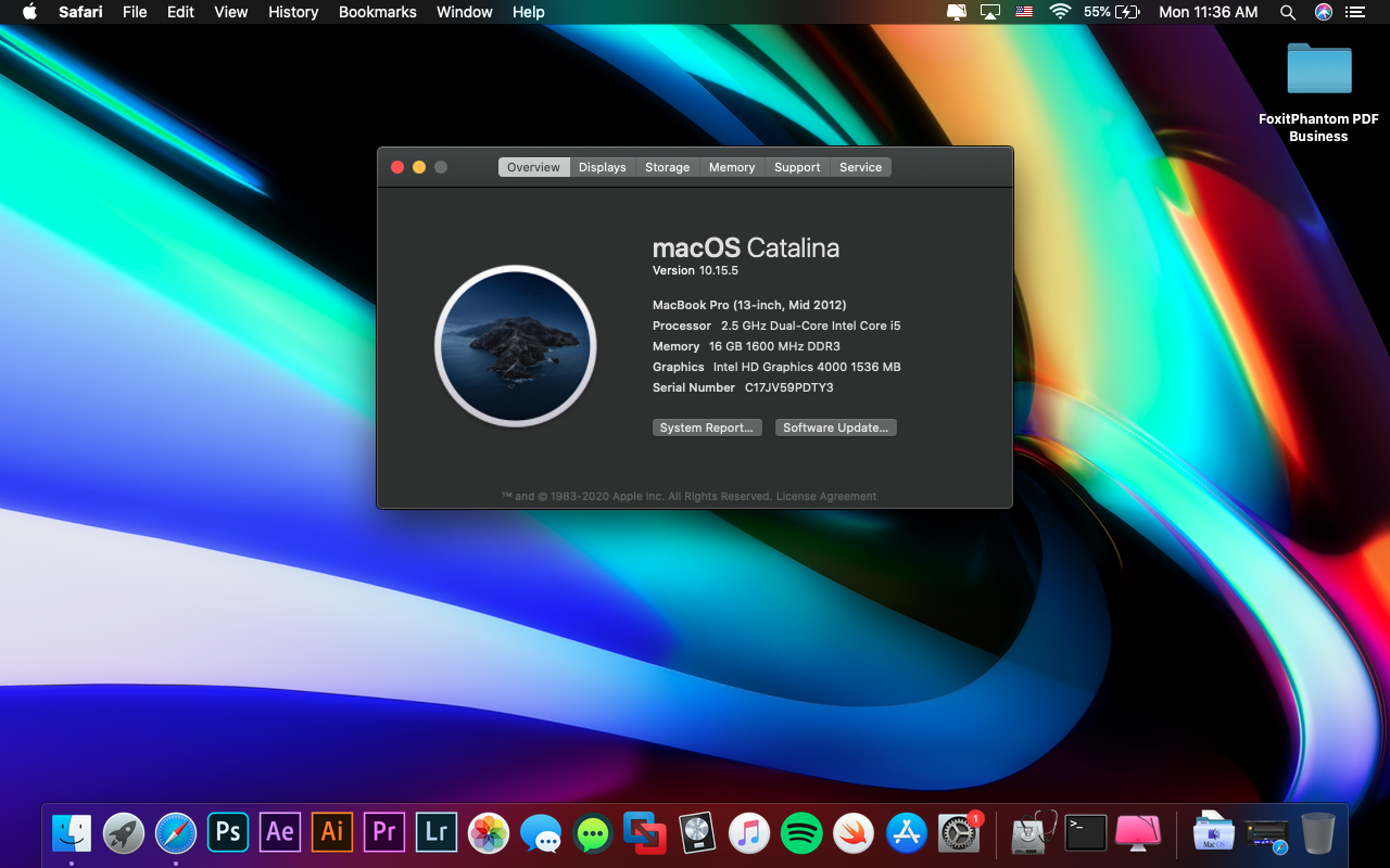

I tried doing it on my mid 2012 13 inch which it did install but when I tried to boot it gave me the ghostbusters symbol. AKA the prohibitory sign so I almost lost all my data I had to delete the non data partition and reinstall Catalina and wait almost 5 hours to finish copying the 360 gb of data and almost filling my drive because I had to copy everything and then delete the old data partition to free another 300 gigs any suggestions of what I did wrong (I did Disable SIP)
Any idea what could that be? After the first stage while install (28min) finishing looks like recovery installed and after auto-restart the second stage I am starting to get this; is there any trick to past this part; probably if I past this installation will be finished. I can never past this part.
