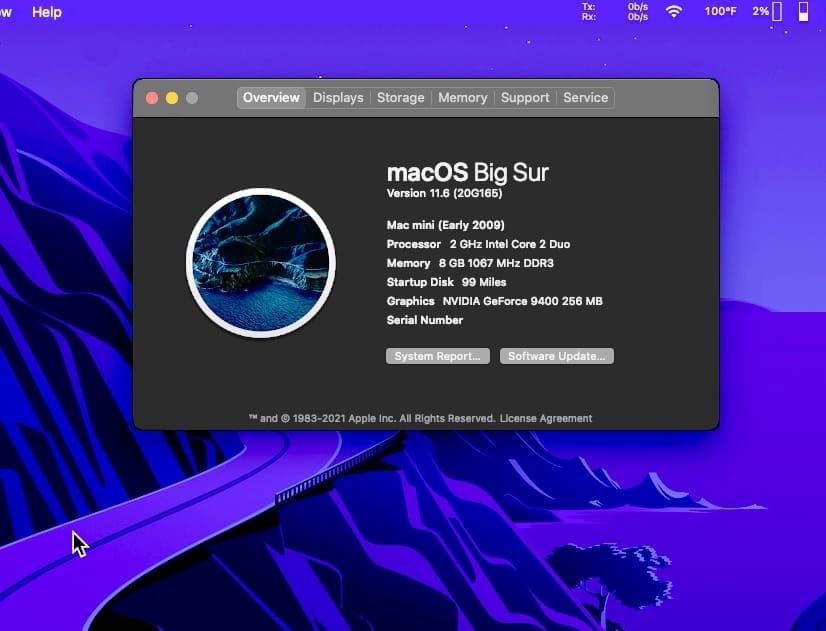

Made a new macOS 11.6 USB, installed on top of 11.5.2 successfully after applying Step #3 - OCLP_025n Offline variant. Ample performance on 2GHz Mini3,1. 👀✌️🧐
