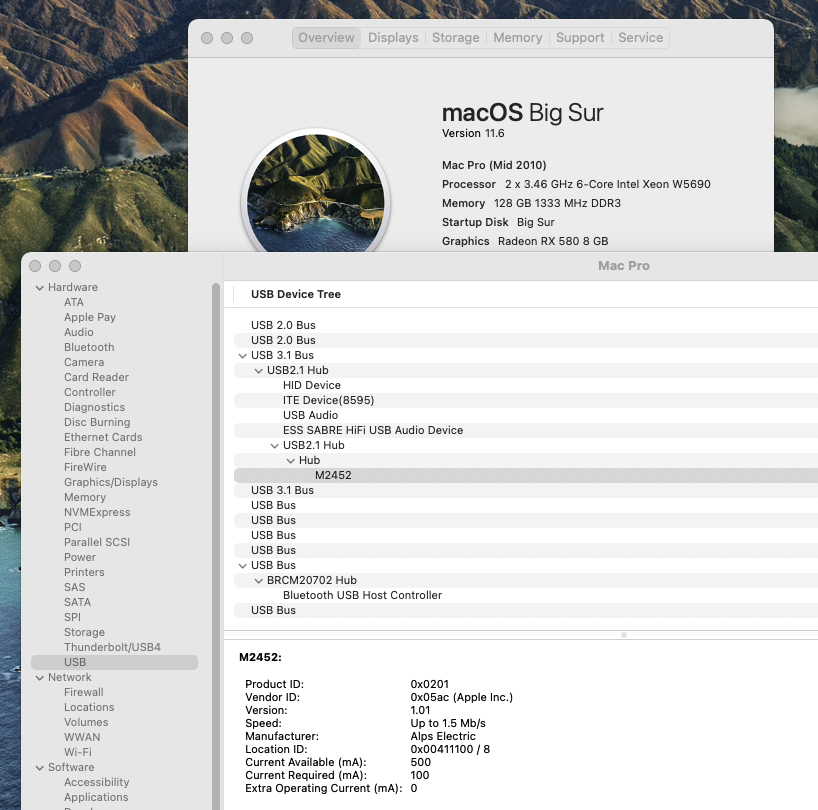

With the release of OCLP the update to 11.6 on a cMP5,1 was mostly flawless in my case. The download via software update was about 5.7GB and took a little over 3 hours just to download. However, there seems to be an issue with the keyboard I have plugged into my monitor that goes through a KVM switch between a gaming PC and the cMP. The keyboard worked fine with 11.2.3 and OCLP 0.2.5. I don't think the issue is with OCLP since the keyboard works in the boot picker screen. After the system boots to desktop the only way to get the keyboard to work is to plug it into the USB 3.1 card in the back. No other ports seem to be working although the ports themselves show up in the USB section of system report. The Bluetooth module seems to be the only USB device to work other than the card.
How the KVM is setup: the keyboard connected to the monitor goes to the PC via USB C when Display Port is the input. When HDMI 1 is the input the keyboard goes to the cMP via USB A to the USB 3.1 card.
As a way of troubleshooting I connected an old PowerMac G4 via DVI to HDMI adapter (with the same USB 3.1 A cord to transfer the keyboard) and the keyboard worked fine switching between the PC and G4.
After 1 of the many restarts there was 1 time the keyboard worked long enough for me to login but wasn't detected once I got to the desktop (via port on front of cMP). The keyboard always works for the boot picker screen no matter what port it's plugged into.
Its all a bit weird.
There is 1 thing I changed when I upgraded to OCLP 0.3... I noticed secure boot model was listed as false so I enabled it. It sounded like something that should be enabled. Is this disabled by default for a reason? The cause of my USB issues? Always used default values previously. As far as I know the cMP5,1 doesn't need root volume patching. Checked the patcher TUI settings and it wants it disabled again.
I don't know how or why but I plugged in just the cable used to charge my mouse into the USB card and everything works? Everything seems to be fine even after 5 additional restarts. The USB 2.1 hub connected to the USB 3.1 bus is the KVM switch connected to the card in the cMP. Just wasted hours fiddling with things just to have a cable with nothing attached to it fix the problem.
