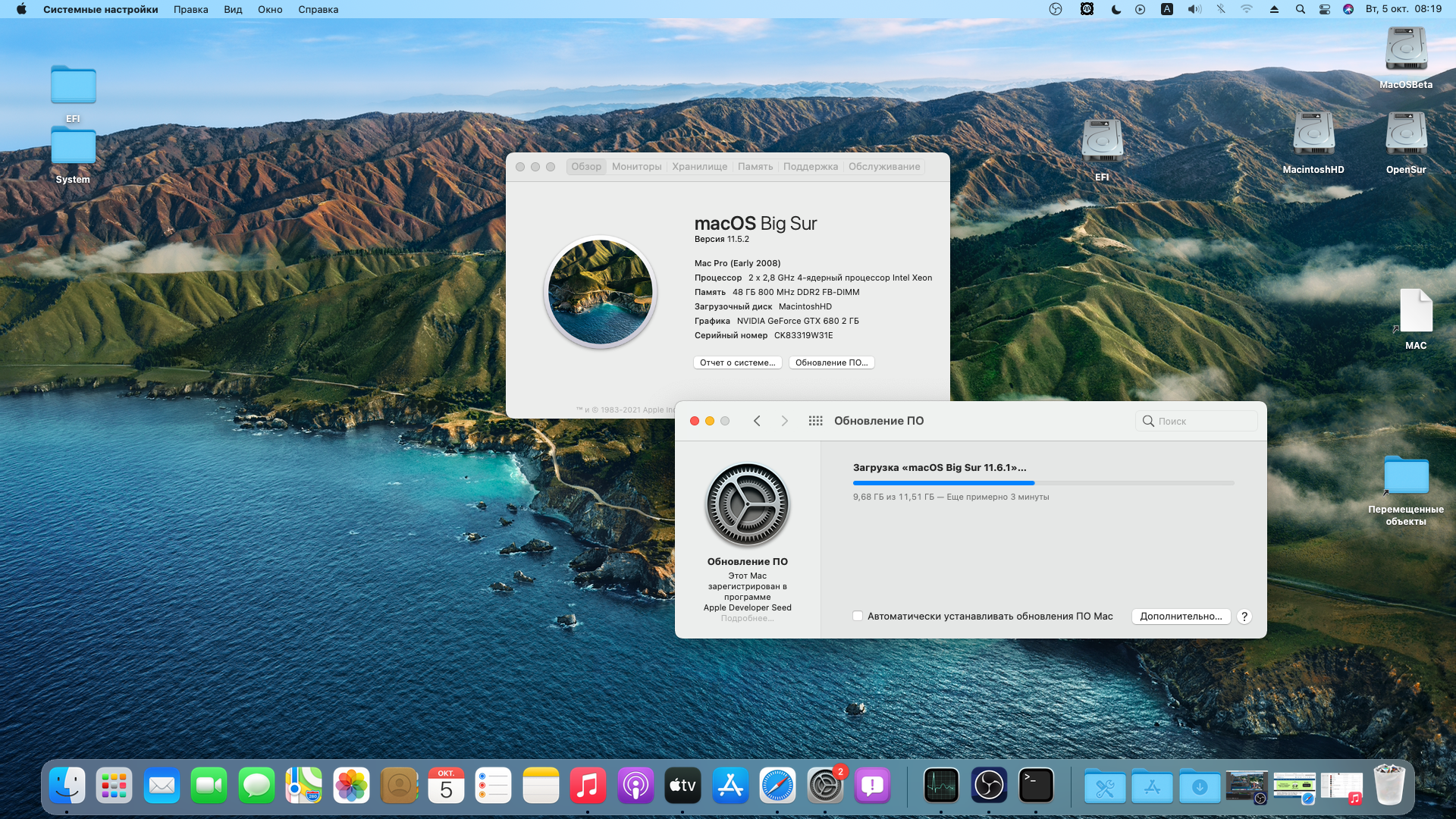

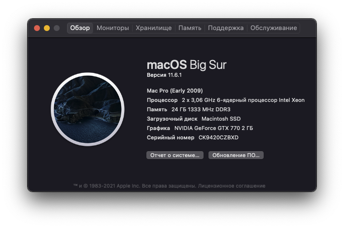

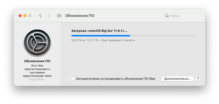

Hi to All!
OTA Updated my second system on my CMP 3.1 - from MacOS Big Sur 11.5.2 to 11.6.1RC (20G211), using OC config by OCLP NB.
Issues - no issues.
Sleep mod still don't work.
