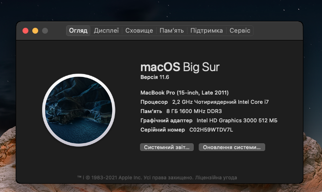

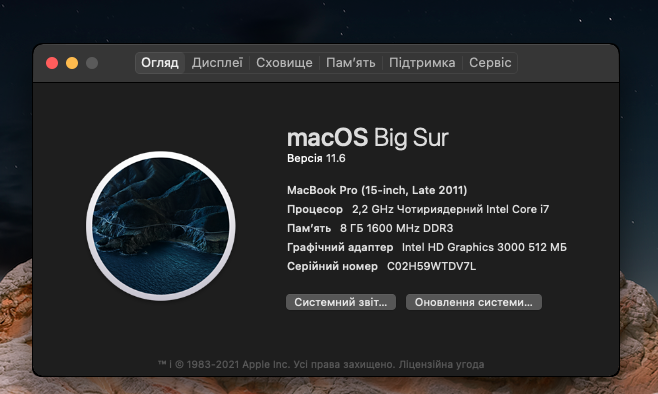

Installed succesfully on Macbook Pro 15' Late 2011. GPU permanently disabled with help of @dosdude1 youtube guide.
Ten years, and i'm still able to run latest XCode version on this machine. Thank you all, who keep working hard having these mac's run with latest firmware even in 2021.
There is some problems tho, Apple TV is crashing, plenty of graphical glitches, night shift is not showing in Display settings (but you still can enable it via new Control Center by taping on Display bar) but i hope all these thing are temporary. Wish i could contribute somehow...

11.6 was too much for me, I installed 10.15.7 and OCLP volume patch. Works perfectly. Since this is the Big Sur thread I won't dwell on it. But thanks for the help.
as much as they achieve acceleration on older devices, applications that rely on the metal API won't work like Apple TV.
for these cases, there's not much you can do, be content to be able to use the updated system or go back to the latest compatible with your hardware.

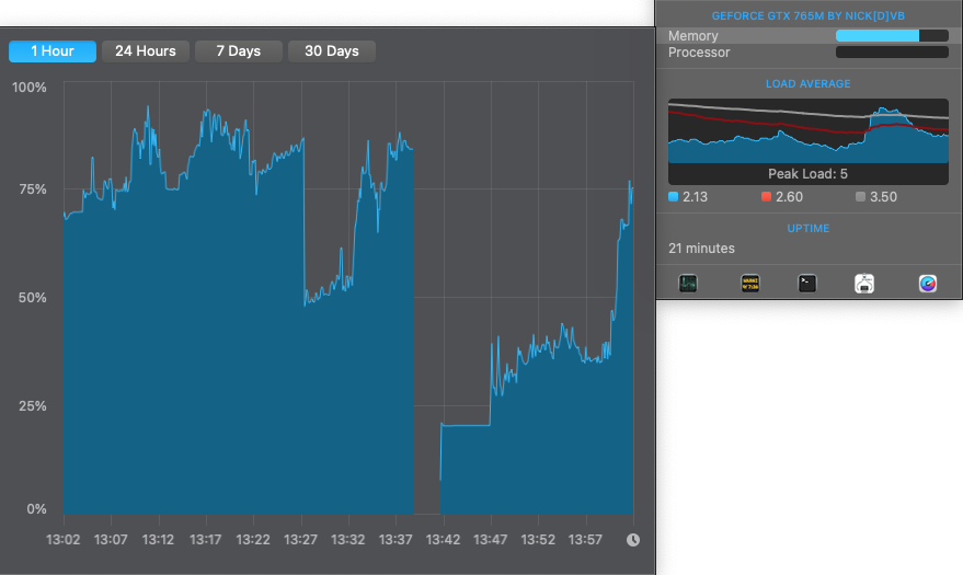

Me too. It has happened also during navigating in finder but most of the times it happens after opening a few more Safari tabs. I can still navigate in already open tabs but cannot refresh or load another webpage. If I click on any app on the dock it crashes (including Finder) and the windows start closing one after another.
I use iStat Menus to check stats from my iMac and I have noticed an instant increase on gpu memory from 40% to 90% after opening 3-4 tabs on Safari. I will stop using Safari and stick with Brave. It's working much better. The increase on the graph below is captured while I was using more than 4 tabs on Safari.
