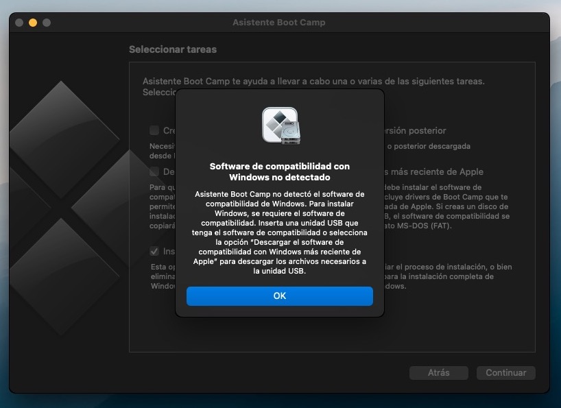

Anyone can help me with this problem on bootcamp?
<<Windows compatibility software not detected>>
I'm on OCLP 0.6.4, dunno if related but last year I did it successfully on the same machine with Monterey and now I don't even know what causes this problem on Big Sur.

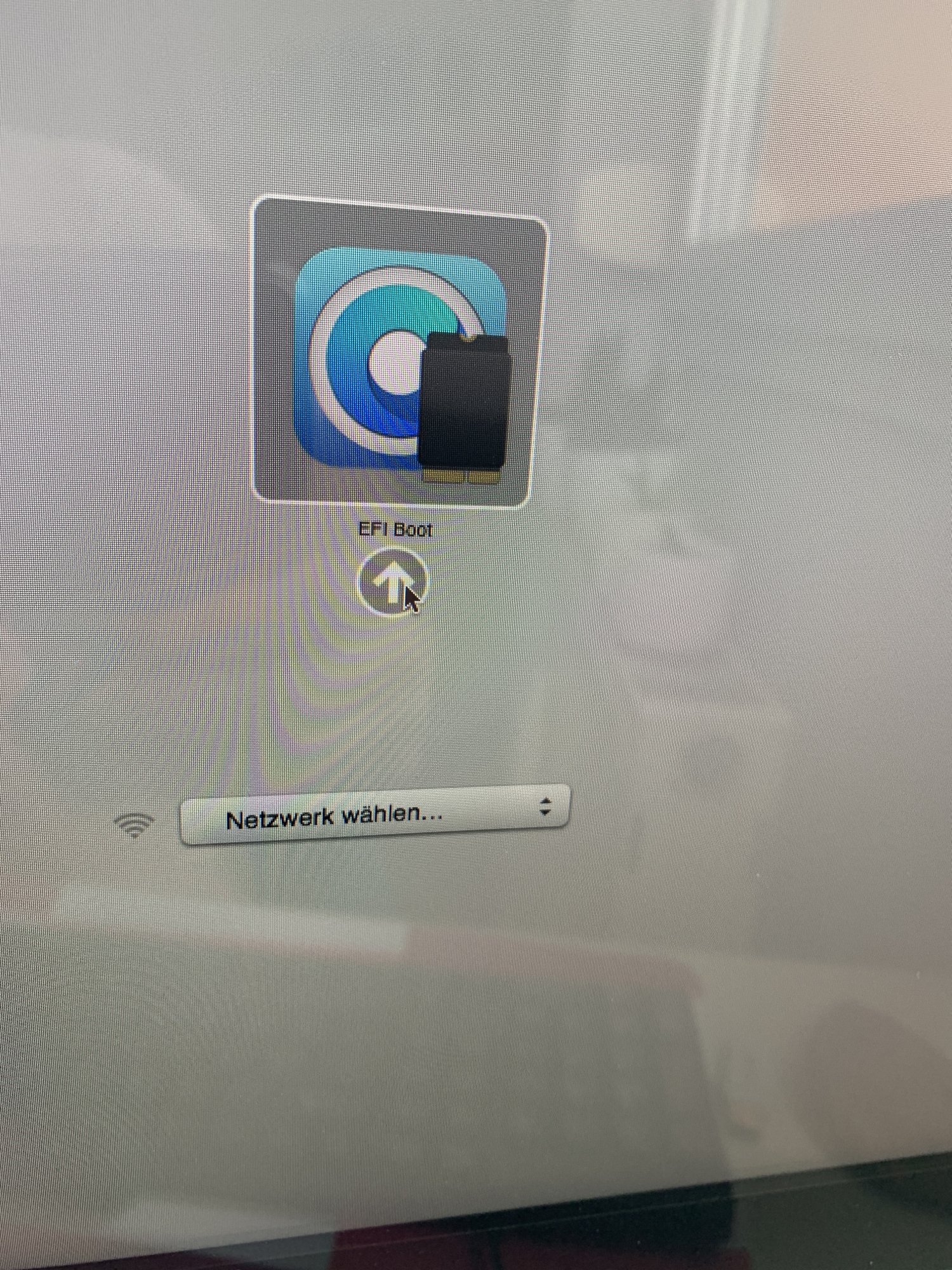

Hi folks, i unsucessfully tried to upgrade with my imac 2011 to monterey via oclp. Every time i tried i got a message about corrupt installation file.
So i selected with boot + alt my previous big sur efi boot on ssd and managed to start big sur again sucessfully.
Then i disabled in oclp setting show boot loader picker and restartet and got only a grey screen.
After hitting alt again and boot i wanted to select again my efi boot, but it didn‘t load when i push the grey arrow under the icon.
What should i do?

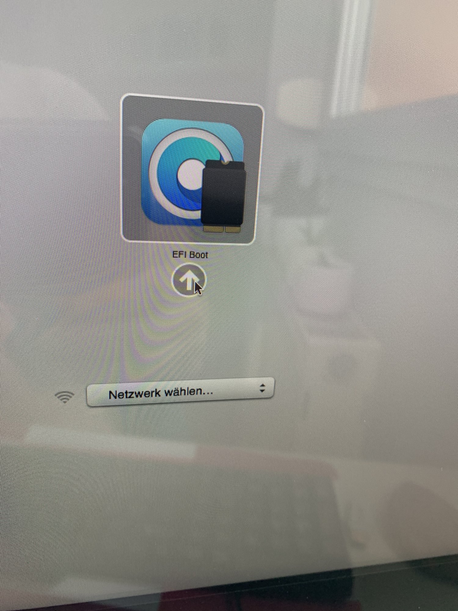

What should i do?View attachment 2204703

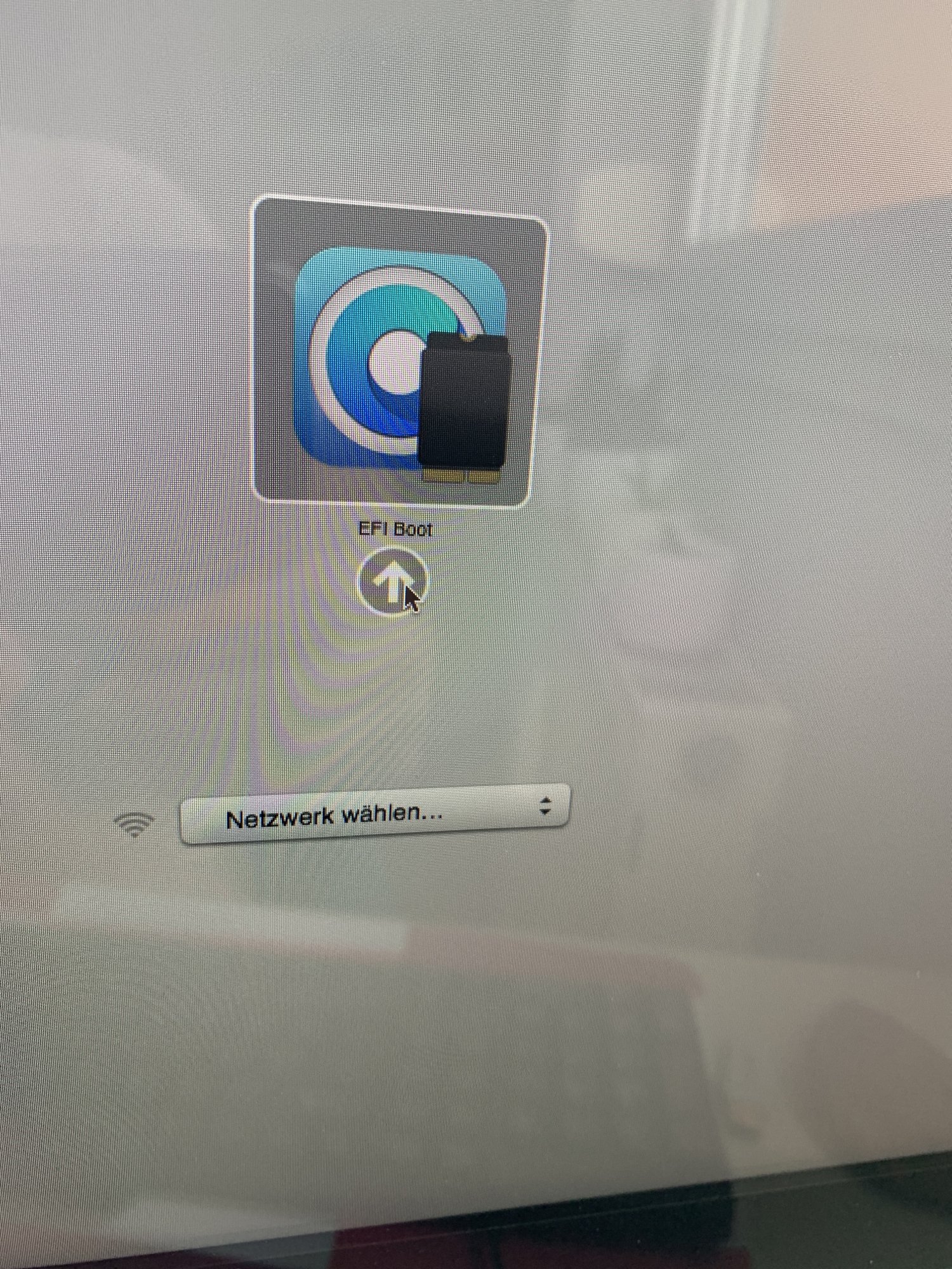

I tried a clean install via USB, before i made it i updated my big sur efi sucessfully to the newest Oclp and used the same version on the stick.
The problem is now that i can‘t get pass beyond the efi boot icon (pressing doesn‘t work) after i disable show boot picker as showed on my attached pic above.
So i can‘t make an new stick on this imac.
I can make it on a mba 2014 with big sur, but will the stick then also work on the imac? I think that it will suit up to mba2014 preferences for monterey or am i wrong?
Edit:
I just transfered a fresh efi through build up oclp for my imac2011 on my mba2014. (In settings i could change preferences to imac 12.1), but unfortuanetly after booting i still can‘t get pass through the efi boot icon. Nothing happens when i press it…

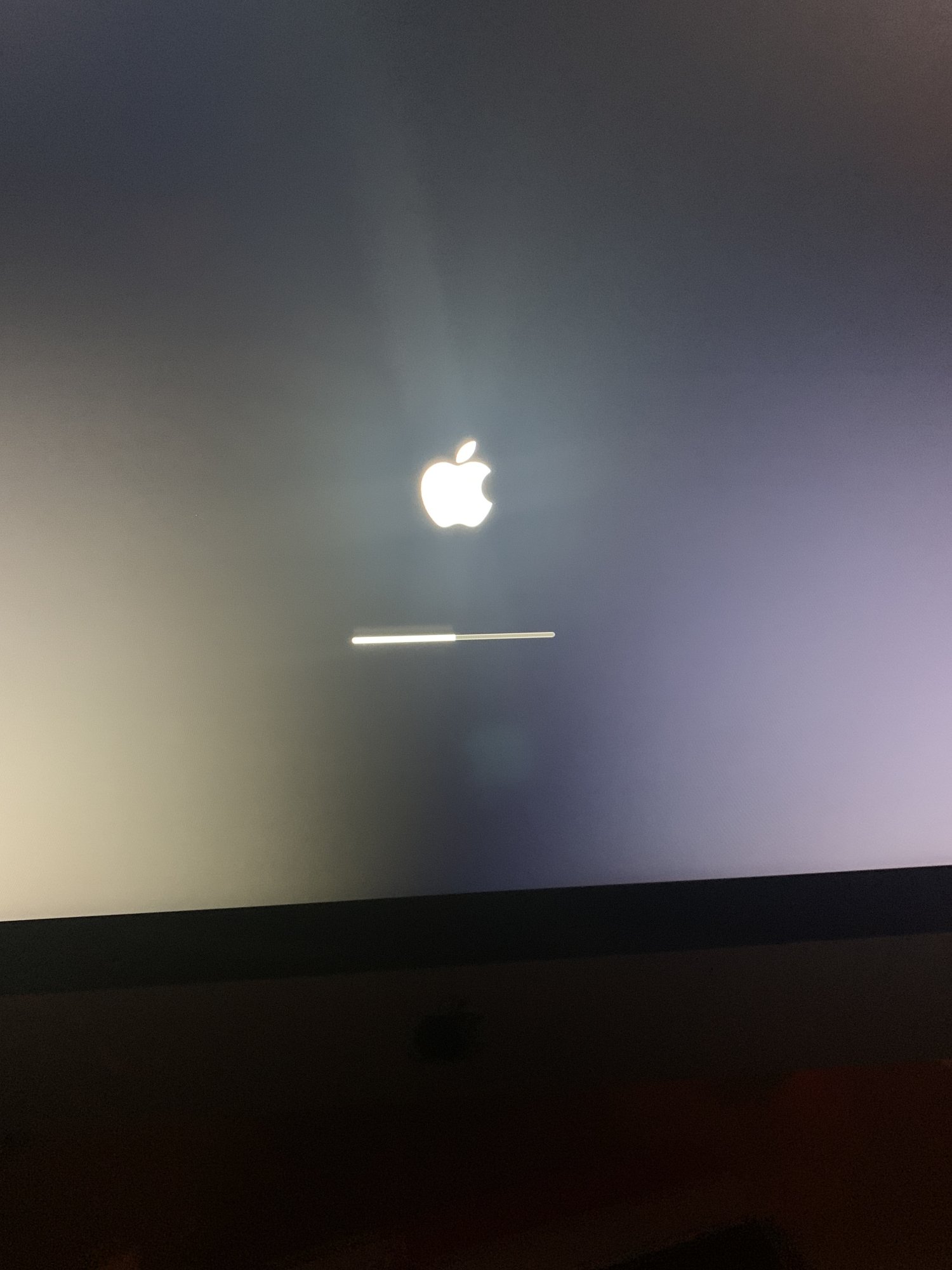

I returned to HS via TM and started now the installation of Big Sur with a fresh OCLP 0.4.11 Install (the version which worked three month again fine on the exactly same imac 12.1).
I am now stuck in a half filled boot bar with the apple logo after installation.
What should i do?

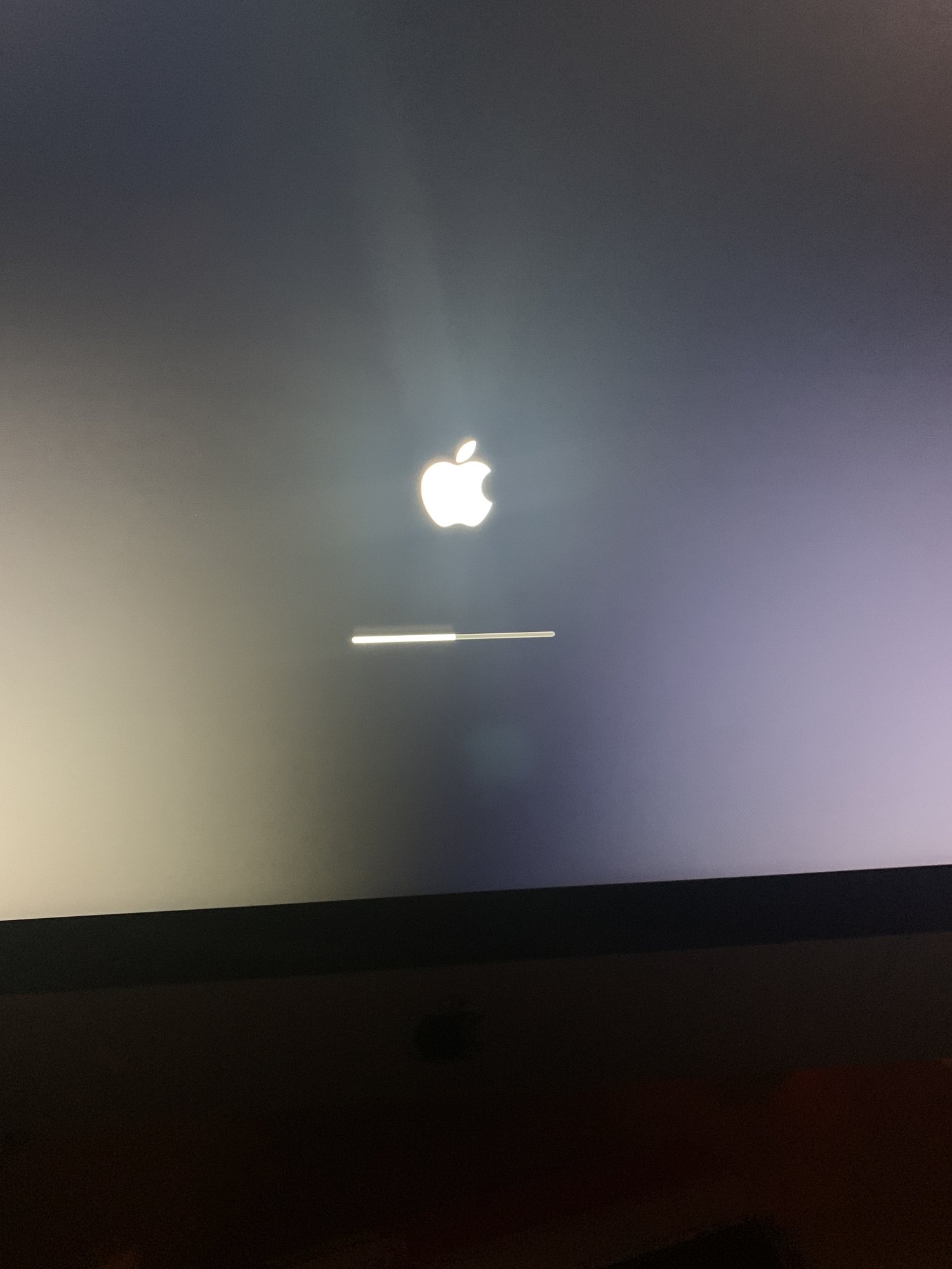

What should i do?

I want to install Big Sur via Oclp over HS again
Then I would wipe the disk, install HS and then start the OCLP procedure from scratch. I have a partition with HS on my MPB9,1, which I use every once in a while to use older apps. Works fine, but obviously there is something wrong with your installation.
