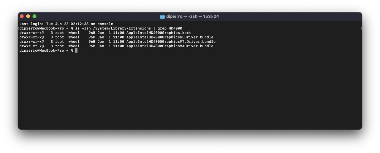

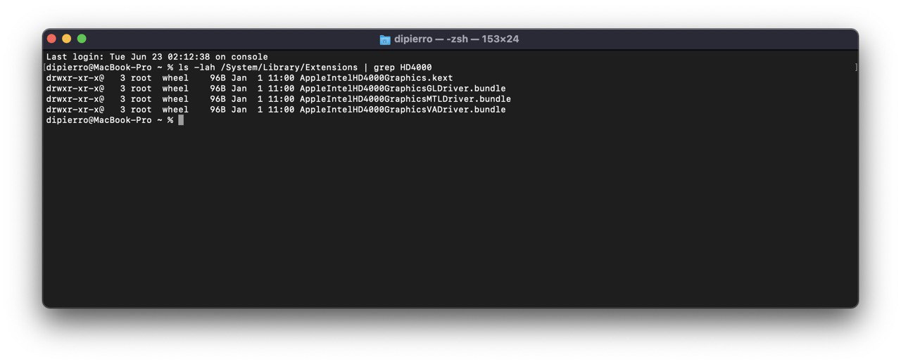

About HD4000: there are HD4000 bundles in the current Big Sur beta, so, any hope for Mac Mini Late 2012?

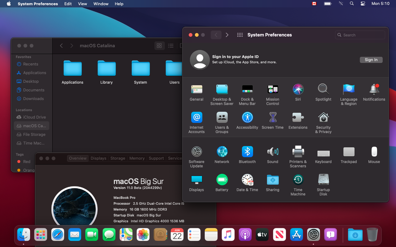

macOS 11.0 beta has acceleration on Mid 2012 13" Macbook Pro, only thing not working is wifi (should be a simple fix)View attachment 926227
so does it work on non-retina 2012 ?

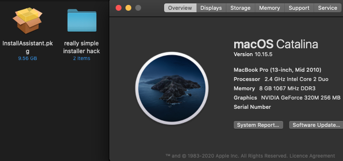

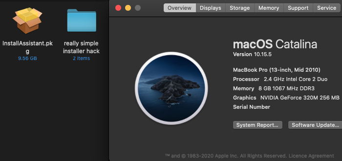

I created a basic patch which seems to get a copy of the OS installed.
My steps (briefly) were:
- Disable Library Validation and SIP
- launchctl setenv DYLD_INSERT_LIBRARIES $PWD/Hax.dylib
- Open and click through the installer app
This is all that's necessary for an "install to this machine" outcome. However, it currently does not boot... will report back if I figure anything out.
For anyone else who only has an unsupported machine and wants to test, here are the files! There are definitely alternatives like using OpenCore, cloning from a supported machine, etc. But thought I'd share this anyways.
There is no AVX requirement!!!
All that is necessary to reach the desktop is installing with my method, then deleting the Telemetry plugin (thanks again @jackluke, that's three years now!) and it boots to the desktop. No accel, of course... that will be the real challenge.
