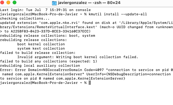

If still doesn't work then try this from a BigSur terminal: kmutil install --update-all
Otherwise you should try to disable FileVault, then do a PRAM reset, and check if Internal Speakers are detected, because BigSur AppleHDA.kext works for any Ivy Bridge Mac.
I have disconnected the HDMI (effectively a monitor) and reboot, but still no option appears for internal speakers. Curiously, the headphones with jack work perfectly.
The Terminal returns an error when writing the code (attached image)
Nice to see it work well everything else thank you thank you thank you

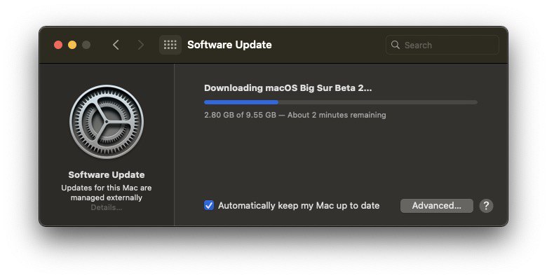

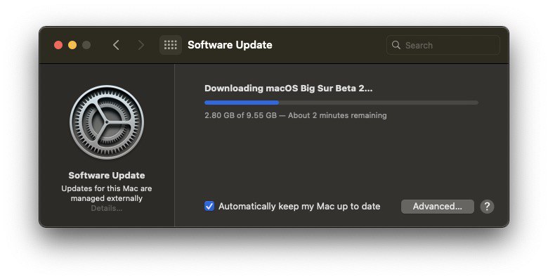

Beta 2 is here. Please let me know how is the update progress.
Thanks ;)

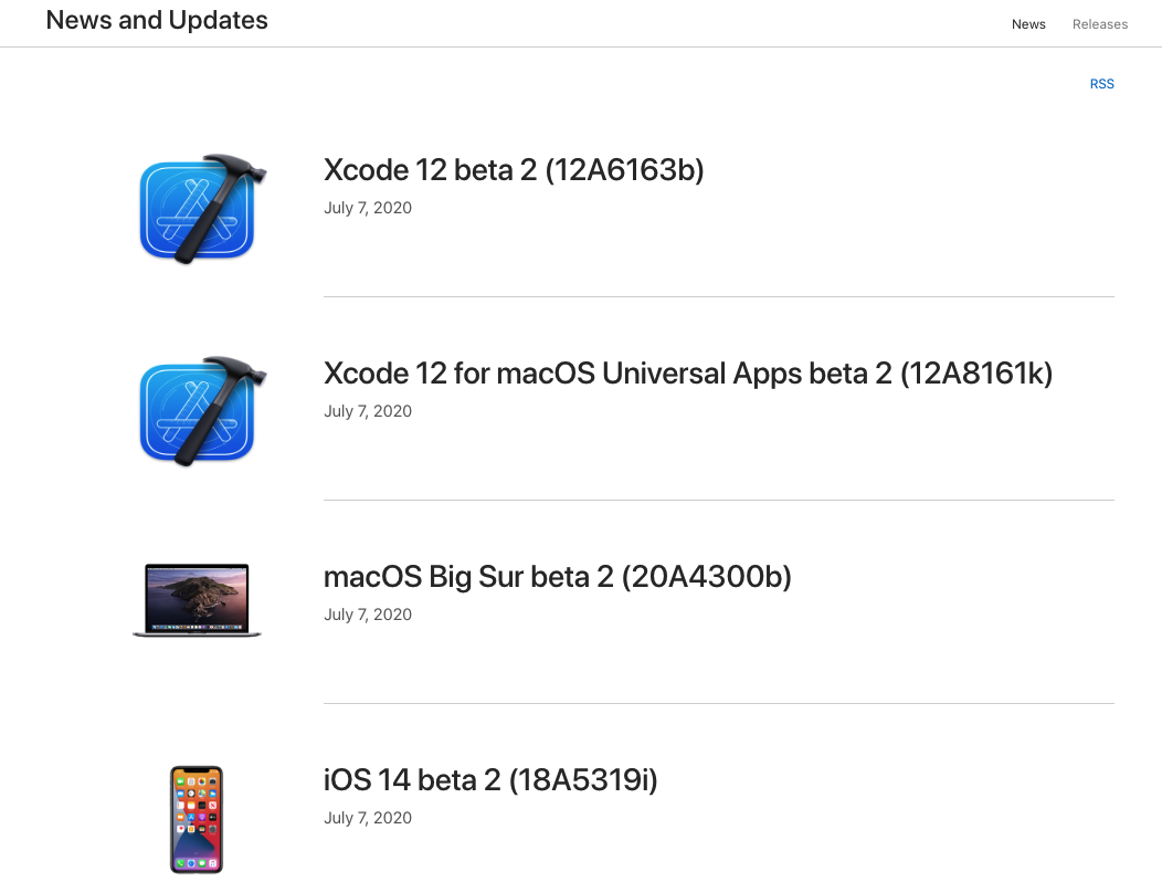

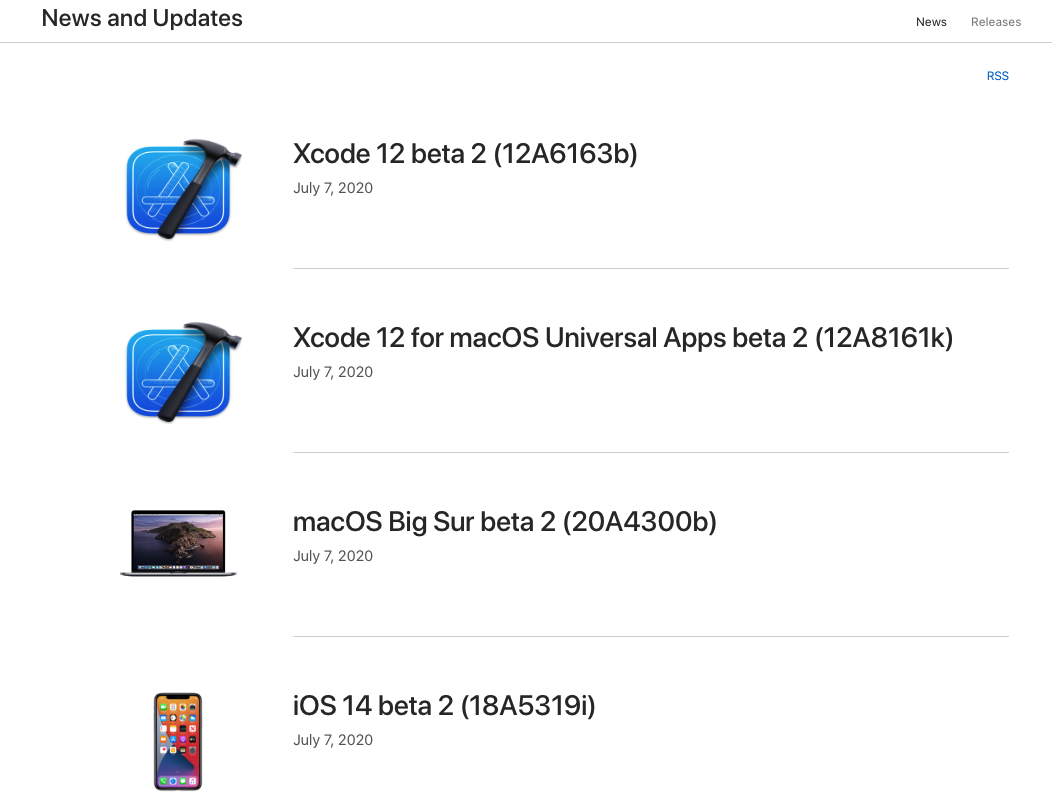

Can anyone capture the link for us like beta1?
[automerge]1594144671[/automerge]
If that is the download size means that apple is still delivering a full installer rather than an OTA update, for Catalina if I don't get wrong they started to deliver after beta 3 an incremental OTA update.
This should be the link: http://swcdn.apple.com/content/down...xje070in5dorjoovnmw61x03/InstallAssistant.pkg
After downloaded and unpackaged check in some Contents/Info.plist that the build number is higher than 20A4299v , because I can't download it for now, have low space on small partitions, and want to keep this BigSur beta 1 unsealed with "mount -uw /" working even from HighSierra.

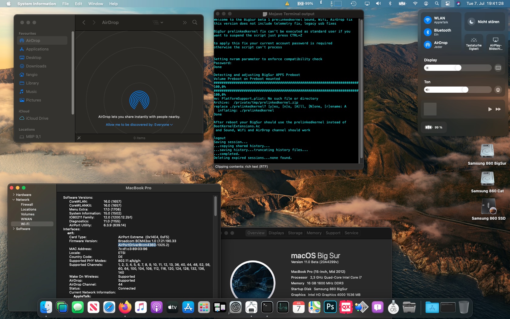

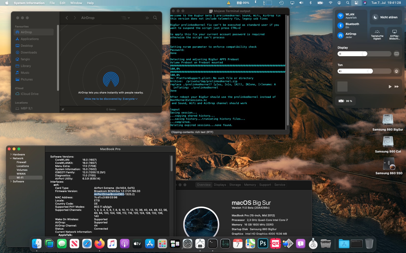

I've executed this 'BigSur IvyBridge prelinkedkernel Sound AirDrop fix beta1.command' in a Mojave Terminal again, booted back to the Big Sur partition and now the AirPortBrcm4360 is used.
