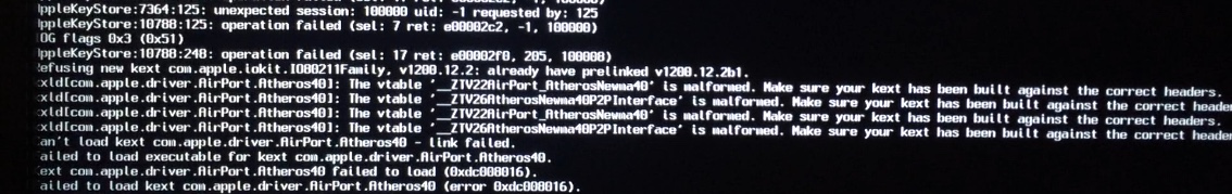

@jackluke please i’ve installed successfully the kext IO80211Family provided by @highvoltage12v , but while the Big Sur was loading it showed this message:
Is there any way to get it working?

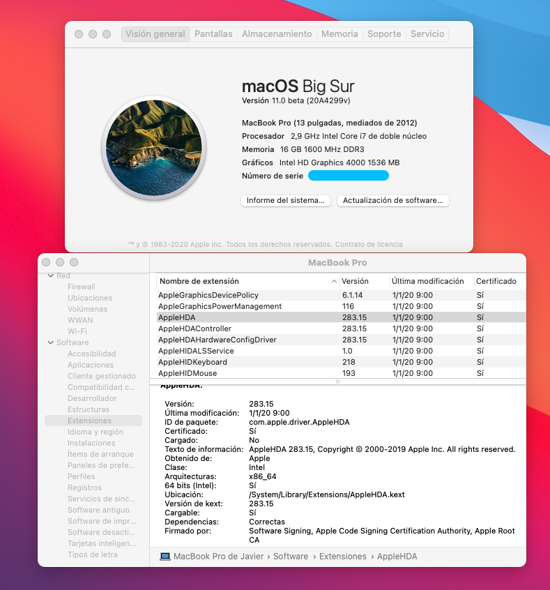

If you select System Profiler from About this Mac and click on the Extensions section, do you see two entries for AppleHDA? If so, the newer version from Big Sur is loading instead of the High Sierra one in the prelinked kernel. I fixed this on my MacPro 3,1 by mounting the root snapshot so that it is writable and deleting that.

Thank you very much @jhowarth, but I only see an entry for AppleHDA ... In any case, the sound from the MBP speakers is not exceptional ;) I fix it with headphones (they do work)
@slears I have not done anything special. I did what @jackluke recommended. I just put my pass in the terminal and pressed the Y key when appropriate ... To discard things, I tell you that I have an SSD and that I had previously installed Catalina oficial in its last update. My MBP is non-retina.
Use this kext: https://forums.macrumors.com/thread...unsupported-macs-thread.2242172/post-28595200
open a BigSur terminal and copy paste one line at once:
Code:
sudo mount -uw / ; killall Finder
open /System/Library/Extensions/
replace (do not merge) the IO80211Family.kext
sudo -s
chmod -R 755 /System/Library/Extensions/
chown -R 0:0 /System/Library/Extensions/
kextcache -i /
(this is required to update the prelinkedkernel)
kmutil install --update-all
(this is required to update the BootKernelExtensions.kc)
kcditto
(this is required to copy both the "kextcache" to the APFS Preboot)

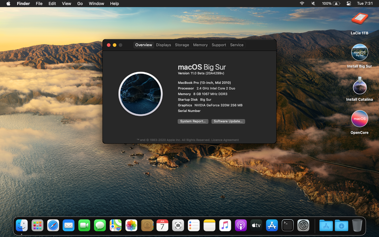

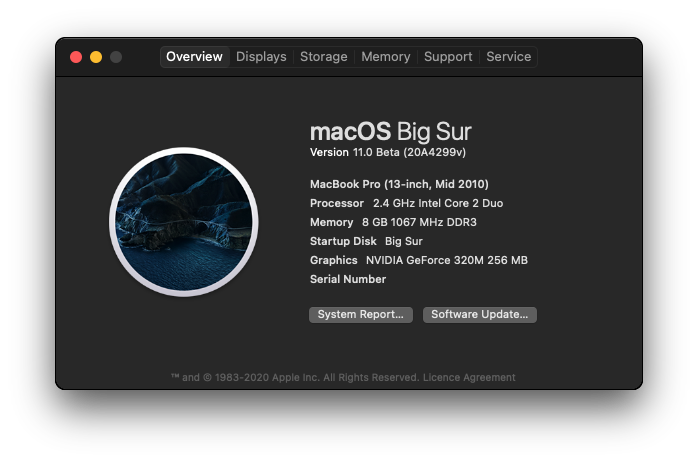

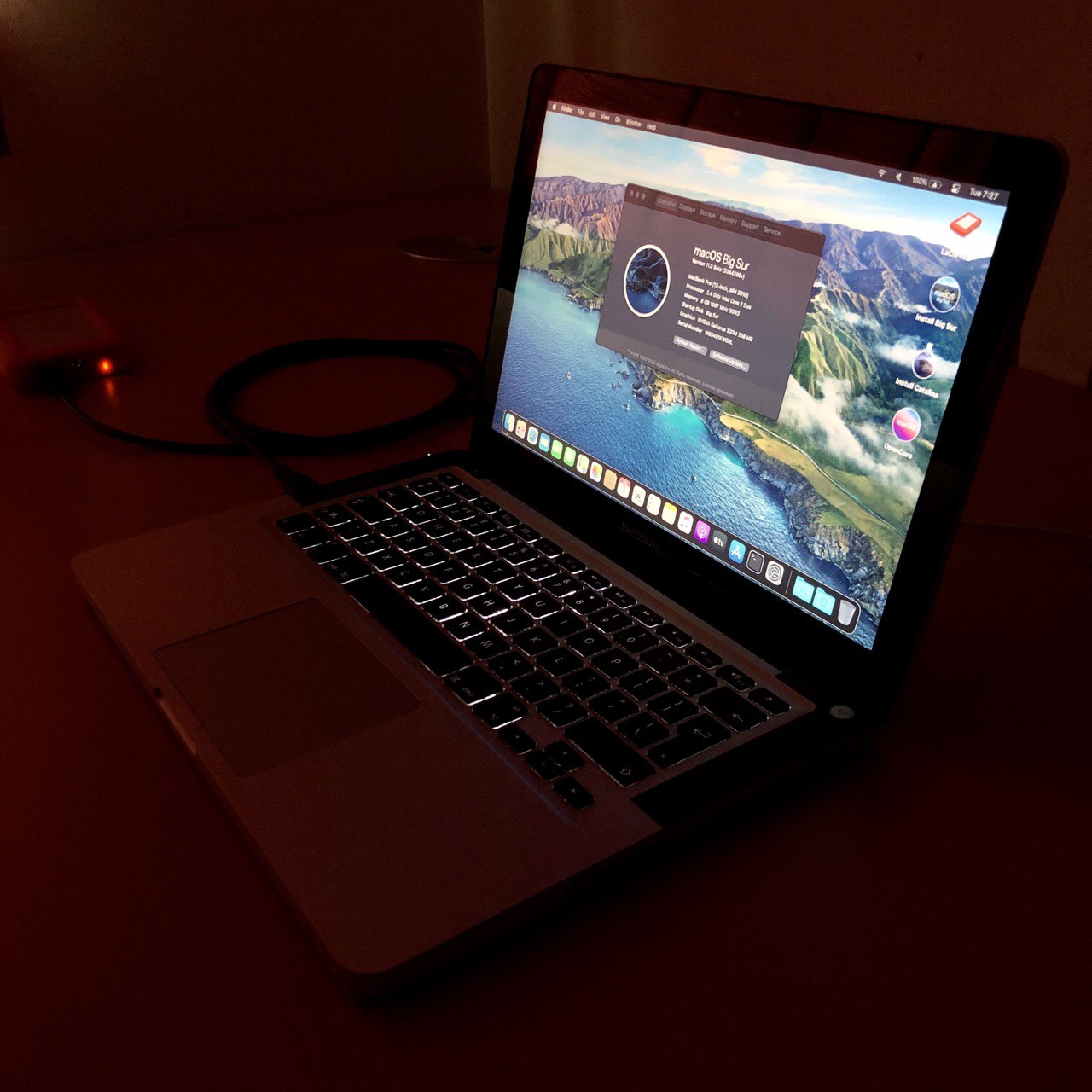

My Big Sur (Beta 1) Installation on MacBook Pro 7,1 (13-inch, Mid 2010)
  1. Create a blank APFS partition using Disk Utility, separate from your Catalina partition
  2. Download InstallAssistant.pkg containing macOS 11.0 Developer Beta 1 (20A4299v)
  3. Run the installer package to place the Install macOS Beta.app at /Applications
  4. Download @ASentientBot's original Hax.dylib and move it to your home folder
    1. Hax 1working mv ~/Downloads/Hax.dylib ~/ or /Users/myHomeFolderName/
      I created a basic patch which seems to get a copy of the OS installed.
      My steps (briefly) were:
      - Disable Library Validation and SIP
      - launchctl setenv DYLD_INSERT_LIBRARIES ~/Hax.dylib
      - Open and click through the installer app
      Edit: I failed to mention that -no_compat_check in NVRAM is also, unsurprisingly, required.
      This is all that's necessary for an "install to this machine" outcome. However, it currently does not boot... will report back if I figure anything out. Working on my 7,1 without acceleration. See my later posts.
      For anyone else who only has an unsupported machine and wants to test, here are the files! There are definitely alternatives like using OpenCore, cloning from a supported machine, etc. But thought I'd share this anyways.
    2. Hax 2 – don't use

I'm currently writing this inside of macOS Big Sur on a MacBookPro8,1! I got Wi-Fi working using jackluke's fixes script and it works perfectly fine. I'm fine without graphics acceleration for now. Thank you for the work you do!

Let me check, I guess I need to update that prelinkedkernel .
I am uploading the new prelinkedkernel for 2012 machines that should fix Wifi and AirDrop channel, after I update my previous post.
edit:
updated also my previous post this should work: BigSur prelinkedkernel Wifi AirDrop fixes.zip
The attached file is only for APFS firmware machines: Sandy Bridge, Ivy Bridge and maybe also Haswell architecture.
Thank you for this! Thanks to this, I now have WiFi on my mid-2012 Unibody MBP Big Sur installation.

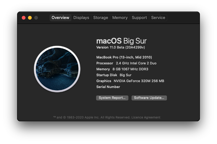

  4. Download @ASentientBot's Hax.dyliband move it to your home folder
    1. mv ~/Downloads/Hax.dylib ~/ or /Users/[I]myHomeFolderName[/I]/
    2. Disable System Integrity Protection (SIP) via csrutil disable in recovery terminal
  5. Disable Library Validation
    1. sudo defaults write /Library/Preferences/com.apple.security.libraryvalidation.plist DisableLibraryValidation -bool true”
  6. Inject the Haxdynamic library file to force the Big Sur installation without error
    1. launchctl setenv DYLD_INSERT_LIBRARIES ~/Hax.dylib
    2. Failure to complete this step will result in The operation could not be completed (BIErrorDomain Error 3)
  7. Run the macOS Beta installer app and choose your blank partition for installation
    1. Your computer will restart several times. The grey Apple logo may turn white.
    2. You will eventually reach a grey circle-backlash symbol. Return to Catalina.
  8. Add these NVRAM boot arguments in Terminal
    1. sudo nvram boot-args="-no_compat_check amfi_get_out_of_my_way=1"
  9. Create a bootable USB installer for Big Sur using a suitable external drive
    1. sudo ~/Downloads/Install\ macOS\ Beta.app/Contents/Resources/createinstallmedia --volume /Volumes/MyVolume
    2. Visit Apple's page on the createinstallmedia command for more information
  10. Edit the boot properties list of your Big Sur USB installer
    1. /Volumes/Install\ macOS\ Beta/Library/Preferences/SystemConfiguration/com.apple.Boot.plist
      XML:
      <?xml version="1.0" encoding="UTF-8"?><!DOCTYPE plist PUBLIC "-//Apple//DTD PLIST 1.0//EN" "http://www.apple.com/DTDs/PropertyList-1.0.dtd">
      <plist version="1.0">
      <dict>
      <key>Kernel Flags</key>
      <string>root-dmg=file:///BaseSystem/BaseSystem.dmg -no_compat_check cs_enforcement_disable=1 cs_debug=1 amfi_allow_any_signature=1 amfi_get_out_of_my_way=1</string>
      </dict>
      </plist>
    2. Restart your computer and hold the ⌥ Option key to boot into your external Big Sur installer
  11. If you have a Penryn Core 2 DuoCPU, you will need to delete the Telemetry plugin to prevent kernel panic
    1. Mount the system volume as writable via the recovery Terminal
      1. Use diskutil list to find the Big Sur system volume
      2. Mount the system volume diskutil mount diskXsY
      3. Remount as read-write mount -uw "/Volumes/Big Sur"
    2. Find & delete the Telemetry plugin
      1. Change directory cd /Volumes/Big\ Sur/System/Library/UserEventplugins
      2. Remove it rm -r com.apple.telemetry.plugin
        1. Or rename it mv com.apple.telemetry.plugin com.apple.telemetry.plugin2
      3. Return to Catalina
  12. Edit the Boot property lists in Big Sur's Preboot volume
    1. Use diskutil list to find the Preboot volume that Big Sur uses
    2. Mount the Preboot volume diskutil mount diskXsY
    3. Edit these two com.apple.Boot.plist files
      1. /Volumes/Preboot/UUID-BigSurData/Library/SystemConfiguration/com.apple.Boot.plist
      2. /Volumes/Preboot/UUID-BigSurData/Library/Preferences/SystemConfiguration/com.apple.Boot.plist
        XML:
        <dict>
        <key>Kernel Cache</key>
        <string>System\Library\PrelinkedKernels\prelinkedkernel</string>
        <string>-no_compat_check amfi_get_out_of_my_way=1</string>
        </dict>
        </plist>
      3. Copy the same plist to a third location /Volumes/Preboot/UUID-BigSurData/System/Library/CoreServices/
  13. Create another external USB partition with USBOpenCoreAPFSloader3.app
    1. OpenCore boot loader will dynamically block the Telemetry plugin being copied or reused from snapshot booting, but it needs to load the prelinkedkernel (not BootKernelExtensions.kc) in order to utilise the telemetrap.kext
    2. Once created, reboot and hold the ⌥ Option key to select the unique EFI icon. Choose Big Sur in the OpenCore boot menu.
  14. Setup your Mac as normal
    1. If your Mac crashes at the Choose Your Language prompt, it may indicate that the Telemetry plugin has loaded. OpenCore should prevent this however
    2. Your Wi-Fi card & internal audio devices will likely not be detected. Proceed patiently through the setup, as the lack of graphics acceleration will make things much slower to start off
  15. Fix the Wi-Fi
    1. Use @jackluke's script to copy his ready-made prelinkedkernel file into your Big Sur Preboot volumeThe prelinkedkernel fix4 beta1 script can even be executed in your Catalina partition (or Mojave, High Sierra)
  16. Internal audio devices (Speakers & Microphone)
  17. Graphics acceleration (NVIDIA GeForce 320M 256 MB)
Source: Rewrote my long-winded method in post #796 to be more clear and concise.
All credits go to @jackluke and @ASentientBot for not only their hard work in creating patches and scripts, but for taking the time to answer people's queries – and essentially fix their problems. Thank you

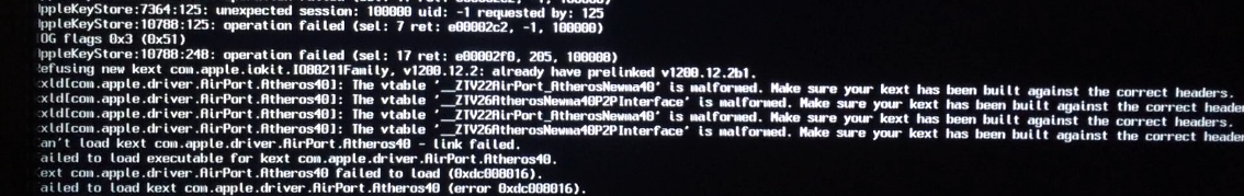

Good morning. I run the BigSur prelinkedkernel fix4 on my MBP 8.2 and wifi is running ok.
Not working sound, airport, menubar clock photos crashing, Maps showing only a black screen. Are there any fixes for these, especially the sound?
For AirDrop on that machine you need the Catalina AirDrop patches, but currently I can't include it because I need generalised prelinkedkernel, menubar clock is a common beta1 issue, photos crashing is a Metal issue.
For fixing sound try this method: https://forums.macrumors.com/thread...unsupported-macs-thread.2242172/post-28646141

You can use my prelinkedkernel fix even on a sealed BigSur Volume, but before try this, boot from an USB BigSur Installer or its macOS Recovery with CMD+R , from Recovery open terminal and type:
Code:
mount -uw /
nvram boot-args="-no_compat_check"
csrutil disable
csrutil authenticated-root disable
reboot
then from BigSur normal booting try my script "BigSur prelinkedkernel AirDrop fix2 beta1" that should work.
Or if you have another macOS (with APFS support) boot from there and use this: "BigSur prelinkedkernel AirDrop fix beta1".
After reboot it worked perfectly !!!! WiFi and AirDrop.
