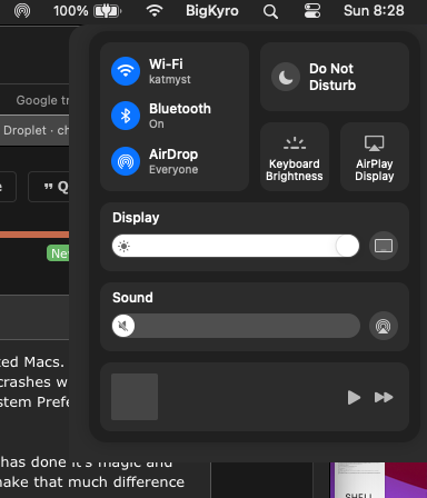

Menu Bar clock is definitely a software bug. Any click on it logs you out, and the Date & Time preferences for the Menu Bar clock are all greyed out. Beta 2 will probably fix it

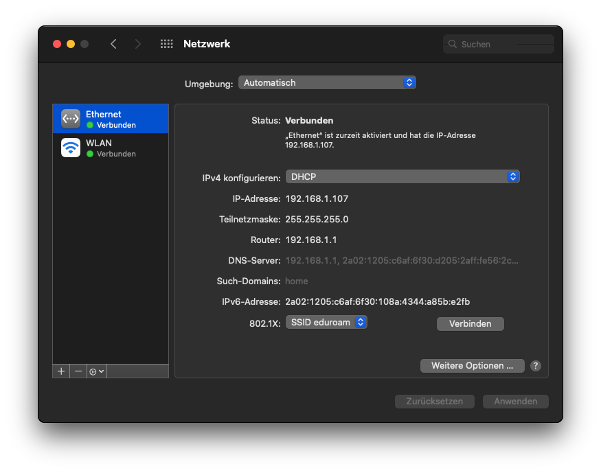

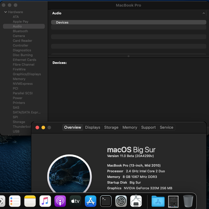

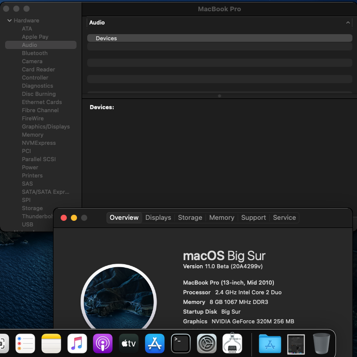

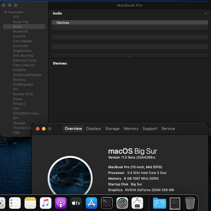

Success with prelinkedkernel fix4 beta1 also here on MBP5,2: Ethernet works now!
Internal audio not yet, I'll follow your advice to remove AppleHDA.kext.
Thanks jackluke!
I removed AppleHDA.kext, but unfortunately no audio devices detected.

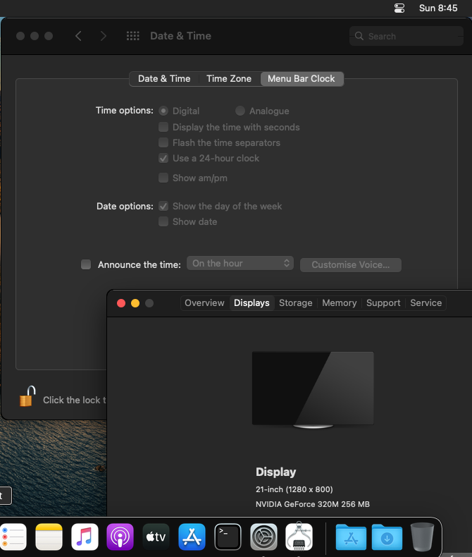

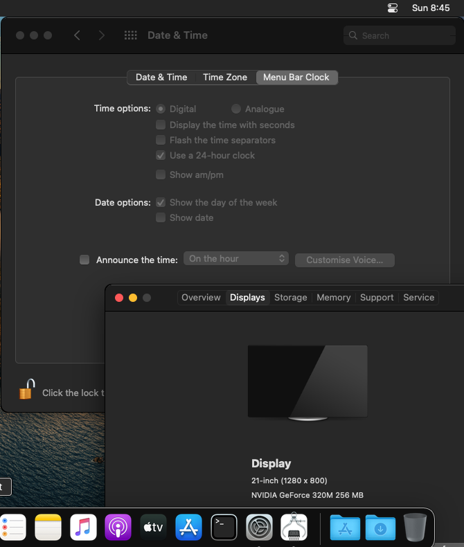

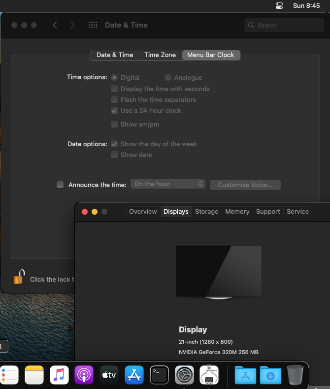

I wonder if other people can't change their Menu Bar Clock preferences either (and if they click it, does it log them out too). And I also About This Mac shows I have a 21-inch display…rather than 13.3 inch.

Menu bar clock is a common BigSur beta issue, the 21 inch display is because there are not yet Nvidia GeForce Tesla drivers installed for Framebuffer video, but ASentientBot already tested them and worked.

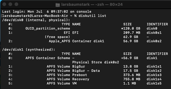

Side question (only loosely related to the migration): How can I get rid of the "free space" that does not map to any container any more after my migration of user settings from Cat to BS? I´d like to reclaim it and add it to the container disk1...
Neither GUI disk util nor terminal use of it do the trick. Any suggestions here?
