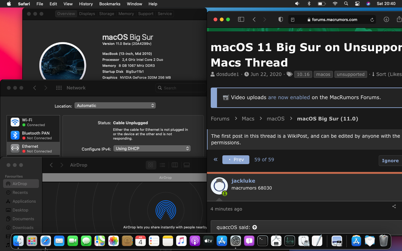

Try this new prelinkedkernel that should fix for MacBook7,1 Wifi AirDrop and Ethernet (credit to ASentientBot for ethernet fix on Nvidia based Mac):
MacBook7,1 BigSur prelinkedkernel Wifi AirDrop and Ethernet fix beta1
replaced it here: /Volumes/UUID-BigSur/Preboot/System/Library/PrelinkedKernels/

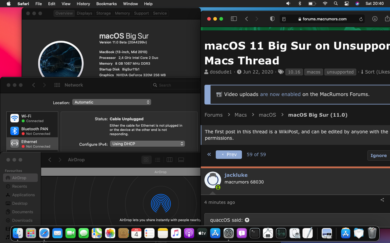

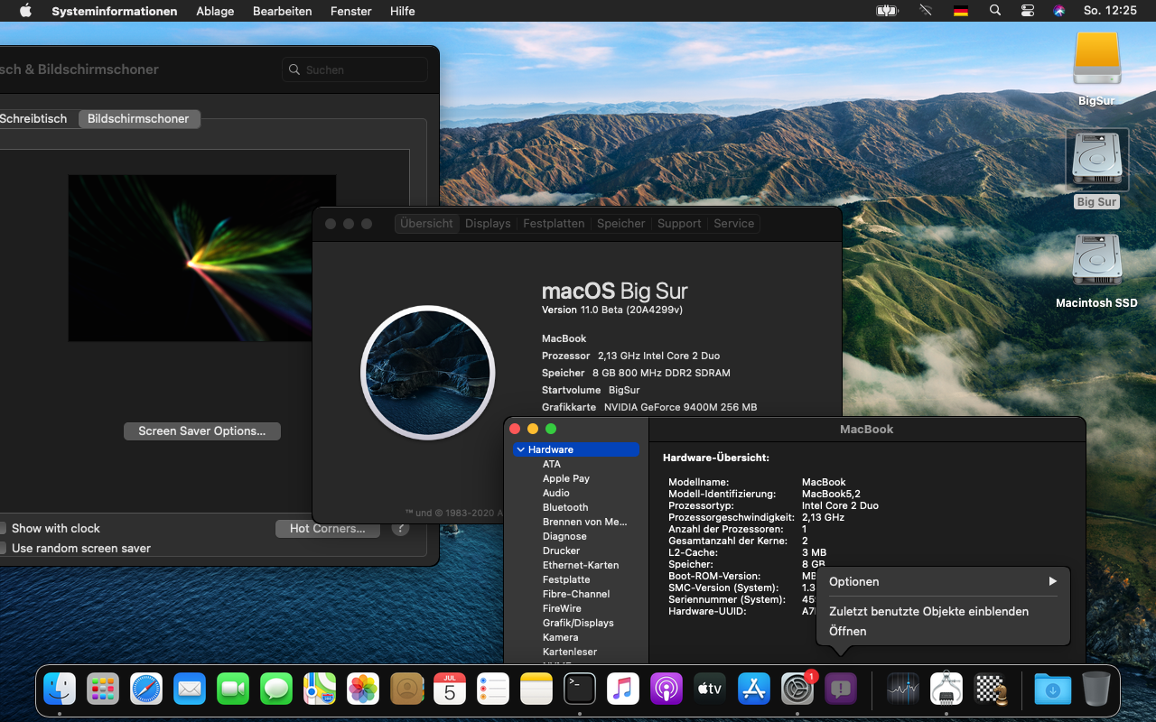

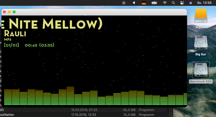

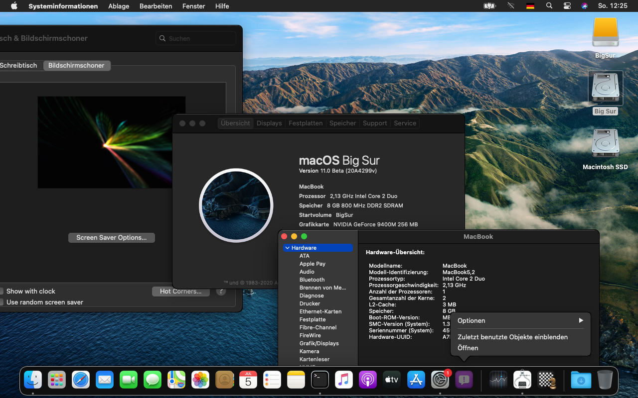

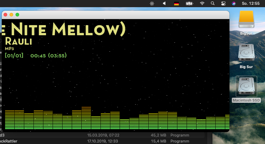

Success on MB5,2 (or: as good as it can get atm)
Used @jackluke ´s method to switch to prelinked kernel boot, used his USB prelinked kernel first to boot.
Had some trouble initially due to kexts copied over from MB4,1 (IOSerialFamily etc.), so ended up with working USB but crashing near login...
In an attempt of not accepting the defeat, I booted into safe mode and that worked! Rebooted again (safemode, but single user to mount -rw)
Then corrected all kexts, copied over the specially patched MB5,2 (trackpad and some other) kexts from a working Catalina volume
and ran kextcache -i / and kcditto.
Result now: Fully working Wifi, trackpad (scrolling and fast mouse works) and audio output, 256MB framebuffer recognized for the 9400M.
Additional findings: Sound output to homepod works and brightness slider app also still runs on BS.
Here´s the link to my prelinked kernel for this machine / setup for anyone interested.
For fixing Wifi on your MB4,1 I guess you need a very legacy IO80211Family.kext (the one embedded in my prelinkedkernel is from Mojave 10.14.5 ), same applies for AppleHDA.kext (the one I embedded is from 10.13.6 ) and IOUSB, I guess you need also very legacy IOUSB kext (that I don't included).
For any Nvidia chipset Mac if you use this ASentientBot method: https://forums.macrumors.com/threads/macos-10-15-catalina-on-unsupported-macs.2183772/post-27468713
Ethernet works also on a BigSur unsupported non-metal, non-APFS, legacy usb mac, I attach my working kext from highsierra install.

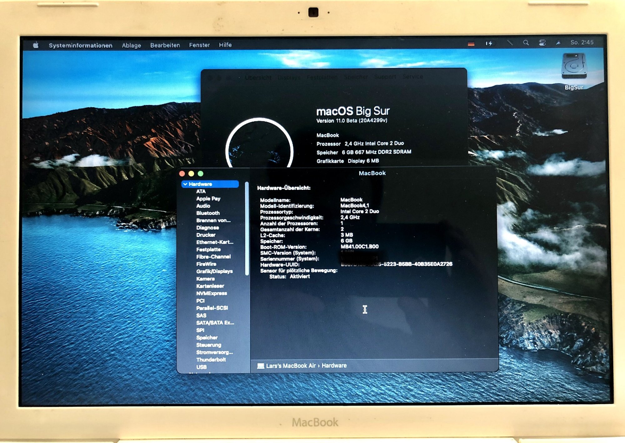

Speaking of MB4,1:
First signs of Big Sur life...
(ignore the MBAir name in the status bar)
edit:
Got the framebuffer working for the x3100 GPU now, 144MB shared mem.
Smoother mouse movement and screen rendering!
edit2:
Wifi also up & running.
edit3:
Audio working now with HDA version 2.1.7
Don't know if this was just a problem that I had on my system or it was a general 'bug' on our unsupported Macs. If I clicked on any of the icons on the top right hand corner of the menu bar ( battery , wifi , notifications Siri ....it still crashes when I click on time though ) it would crash my system and take me back to sign in screen. I fixed this by going into System Preferences - Accessibility - and then setting reduce transparency and setting Menu Bar to large.

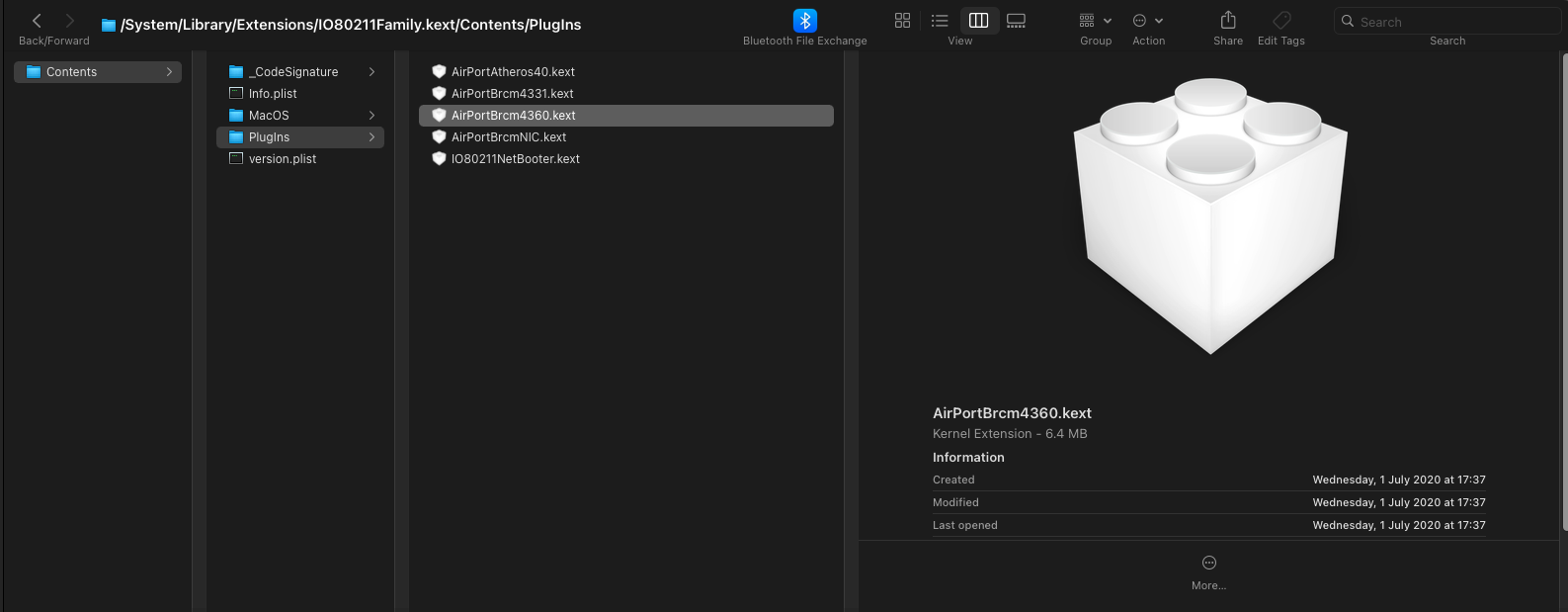

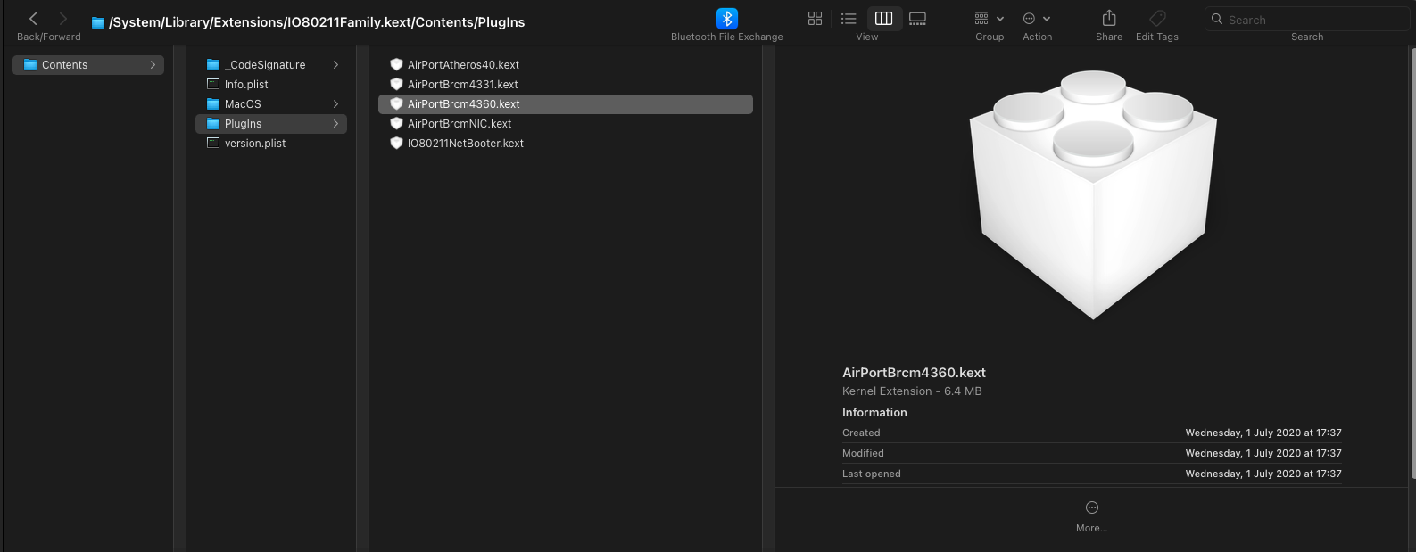

Here is my IO80211Family kext version 12.0 if you wan to try it. Of course I'm using an Atheros card at the moment, all my MBPs have been upgraded to the BCM94360 from @troop231 i'll try a Mac mini once I get ahold of one.
