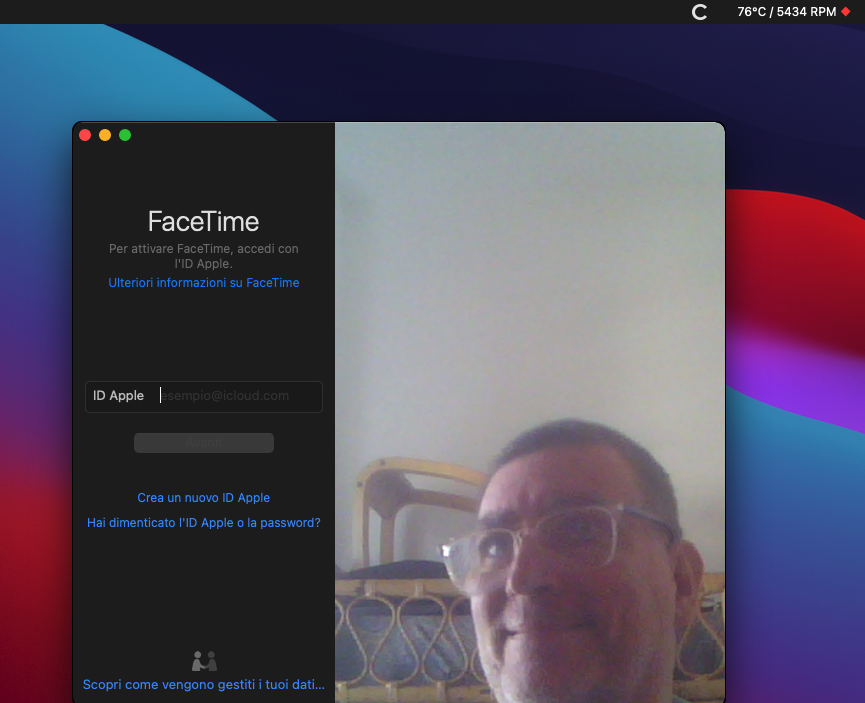

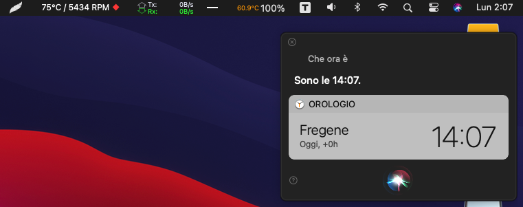

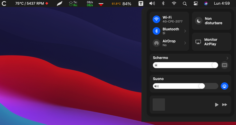

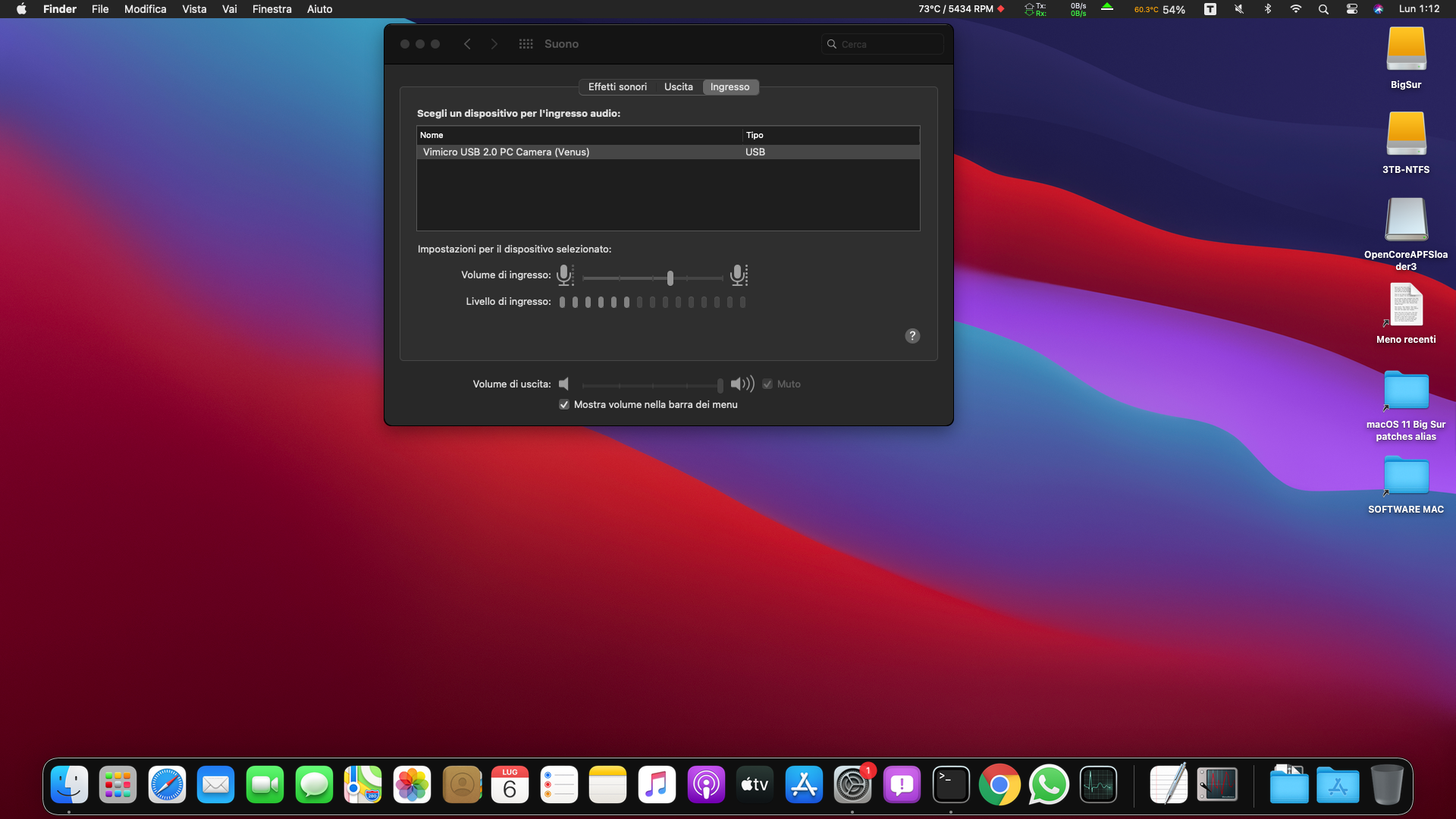

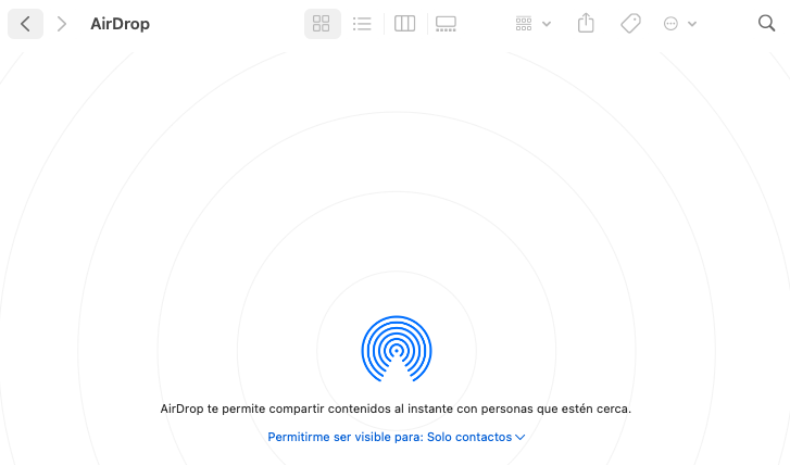

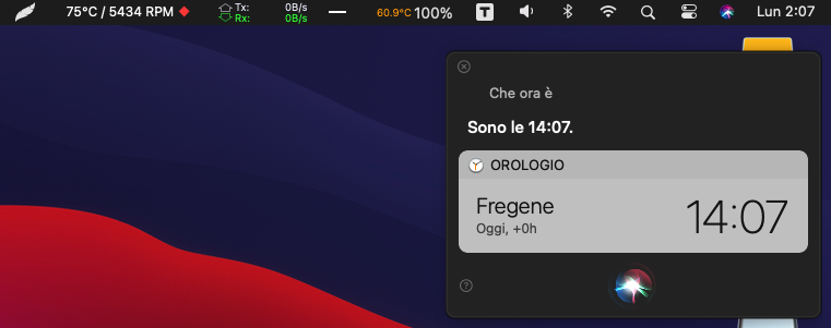

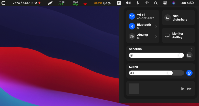

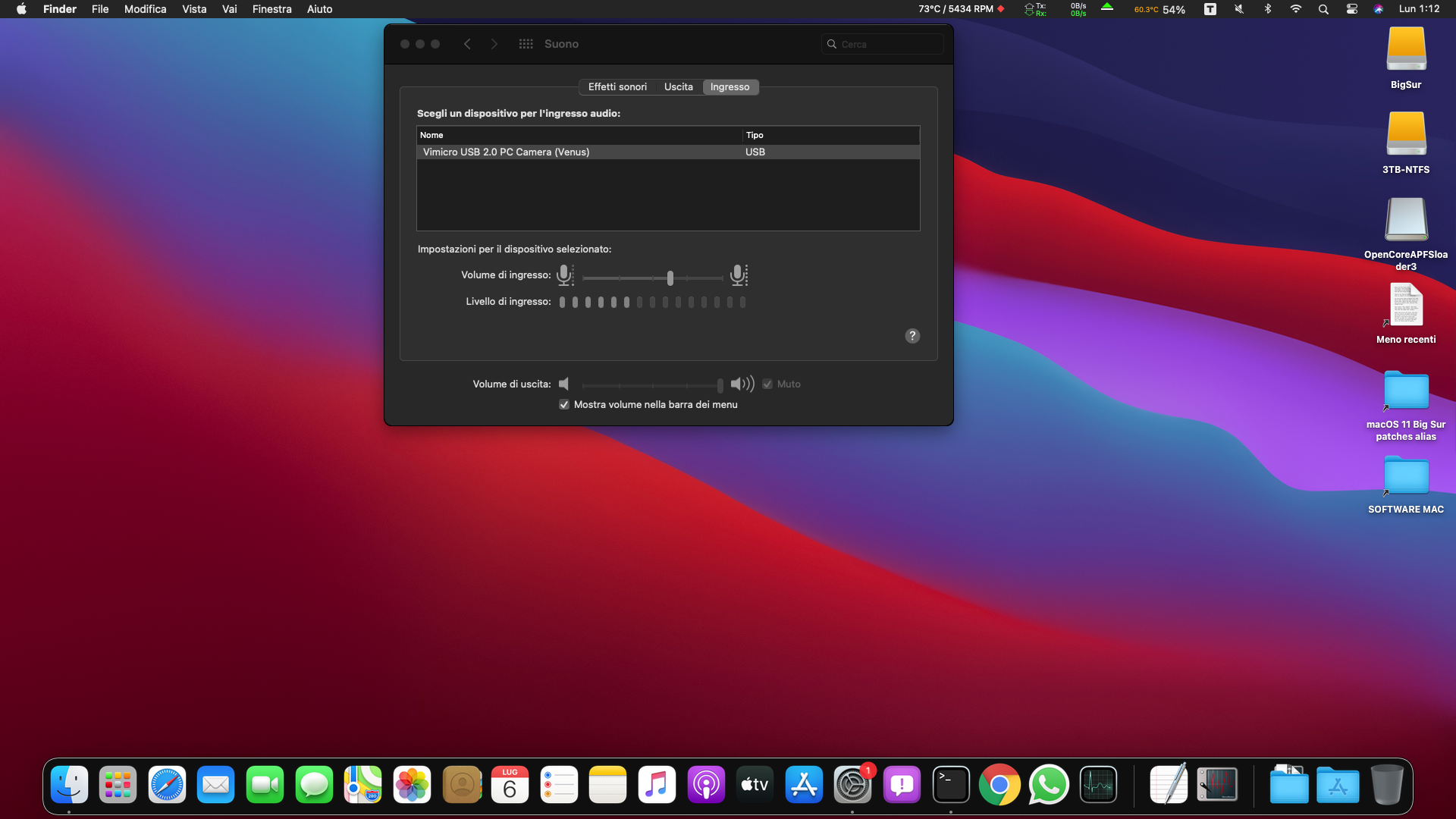

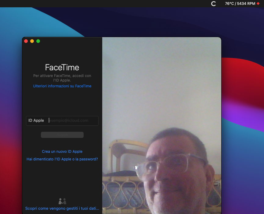

Installed patcher 4 beta 1. All OK. I haven't an ethernet cable but the functionality seems present. WIFI, Audio Bluetooth and USB webcam, mic, keyboard and mouse work... I can also use SIRI. Top right icons on menu bar fixed with the reduce transsparency trick. Only acceleration misses.

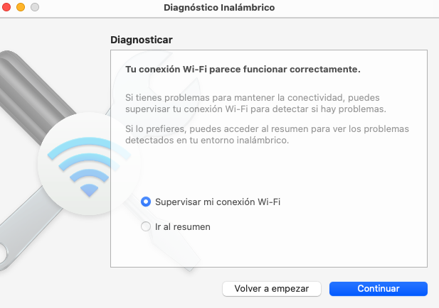

I guess it's just a simply preferences plist that should refresh after, try from a BigSur terminal:
open /System/Library/CoreServices/Applications/Wireless\ Diagnostics.app
That should detect your Wifi network and refresh some preferences plist, then at next reboot you should have Wifi with AirDrop channel too.

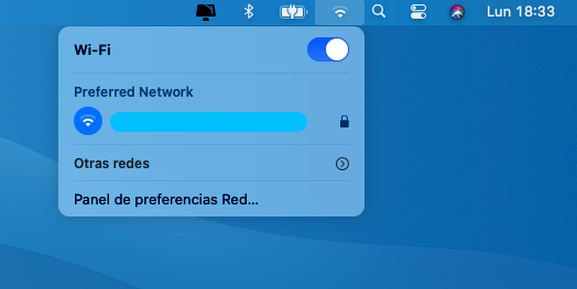

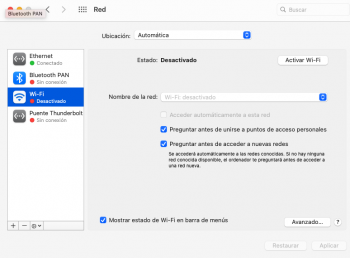

In System Preferences the option and WIFI appears (before it did not appear), but it does not let me activate it.
Let me check, I guess I need to update that prelinkedkernel .
I am uploading the new prelinkedkernel for 2012 machines that should fix Wifi and AirDrop channel, after I update my previous post.
edit:
updated also my previous post this should work: BigSur prelinkedkernel Wifi AirDrop fixes.zip

After reboot it worked perfectly !!!! WiFi and AirDrop.
I still have no sound output from the Mac's speakers, but it's not too bad because it works perfectly with headphones.
Thank you very much for all the work.

By the way, Diagnostic App works now too... all good!

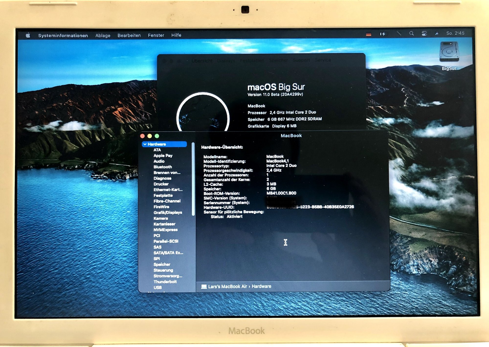

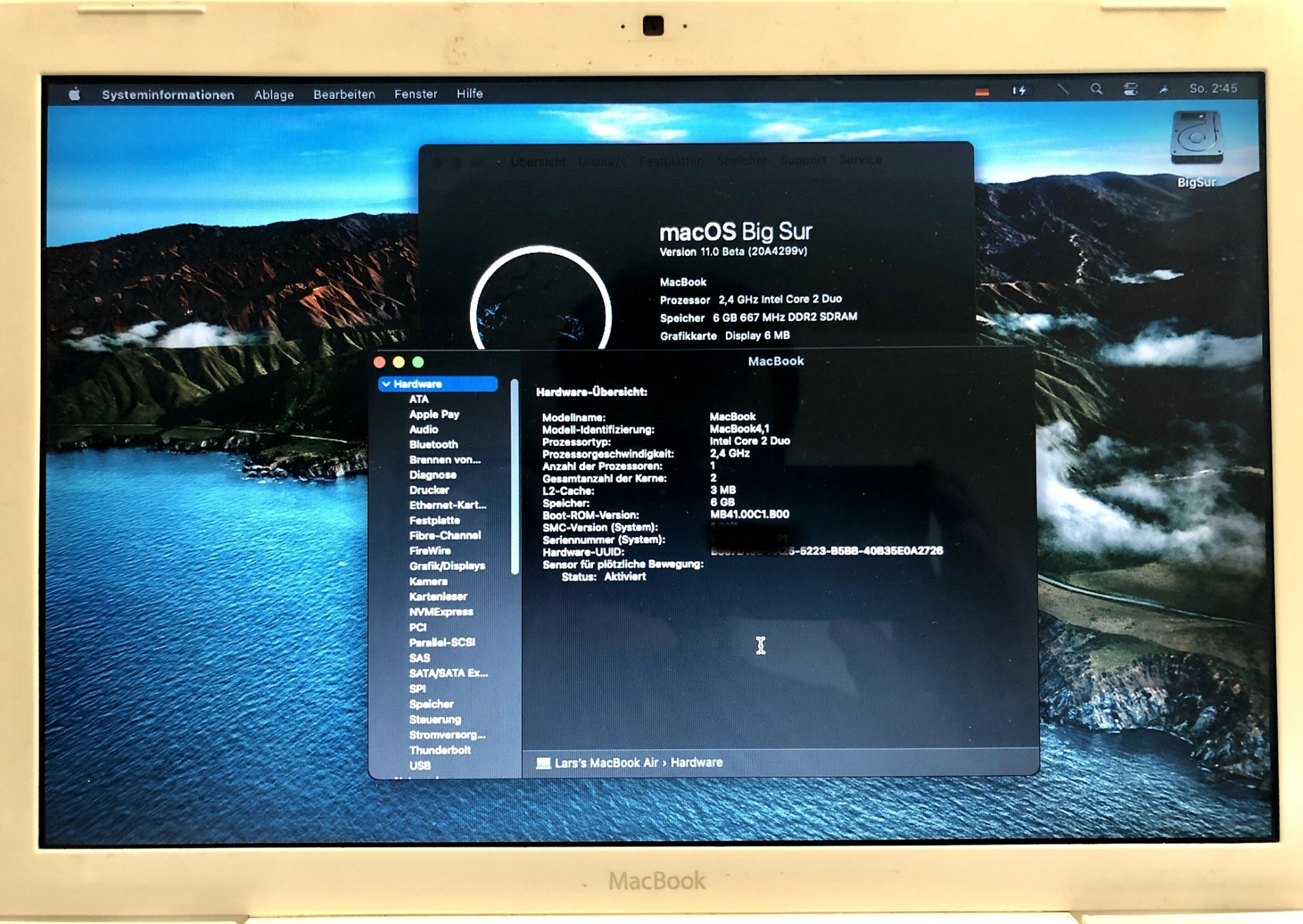

Speaking of MB4,1:
First signs of Big Sur life...
(ignore the MBAir name in the status bar)
edit:
Got the framebuffer working for the x3100 GPU now, 144MB shared mem.
Smoother mouse movement and screen rendering!
edit2:
Wifi also up & running.
edit3:
Audio working now with HDA version 2.1.7
bro, you make a crazy work again!
How you install to MB4,1? I still have machine here can be a tester! :)

Well, easiest way for achieving it:
Prepare installer on a USB stick (as @jackluke and others described) and install to a „supported unsupported“ machine as i.e. the MB5,2 or some more recent C2D MBP.
Then take that drive (or clone it) to be used in the MB4,1.
For getting legacy USB function there,
use the prelinked kernel I prepared for that machine. Also audio and wifi can be brought up by adding/replacing the kexts and the on the running system do kextcache -i /
and kcditto
(both in terminal).
Prerequisite is SIP off and on one of the first boots (in single user mode) set nvram params to „-no_compat_check”, if not already done or installer re-set that.
