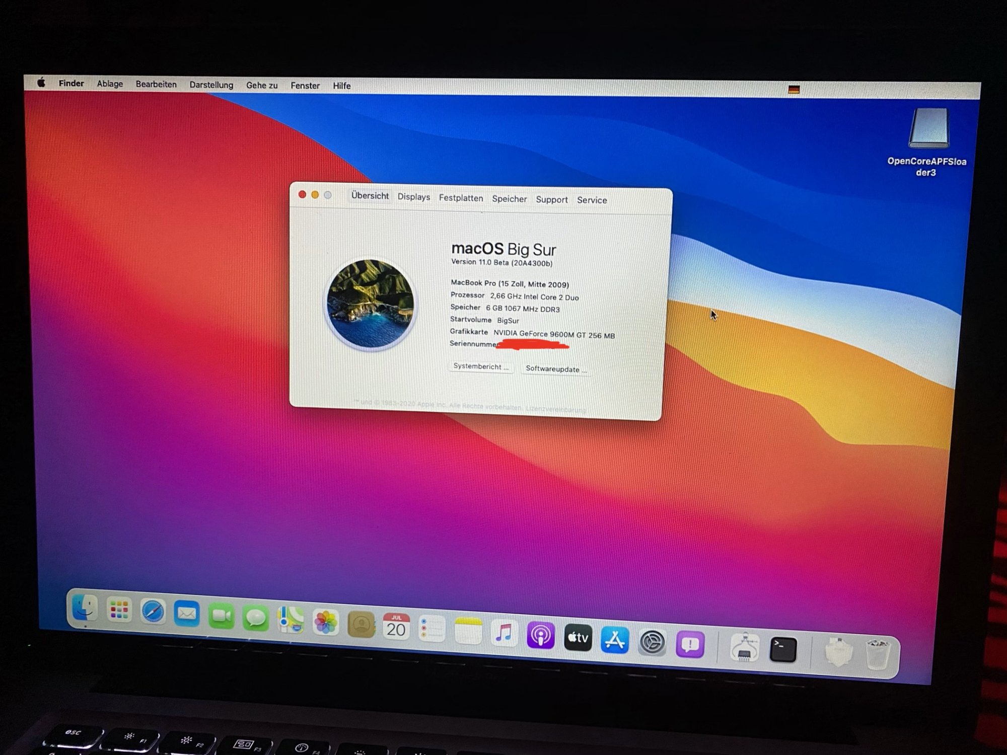

I'm hoping the Wifi solution I've been using since the days of my unsupported Mac Pro 1,1 days and thru 5,1(flashed) will hold true. The Asus AC68 PCI-e adapter card. I'm still having trouble creating an installer that will get into setup. I really want to find out if the my steadfast wifi will stay strong. Once, I get a nibble on Big Sur I'll share any wifi failure or success.
Works out of the box! Installed it after BS b2 was installed.

I now got BS Beta 2 on my 2009 MBP 15“ 2.66GHz running (thanks to all devs and helpers here), or better creeping. Okay, it boots up etc. but as expected some things don’t work. I injected the High Sierra AppleHDA.kext but it doesn’t get loaded. So Sound doesn‘t work onboard (but an external USB sound card works). Also the Nvidia Tesla Kexts which I inserted correctly are shown but not loaded. The Icons/control center in the menu bar on the top causes the UI to crash and pushes me back to the login screen. But everything else works ok. Hope that some devs will fix the Metal Requirement to work on older GPUs and the other errors caused by the unsupported machine. Is anyone working on a Metal fix or something else concerning this? Just to tell: because of the non-loaded kexts also the background light control don’t work. Sorry that this post could maybe annoy somebody but I read the first 63 pages and my head just spins😅 so any further successes?
With many thanks in advance,
theANY
edit: FYI I do boot BS without OpenCore.
