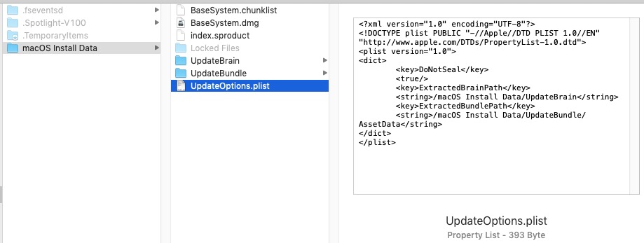

6. set the value "DoNotSeal" to "True" in the UpdateOptions.plist in folder macOS install data
Great find, I will test this on next beta 3, and I am enough sure that your method will work, because apple is not new to use dictionary keys to disable or enable a "macOS Install Data" feature, for example they did a similar thing for HighSierra (and Mojave too):
they used for the USB macOS Installer (stage1 installer):
<key>ConvertToAPFS</key>
<true/>
while for the macOS Install Data (stage2 installer) they used instead:
<key>Do APFS Convert</key>
<true/>

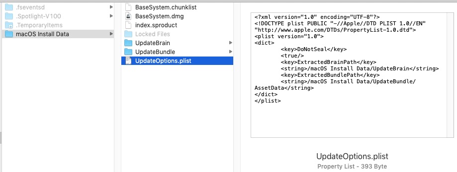

What folder is it in?
See here:
I am going to try now this in Terminal:
/Applications/Install\ macOS\ Big\ Sur\ Beta.app/Contents/Resources/startosinstall --DoNotSeal TRUE
Crossing finger that this works. :)
Epic fail:
unrecognized option `--DoNotSeal'
