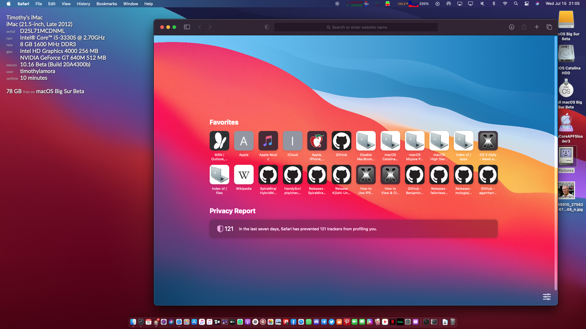

cool feature you can change the background in Safari :)
