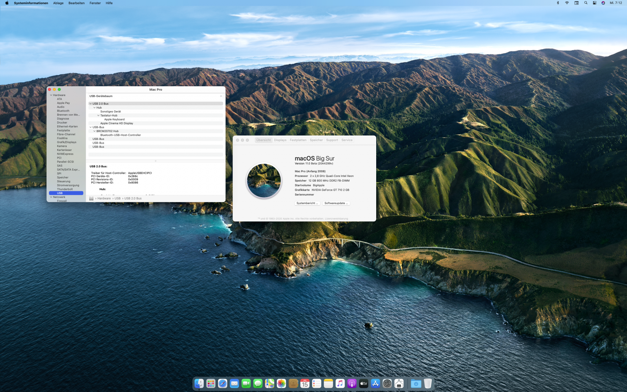

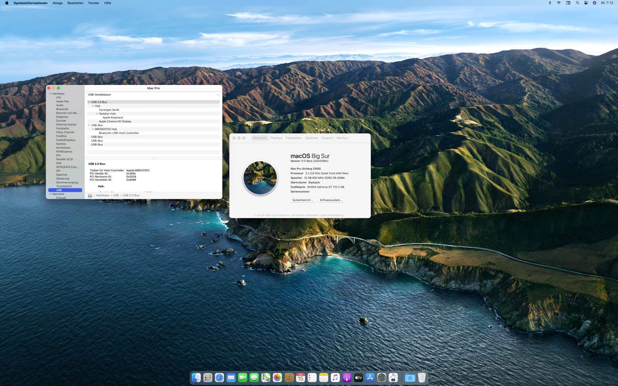

My MacPro3,1 is currently working with BigSur DP1.
WLAN and BT work natively, Magic Maus works as always, BT Audio works
Unfortunately, the old AppleHDA and LegacyUSB are still missing.
currently my way is via SingleUserMode, exit, then... I have a keyboard in BigSur.
Here are a lot of tips. Which way is right now for Sound and LegacyUSB?

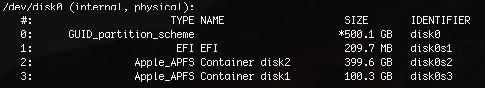

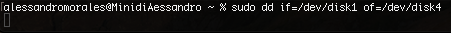

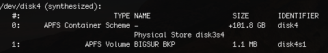

After 3 hours hard disk is still blinking. I have made screenshot to show you what I'm running. i point to APFS containers. Maybe you mean /dev/disk ? Because in the first APFS container there is Cat SSD. I will keep it running overnight, since I can still use mac mini flawlessy

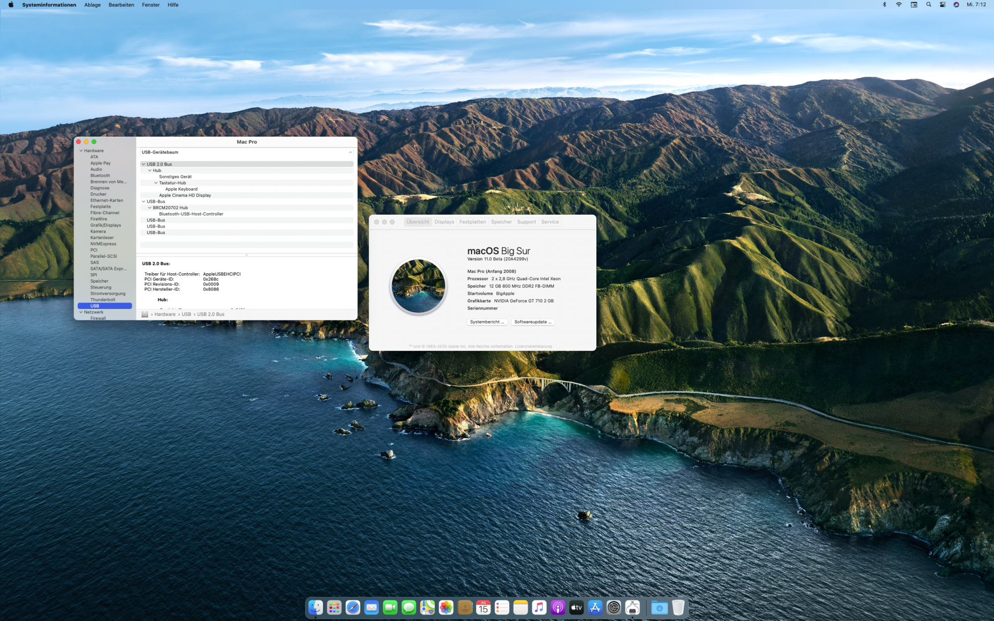

DD is bit by bit cloning, there is no better option in my opinion, it should copy 100% of the disk.
I am positive you do it right, you are copying the whole disk, not partitions, that's the way to go.
I rechecked, you do it wrong, copy the whole disk, not the APFS container.
It's a 500 GB disk, you need a target disk of at least 500 GB
To be more precise, all partitions on the source disk have to be copied, reason, there are partitions on the disk which are needed, without them your clone is not bootable.
