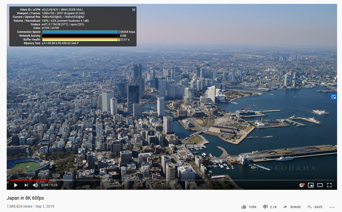

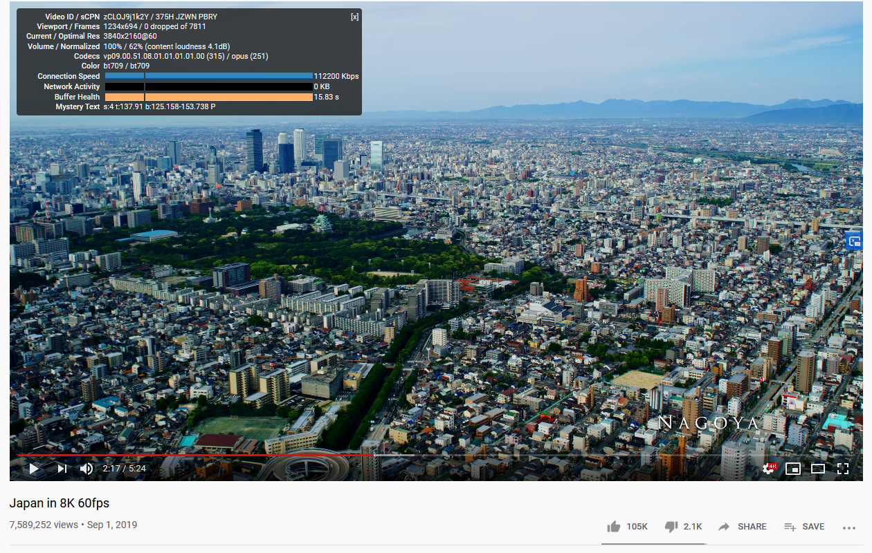

Very funny but the same video decodes with VP9 in regular Firefox:
And in Av1 in Firefox nightly:
And of course it does not play well in Nightly. It drops frames like hell.
Edit: Nightly plays that video with Higher resolution as well.

What content you get is entirely chosen by YouTube, they have decided to start serving AV1 unconditionally for Firefox 81 users wherever AV1 is available.

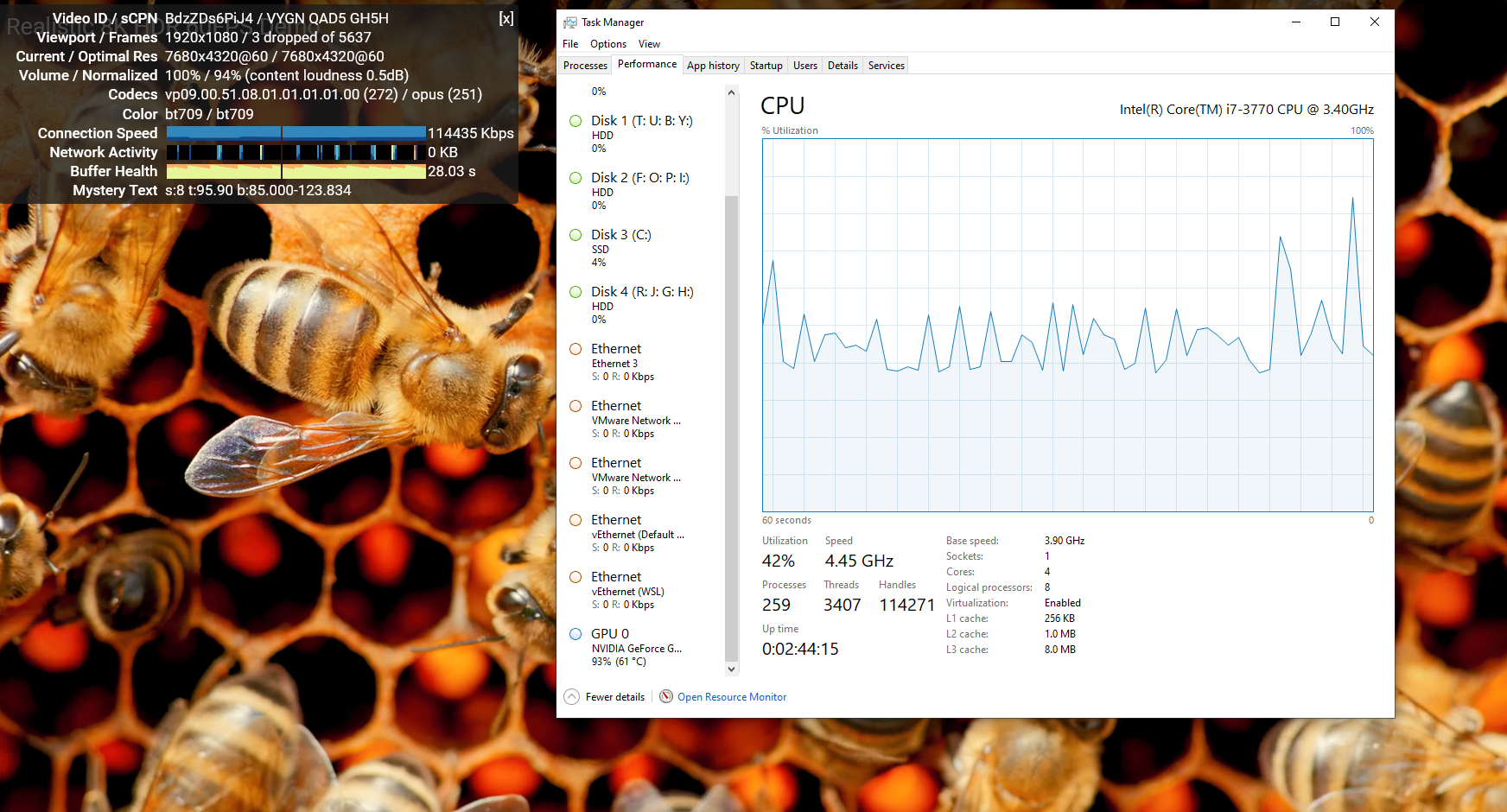

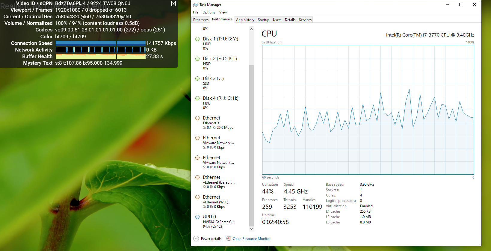

Core i7-3770?!???!?!?? Is this a hackintosh, and if so, which GPU?
an i7-3770 is a 2012 CPU and doesn't have VP9 decoding capabilities, only 7th gen and later.
I'm actually amazed it could do 8K VP9 with 0 frame drop, certainly unexpected. I would have rated this type of video as unplayable on such hardware
I am very confused now. I don't understand how this is even possible, unless somehow his GPU is being leveraged.
