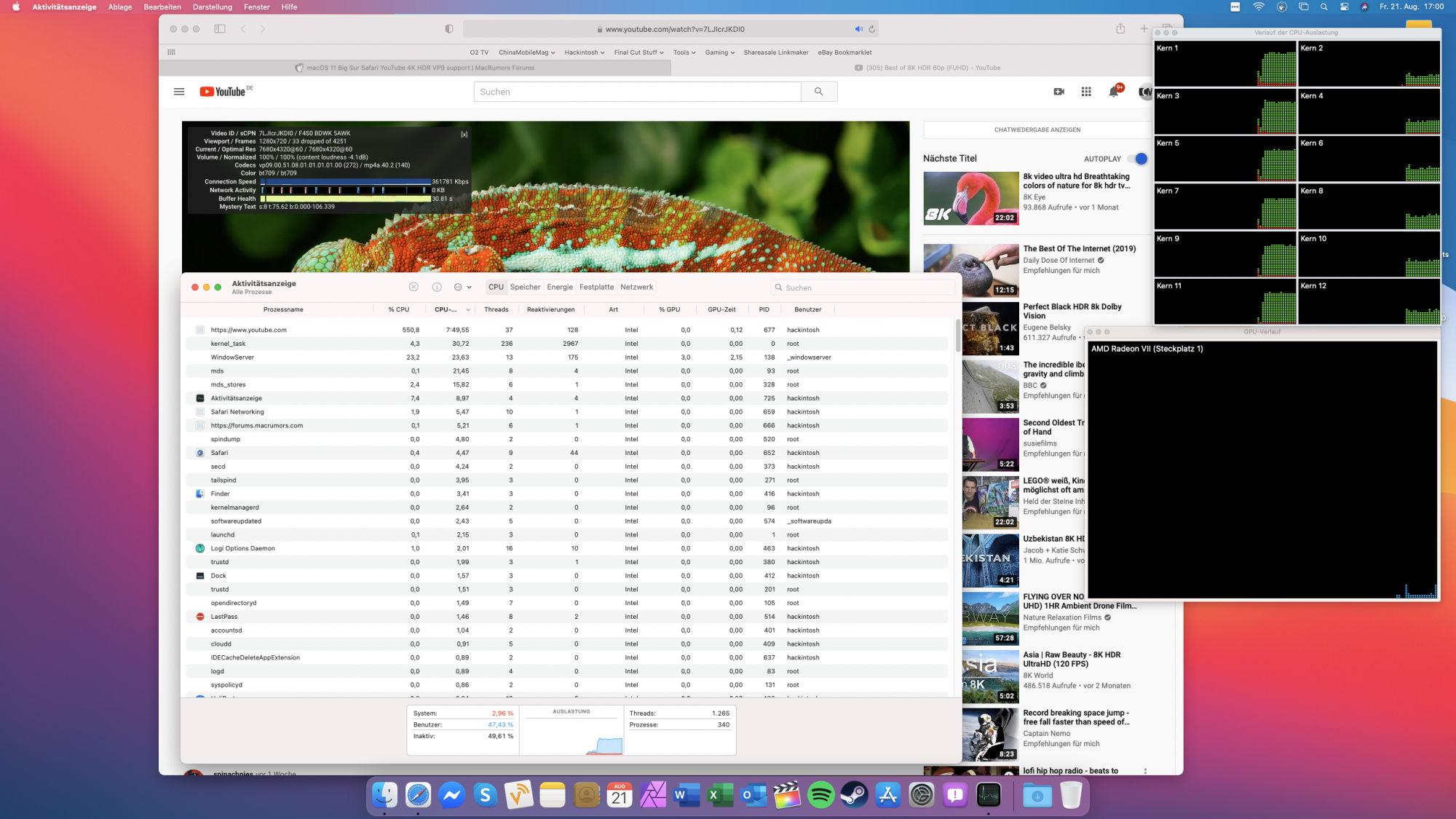

On my Hackintosh with Radeon VII 8k plays absolutely smooth in Beta 5.
Thanks for confirming. Mine is 5700 XT. Video was incredibly jerky and the GPU became very loud. The video I played was the Best of 8K video on the previous page.

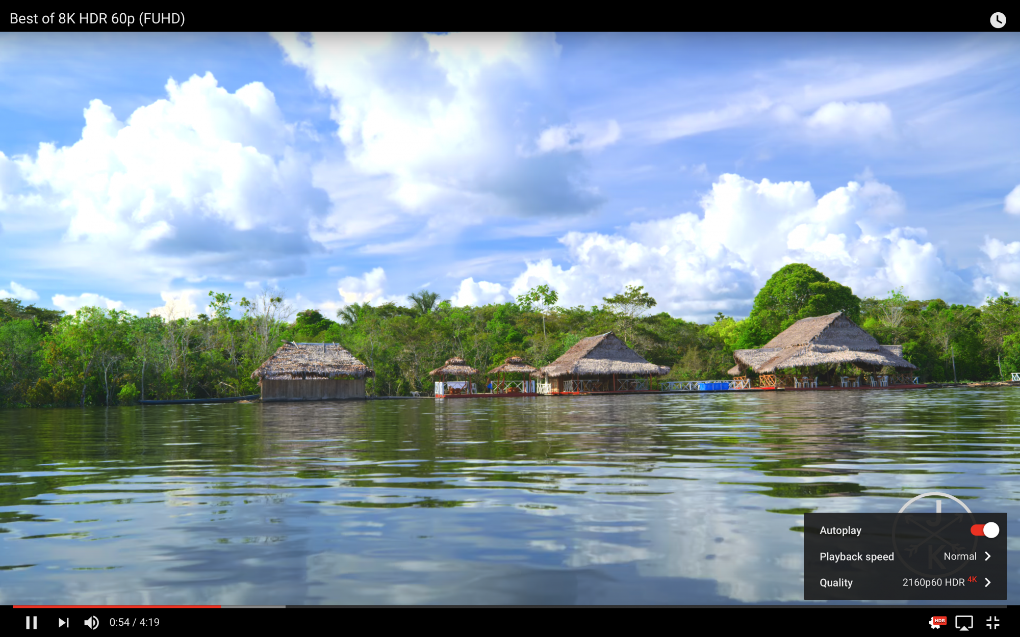

Hm, I find that interesting. If I try to play this
I get the 8k option, and you have much better laptop than me, so should you. What version of Safari do you run? Mine is 16610.1.23.1.3

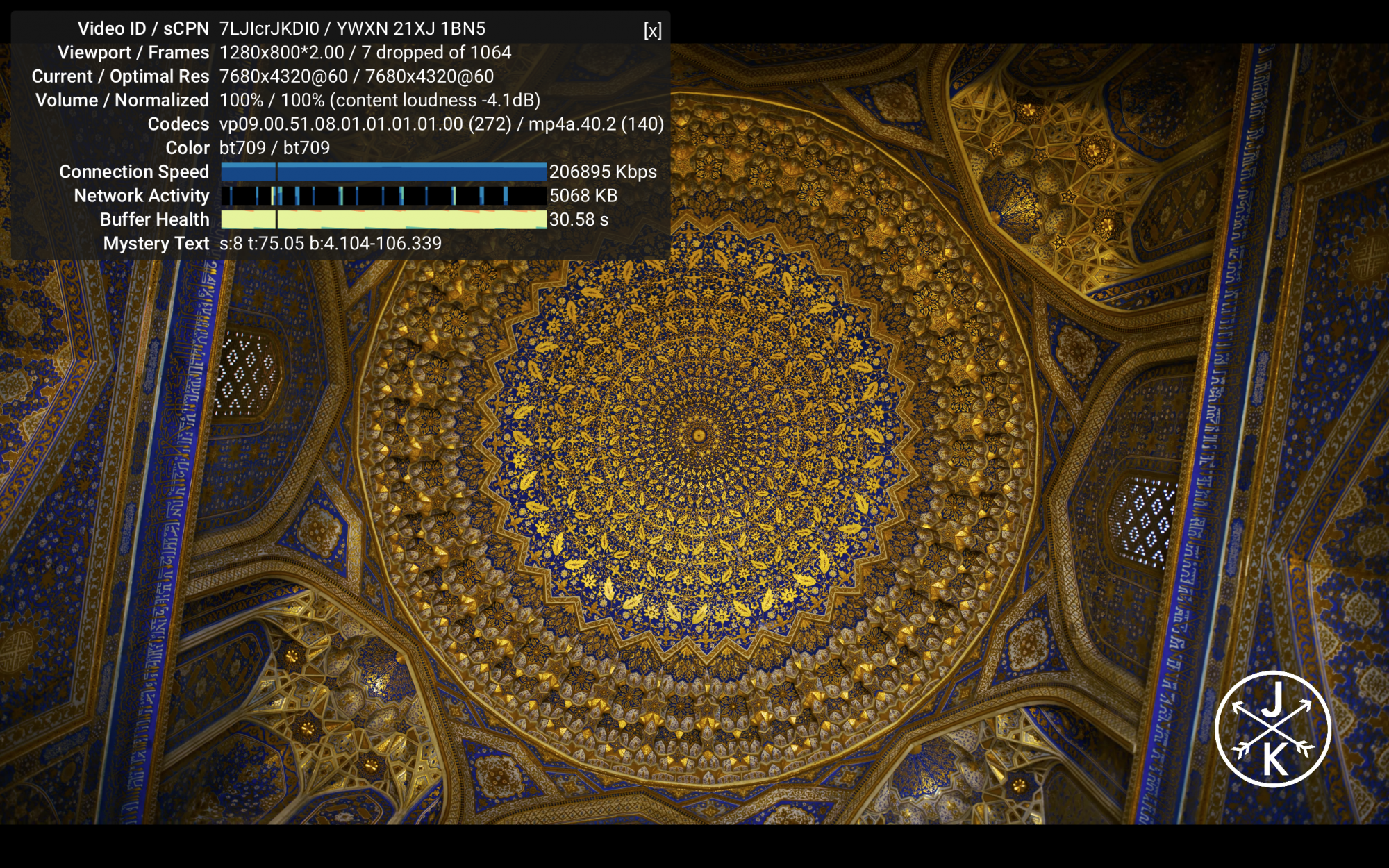

For for that 8K video in Safari Big Sur Beta 5:
On my 2017 27" iMac Core i5-7600 quad-core (no HT) with Intel HD Graphics 630 at 1.15 GHz and Radeon Pro 575, I get no HDR options, but it goes all the way up to 8K.
4K non-HDR playback is perfectly smooth, with about 15-25% overall CPU usage.
8K non-HDR playback is a slideshow, but with only about 5-10% overall CPU usage (probably because not much is actually playing).
On my 2017 12" MacBook Core m3-7Y32 dual-core (HT) with Intel HD Graphics 615 at 900 MHz (?), it's similar. Again I get no HDR options, but it goes all the way up to 8K.
4K non-HDR playback is perfectly smooth, with about 20-30% overall CPU usage.
8K non-HDR playback is a slideshow, but with only about 10-20% overall CPU usage (probably because not much is actually playing).
I guess both are running off Intel graphics, with similar results. 8K is simply too much for their dedicated decoder hardware, which is not surprising since these iGPUs are specifically designed to support up to 4K. In the specs, both Intel iGPUs support a maximum resolution of 4Kp60, although technically it's 2304p60 on the iMac and 2160p60 on the MacBook.

@ArPe Just put my RX 5700 XT inside my Hackintosh and tested the Peru 8k video. Doesn't look like there is any GPU acceleration going on. GPU fans remain silent.

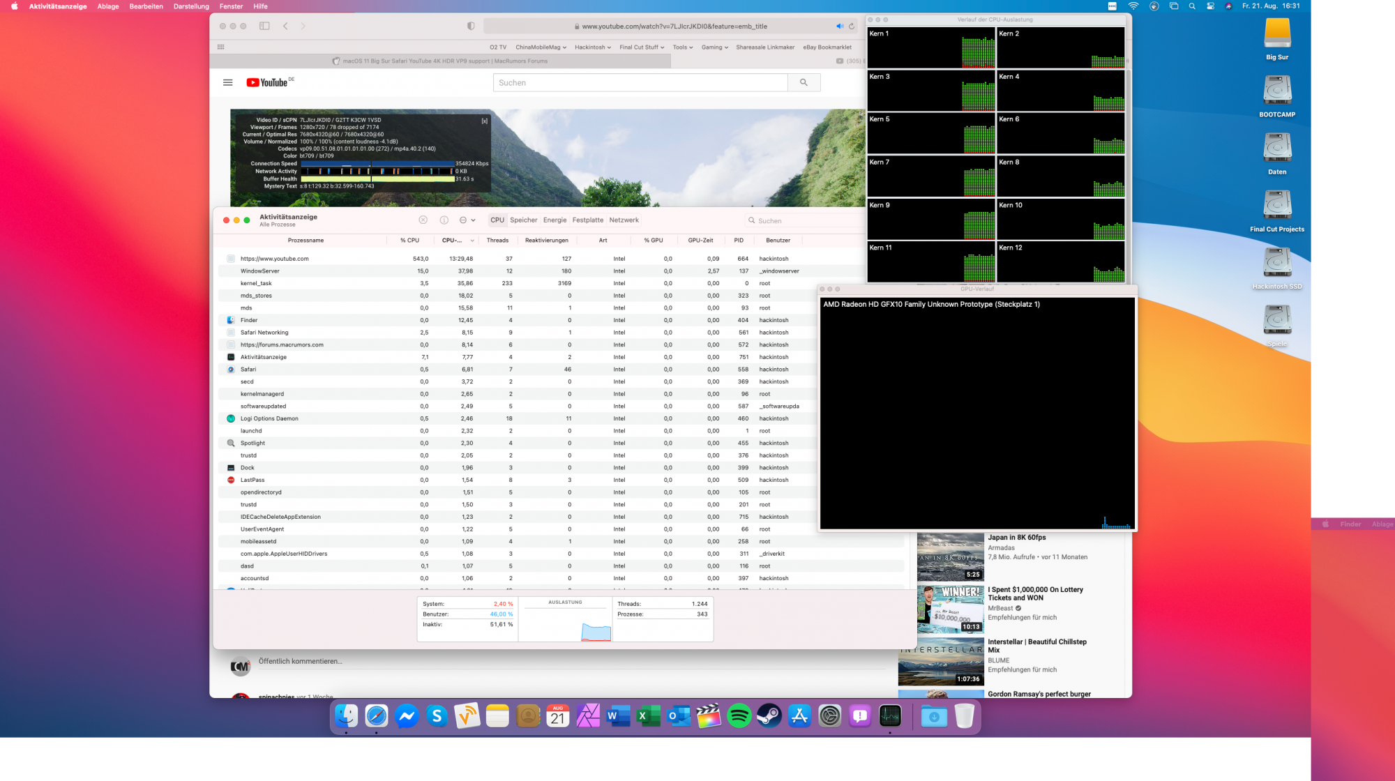

I’m seeing that there is no VP9 GPU acceleration at all when I use the 5700 XT eGPU. Even though the graphics card becomes very loud the Activity Monitor shows that the Intel 630 iGPU is trying to do all the work. Bad bug. The eGPU should be doing all the work.
Yeah absolutely smooth but it always has been. 8700k is powerful enough.

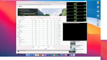

Interesting observation: I was using the Adder framebuffer of the Radeon Pro W5700X of the Mac Pro. Now I tried it with the generic RadeonFramebuffer and the 8k option is gone. So it looks like availability of the 8k option is dependent on the framebuffer and GPU that is active.
On the Radeon VII 8k is available with RadeonFramebuffer.
Edit: This is with RadeonVII and default RadeonFramebuffer. 8k available again but also appears to be CPU decoded:
In Beta 4 it used GPU decoding, CPU load was low. They changed something it seems.

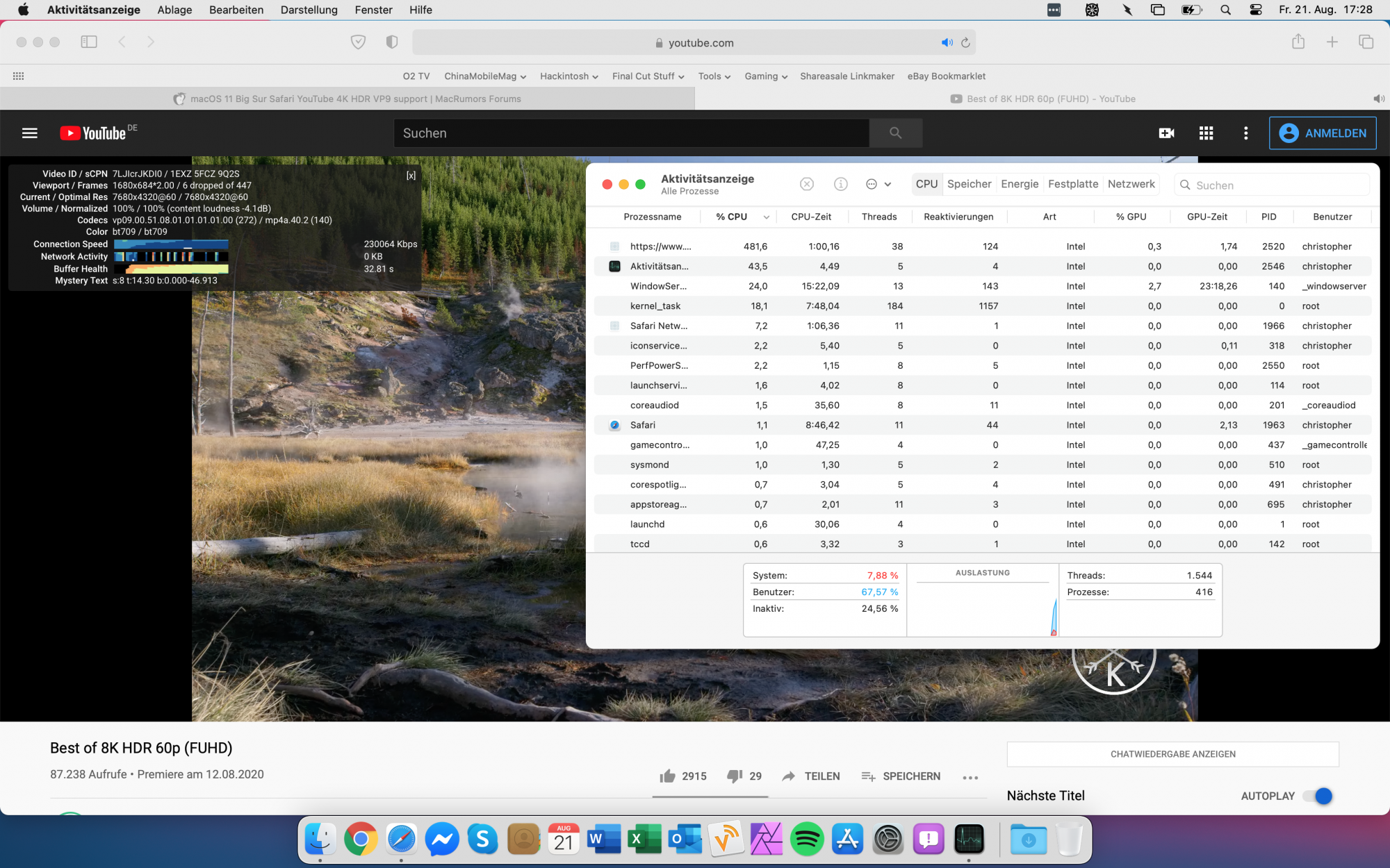

BTW, here is a screengrab of my CPU and iGPU utilization on the 2017 MacBook Core m3, playing that 8K video at 4K 8-bit.
