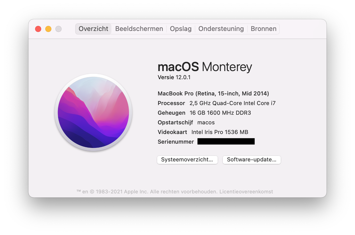

I'll give it a try. So holding the shift key, get's you into save mode from the EFI boot?
After the system hangs at 40% and you hear the voice over. reboot, hold the shift key when selecting EFI, hold this until it boots into macOS Monterey. Start OpenCore Patcher and select Post-Install Volume Patch. Reboot and your fine.

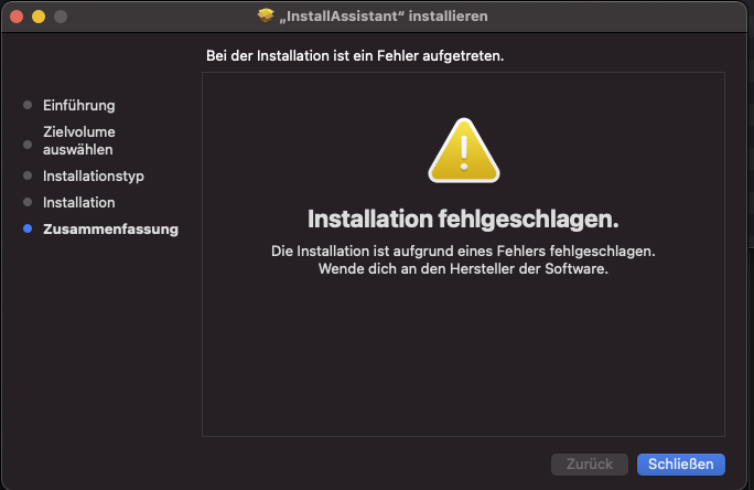

Hello,
i want to exceute the installassistand.pkg on a MacPro 5.1. But i get this error:
i have no idea, what is wrong?

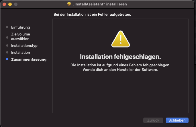

Hello,
i habe dry the public version 12.1 and released version 12.0.1
Yes, just create and use an USB installer using the InstallAssitant.pkg as described in the OCLP documentation and on the very first post of this thread. And use the latest nightly build in case you try to install 12.1 beta.
Apple created so many road blocks lately, the course of action is: Always use the latest OCLP before installing a new version of Monterey. Otherwise you may experience failures.
