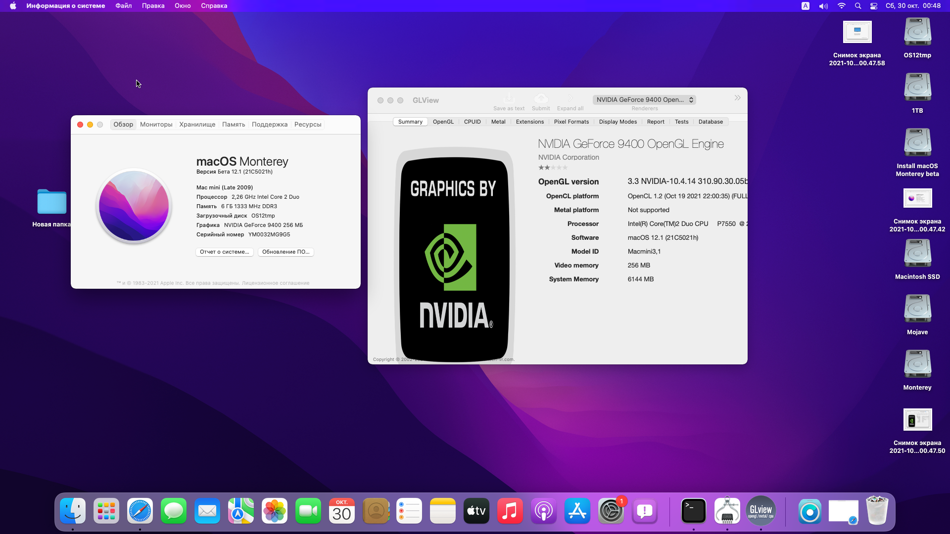

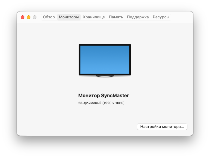

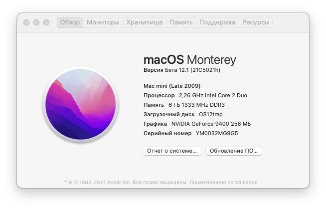

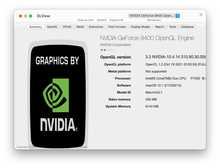

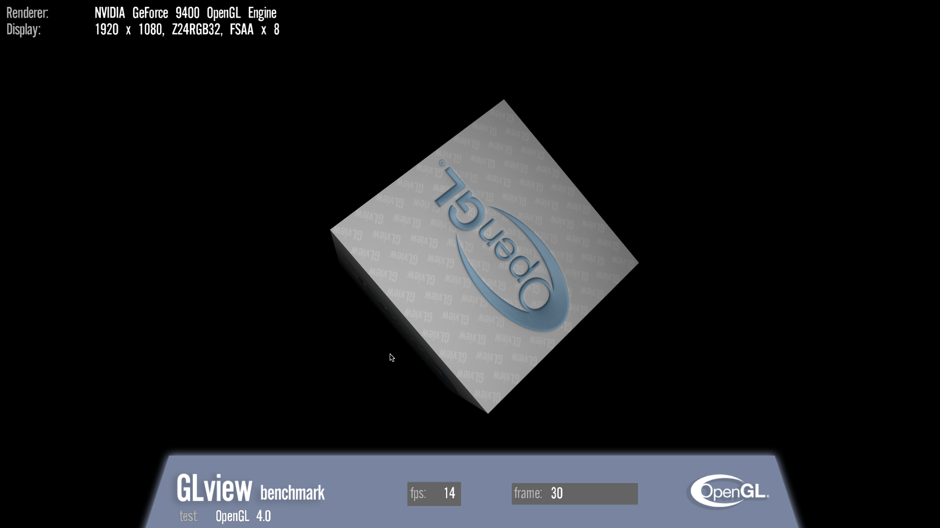

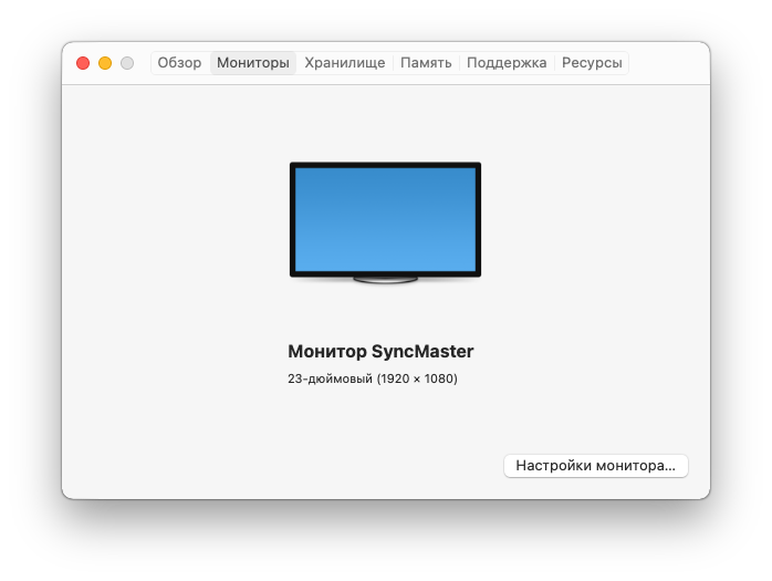

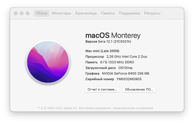

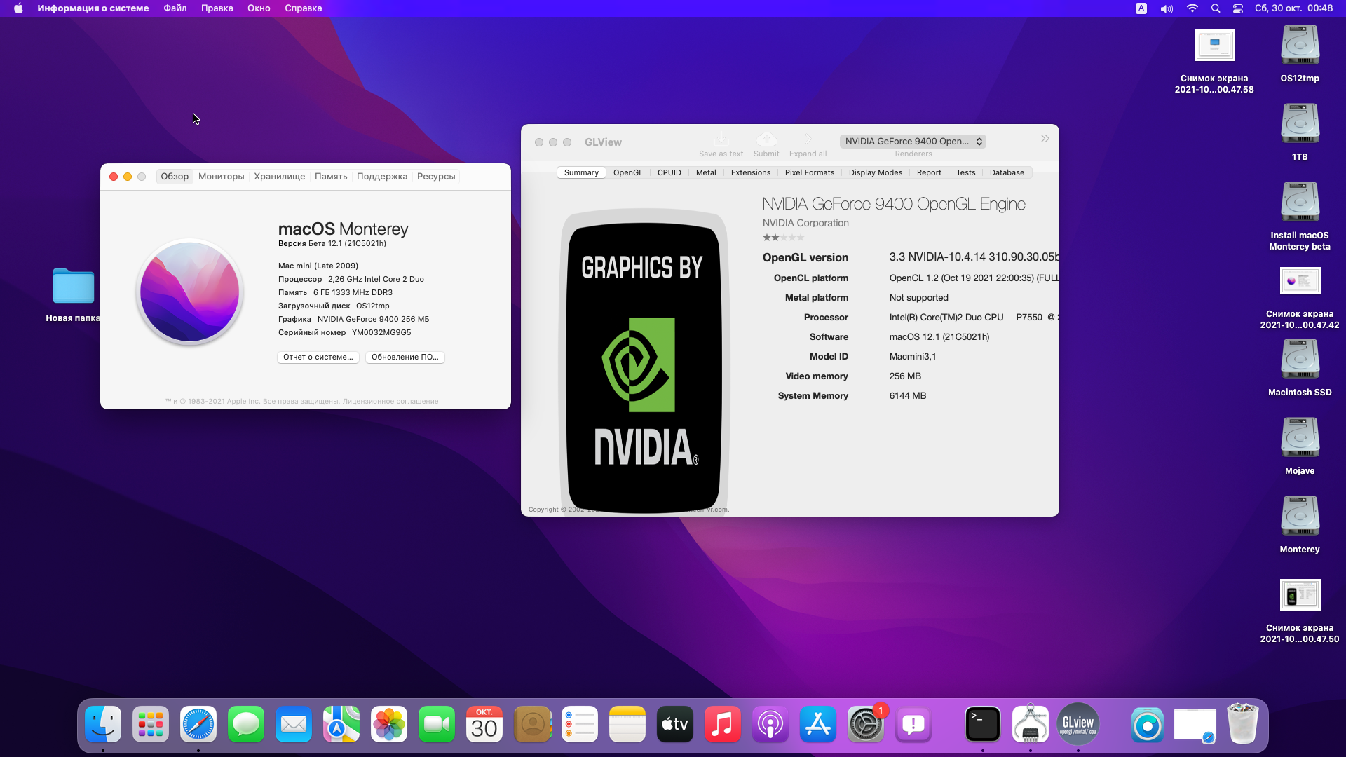

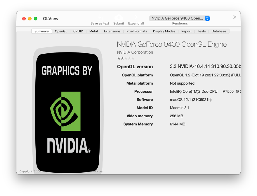

Successfully Updated my MacMini 3.1 from MacOS Monterey 12.0.1RC2 to 12.1 Beta1
OCLP - old config of OCLP 0.3.1NB with Monterand patch
System Volume patched by latest OCLP 0.3.2NB
Issues? When i reverted system patch - its breaked my 12.0.1RC2 instance - and i installed 12.1 Beta 1 from install media and recover broken MacOS.
Thanks for all contributors! Thanks Syncretic for this magic! =)

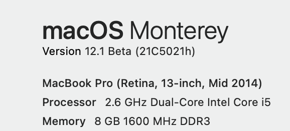

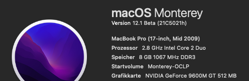

Happily installing 12.1b over 12.0.1 on MBP5,2 which has a Penryn T9600 CPU.
Using the OCLP from the announcement on Discord.
I had started the installation with an OCLP without the RDRAND fix which had to fail after the first reboot. After installing the one with the fix, installation just continues ok. How easy… thanks Syncretic and OCLP team!
Installation successfully completed. Post-install patches also done with the RDRAND-fixing OCLP.

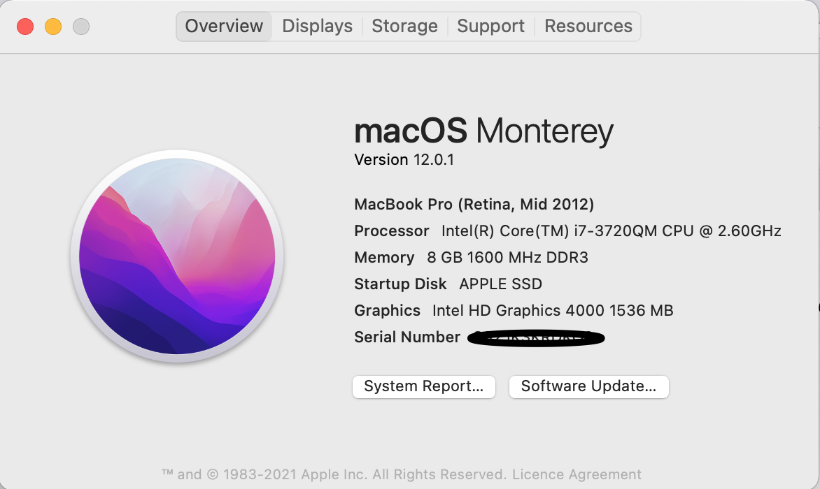

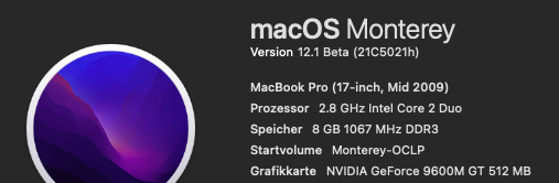

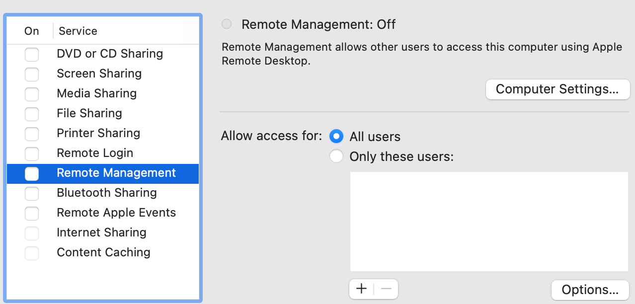

I found in 12.1 beta, the airplay receiver is disappear on the sharing setting anyone has idea??
The function of airplay to Mac is disable too, I am using OCLP 0.3.2, please help.
