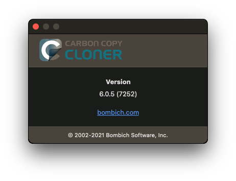

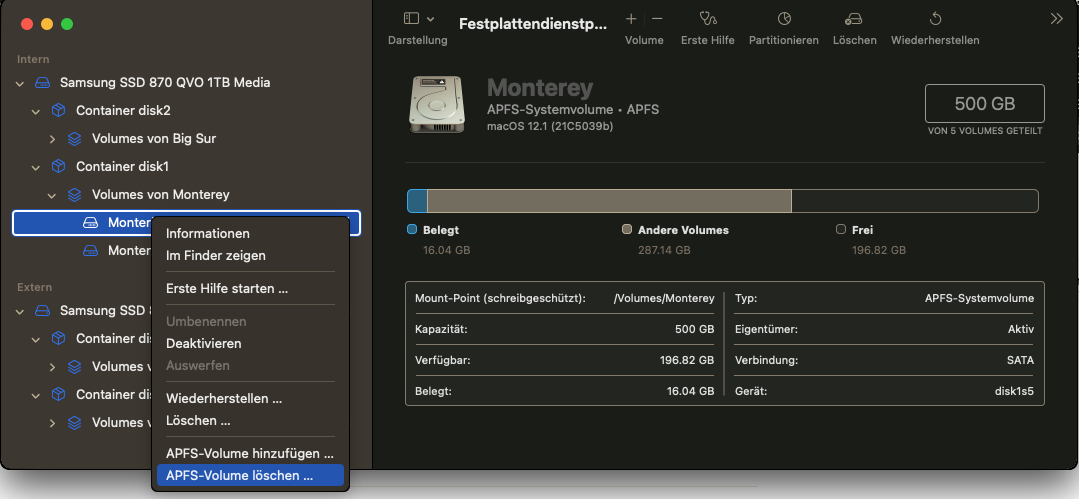

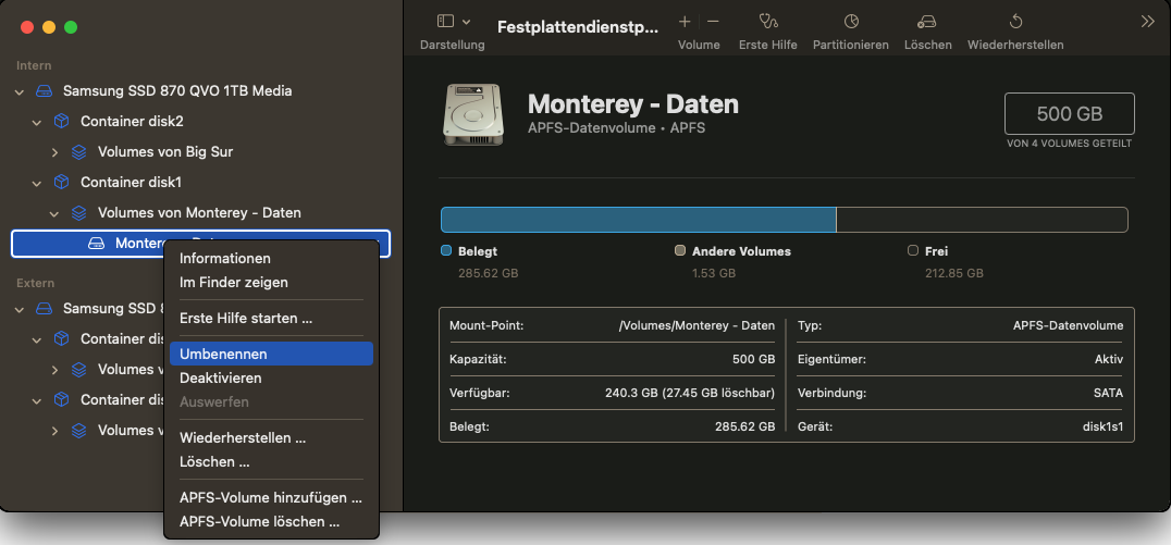

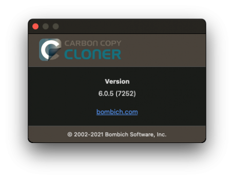

I used this procedure for downgrading from 12.1b3 to 12.0.1:
- made a data-only backup from my reference system Big Sur 11.6.2 to Monterey 12.1b3 with CCC 6.0.5
- removed the APFS volume for the Monterey system using disk utility
- renamed Monterey data to Monterey using disk utility
- installed 12.0.1 from full installer.
The normal way would have been to clean install 12.0.1 and then migrate the user data from a backup. The above just bypasses full migration but used what is already in the data volume.

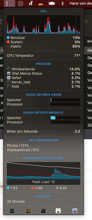

AHOY!🪓 The most recent OCLP_032N fixes the Beta 3 browsers problems. Both Safari and Firefox back to normal. 😎
Confirmed on MBP5,2, with both 12.1b3 and 12.0.1.
Rather than using the latest 0.3.2 nightly, I was using the OCLP 0.3.1 release with the minimal substitution of SkyLight.framework binaries taken from a Discord link.
Sure enough BlurBeta is also part of this SkyLight.
Many thanks to ASentientBot and friends!!
Now 12.0.1 and 12.1b3 are production-ready for me with my rather limited graphics requirements; Photos works well, and systems are stable.

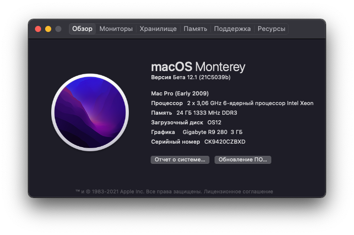

Hi to all!
My CMP 5.1 (flashed 4.1) 2009 updated from macOS Monterey 12.1 Beta 2 to 12.1 Beta 3 at last week.
All works fine, and better than "final" 12.01
OCLP - 0.3.2 NB
Updated without issues, works fine with flashed HD 7950 3GB.
GC-Alpine Ridge works normally, without SSDT ( Titan Ridge SSDT - crashed system on wake from sleep)
Thanks for all contributors!!!
