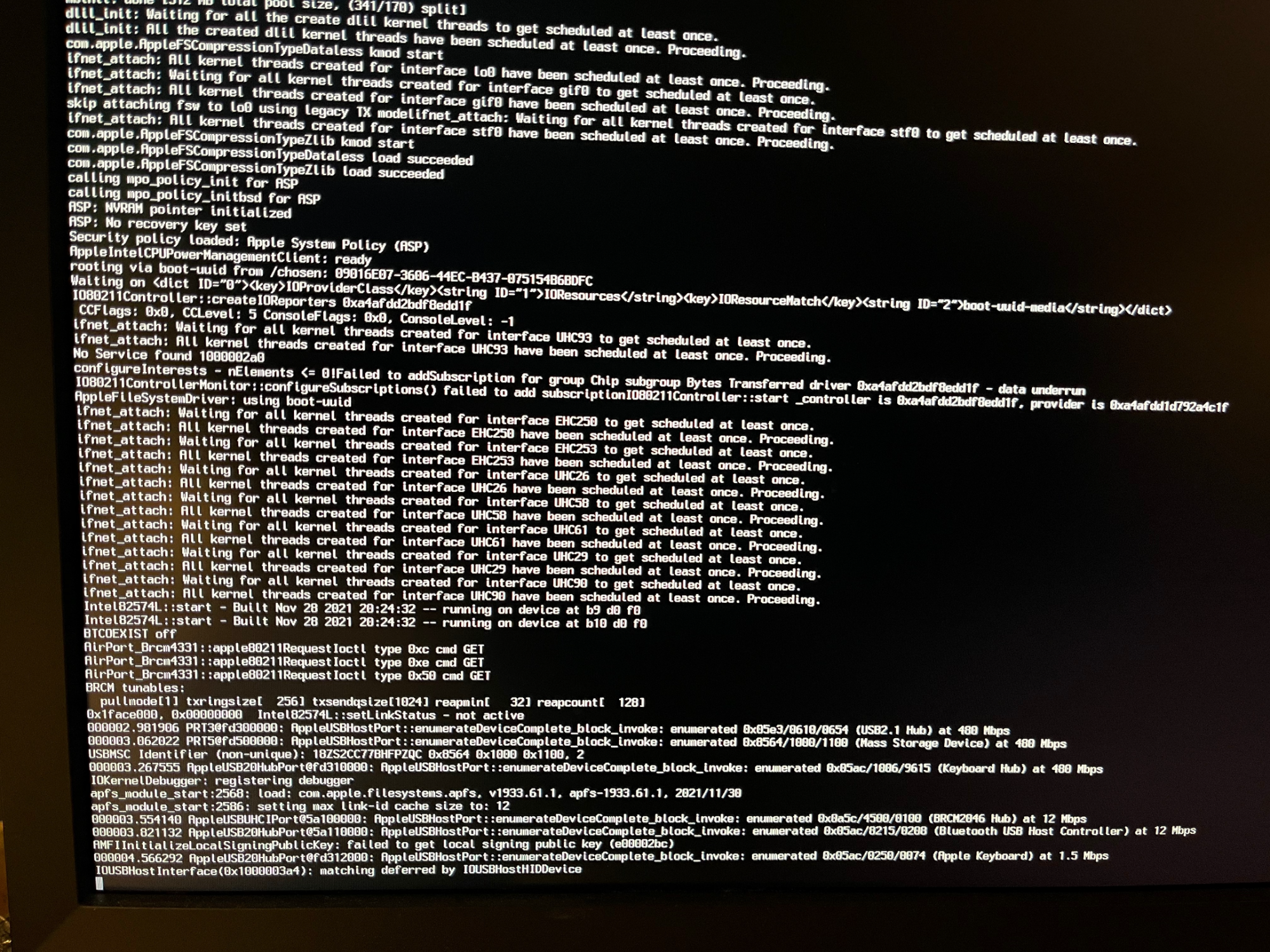

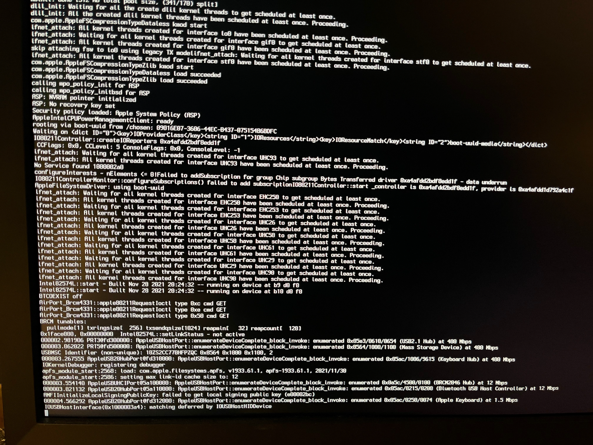

I got a problem with a remotely serviced Mac Pro 5,1 Dual with RX580 and OCLP 0.33 Minimal Spoofing
Tried a clean install of 12.1 via createinstallmedia thumb drive installing on a sata ssd on southbridge and we run always in an error after the 1st reboot:
Failed to get local signing public key
the odd thing is: I can install it performing the same steps on my machine, we use the same 0.33 built generated on the Mac Pro what hangs. My machine has a RX560, the other problematic one a RX580.
12.0 runs fine on a NVMe drive we dont touch at the moment.
the machine is stripped down to just what is needed to do the installation.
we did even a firmware cleanup.
USB hardware is a standard alu keyboard and a usb mouse.
someone shed a light into this mystery?

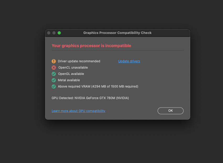

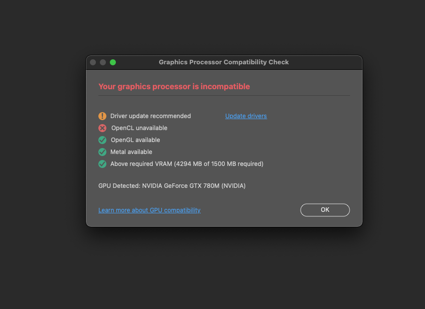

I could need a tip or help. Since I updated my iMac 14,2 with NVIDIA GTX 780M from Big Sur to Monterey using OLCP (now) 0.3.3 I needed to post install the patches. The overall graphics performance of macOS seems to run better but my graphic apps (i.e. PhotoShop etc all) have an issue with weak performance. Photoshop gives the following note that I haven't had under Big Sur.
Any idea?
Any idea?
This is a known issue since October and I have seen a fix on Discord for HD4000, but do not know if it has been added or even if it works for the Kepler GPU, too.
It is obvious that some libs within the OpenCL.framework are missing on Monterey, while still present on Big Sur!

I have a Late 2013 iMac which I want to upgrade to Monterey. Followed this excellent guide very carefully I selected 12.0.1 and OCLP TUI 0.31. I had a couple of problems down the line, first, I have a Fusion Drive so had to find an alternative method of erasing it (
). After a number of apparent abortive restarts and watching the Verbose scripts, I got to recover my data. All was going well but I took my eye off the screen and after finishing recovering my data it did a restart. Bearing in mind that I was expecting to go to the reload the OCLP step, the restart gave me the "This version of Mac OS X is not supported on this platform!" message. A search on GitHub seemed to recommend parking the NVRAM but now all I get is a prohibited sign and pointer to support.apple.com/mac/startup. CMD R doesn't take me to Mac OSX Recovery. Any clues on how to recover from this? Thanks in advance.
I have a Late 2013 iMac which I want to upgrade to Monterey. Followed this excellent guide very carefully and had a couple of problems down the line, first, I have a Fusion Drive so had to find an alternative method of erasing it (
). After a number of apparent abortive restarts and watching the Verbose scripts, I got to recover my data. All was going well but I took my eye off the screen and after finishing recovering my data it did a restart. Bearing in mind that I was expecting to go to the reload the OCLP step, the restart gave me the "This version of Mac OS X is not supported on this platform!" message. A search on GitHub seemed to recommend parking the NVRAM but now all I get is a prohibited sign and pointer to support.apple.com/mac/startup. Any clues on how to recover from this? Thanks in advance.
Check the OCLP online docs and troubleshooting section.
