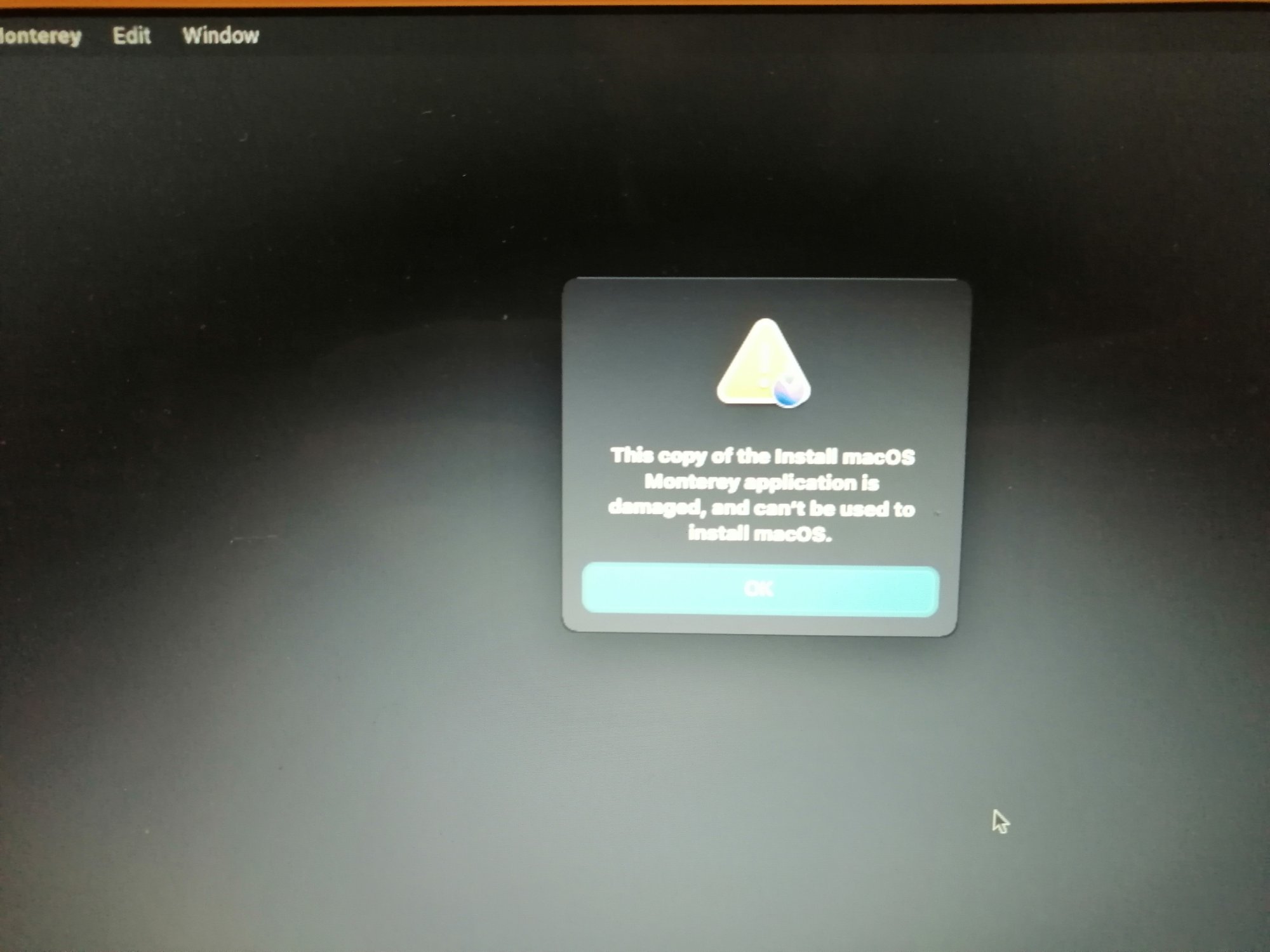

hi guys!!!
could someone explain to me pls why i get this error every time on macbook 5,2? i have created the installer 7 times with different monterey install app every time.. :(
ty
edit: changed usb installer and worked like a charm!
my 2 mb's 5,2 hasve now monterey! ty guys for the help! :)
cheers!!!

hi guys!!!
ty
I tried 3 different USB devices, to no avail.
K two pointed me in the direction of San Disk Cruzer USB 2.0, which worked with my machine. And FireWire800, if you happen to have that port, via OCLP 0.3.4n
Reactions: K two and mwakious

The Machine is a mid 2010 iMac upgraded with xeon processor, 20GB ram, SSD, nvidia quadro K1100 with flashed rom.
The iMac was running fine with 10.13.6 installed, but I wanted something newer. So I did a complete backup on my NAS with time machine and followed the guide by MrMacintosh to create a bootable USB flashdrive and perform a fresh installation of monterey.
My first installation was successfull, I got the system up and running with post instal volume paches and everything looked wonderful. Well, not everything because the migration assistant actually broke up my installation while trying to get my data back from time machine.
So I restarted with a second installation which was again successfull. This time I tried to access the backup from finder instead of using migration assistant, but I was unable to get my data back. I think the version of time machine that comes with Monterey has problems with backups performed on High Sierra, and infact when I tried to do a complete system restore from time machine with the bootable flashdrive I just created for Monterey, it miserably failed.
So this time I booted in the internet recovery (with CMD+R) and successfully restore my system to High Sierra.
Now I saved manually my data to an external drive and went for the third installation of Monterey which was UNSUCCESSFULL.
I tried many times now, and I'm stuck. The installer is doing all its things till the file copy and at the second reboot I can still see the volume called macOS Installer (the other times it showed the name of the volume) then does again the file copy, shutdown and restarts again in the installer over and over again.
I thought it could be the version of OCLP I had previously installed on my SSD, so I attended the whole installation process making sure I booted off the USB flash drive with the OCLP installed there. I even tried resetting NVRAM/PRAM but it didn't work.
I can't understand what's wrong this time.
Hope I can get some help here.
Thanks in advance, Andy
edit:
after many times rebooting the macOS installer it goes into the "Lilu dev: @ failed to obtain model information, retrying"
I read that error occured only with OCLP 0.3.1 and Lilu 1.5.6. But I am on OCLP 0.3.3... Can't understand if this has something to do with NVRAM on my mac or opencore on the USB stick that's being corrupted
You can only have a single OC version installed on your system. So please install the current version on your internal SSD and delete the USB version or vice versa.
Since your system has a real EFI boot picker you should go with the first solution and have OC installed internally. At least this is the way I handle it successfully.
Ok, but until the system is installed in the internal SSD the only OCLP version I have is the one on the USB stick and I rely on that to boot the system and complete the installation.
Anyway I got out of the loop by resetting NVRAM after I got the Lily error. After that, the installer managed to complete the ramrod stuff (God knows what that means) and gave the final checkpoint successful (which I assume is what it needs to boot the system at next startup).
Writing from Monterey now... I'll let you know if I encounter any bug or whatsoever
