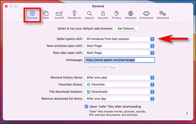

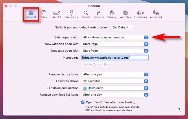

it always starts with windows from the last session.
Look in Safari preferences.
Unselect the one that says Safari opens with "All windows from last session"

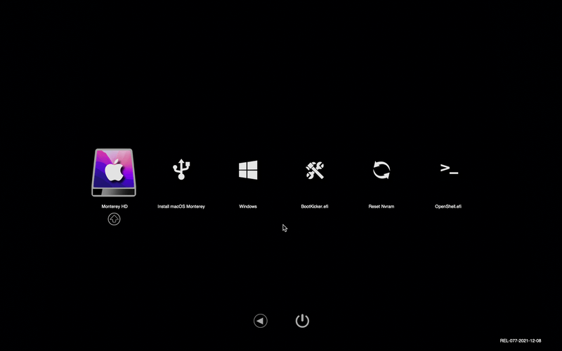

Step 1: Check Boot into external drive
1) FW800->fail (Ø-Symbol) (Monterey Installer was selectable, then failed to load)
2) USB 2.0->OK (Monterey installer correctly showed panel "Time Machine Backup"/Monterey installation/..First Aid", would let me then proceed with installation screen.

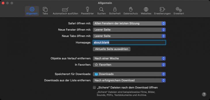

If only it were that simple.

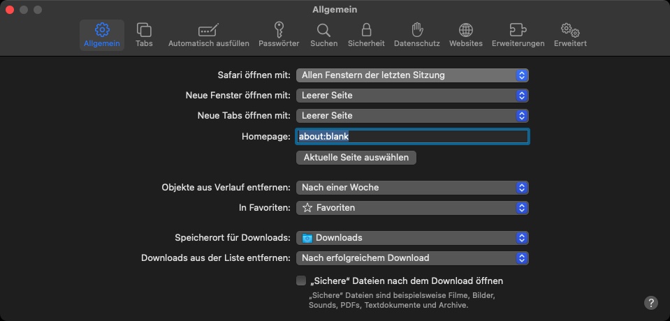

Look what I have got in Safari prefs: choice between rock and hard place a.k.a. all windows or all private windows from last session.
So the matter stays unresolved?

there is a workaround, a little annoying though.
Shift-click on Safari in the Dock will open Safari with a blank page.
Before, there was a dedicated Safari pref for that.

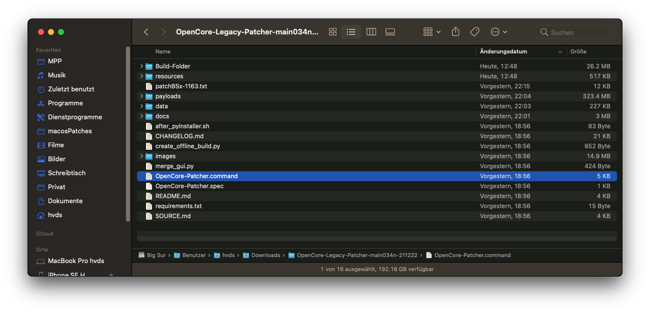

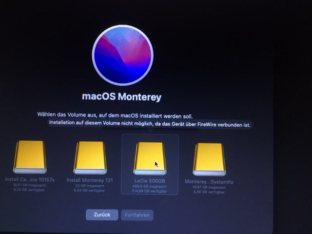

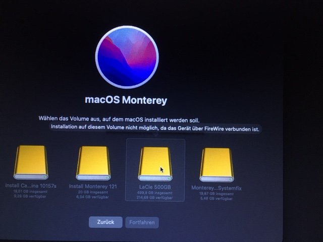

I tried to install to the FW drive again, with the USB installer booted via the fixed OCLP.
Same result: can't install to the drive when it is connected via FW. As it has a USB2 interface as well, I can install to it this way.
Anyway booting it and running it via FW works well.
Probably the fix will be in one of the coming 0.3.4 nightlies.
It is also appended as zip here if you want to try it. Just run the OpenCore-Patcher.command which should open in Terminal when double-clicking. It is the TUI version.
The change is in resources/build.py, check_firewire().
EDIT: the zip file was too large for upload. Please find it here instead: https://www.dropbox.com/s/jgd0ye5z5q719j8/OpenCore-Legacy-Patcher-main034n-211222.zip?dl=0

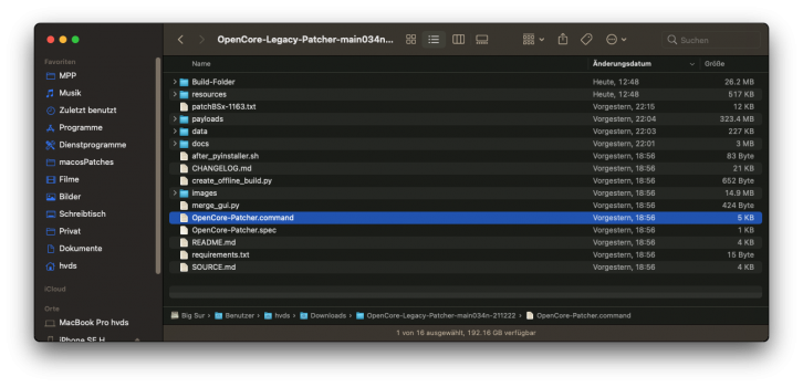

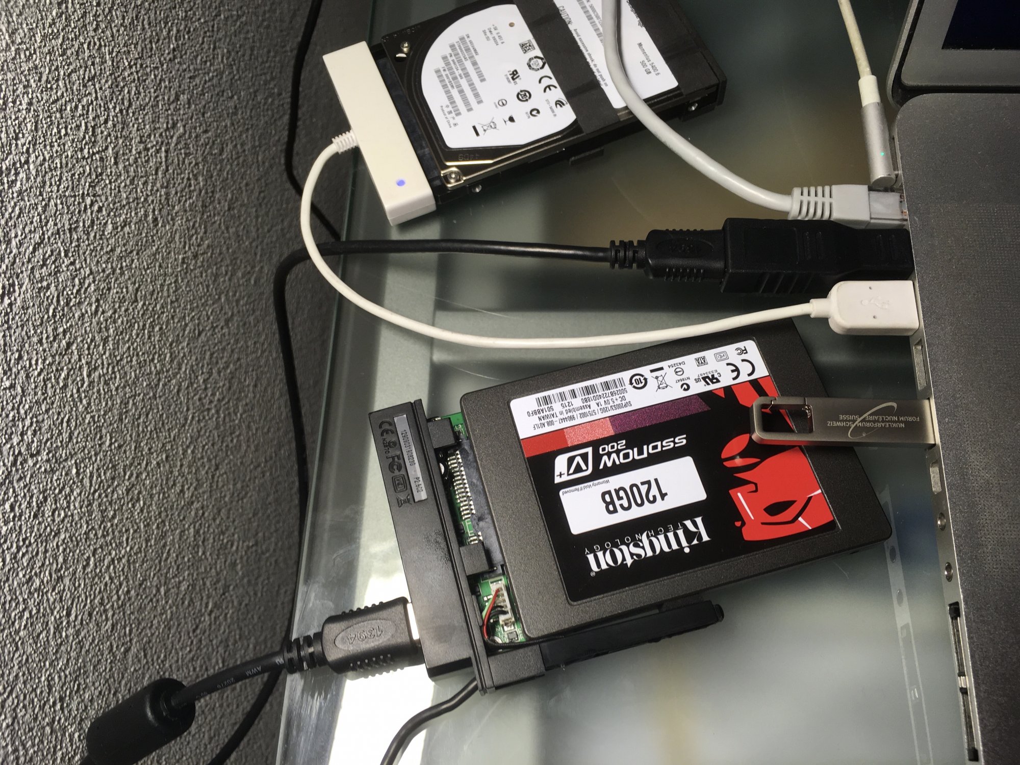

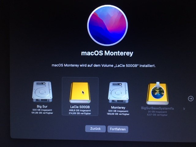

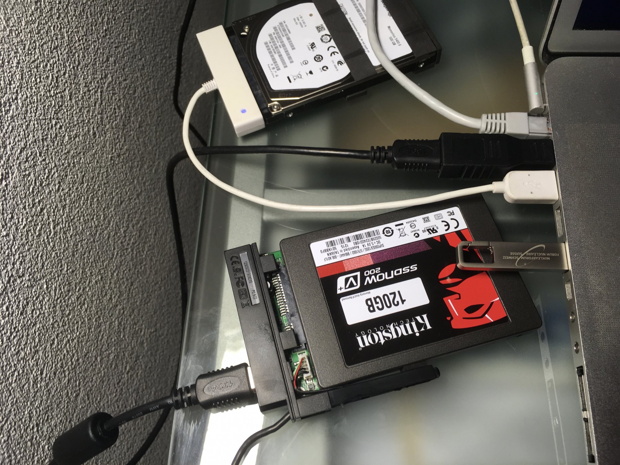

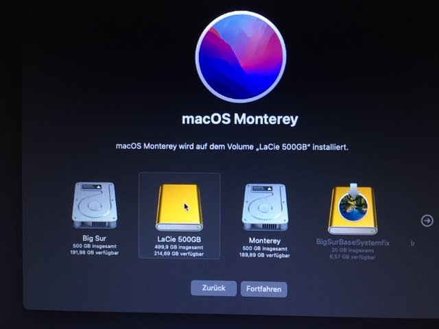

That seems to work -
For a test I‘ve put the Kingston SSD which contains the installer, into the enclosure which has the FW port (plus unused USB). The target disk in on a USB2 adaptor.
Stage1 of installing 12.1 again to the target spinning disk is completed, thus most (all?) accesses to the installer; stage2 running.
The fix to OCLP is already in the 0.3.4 nightly.
Differences to your intended setup are:
- I‘m using FW400 with 400-800 connector on the Mac side
-installing to a USB target
but I don‘t think that matters.

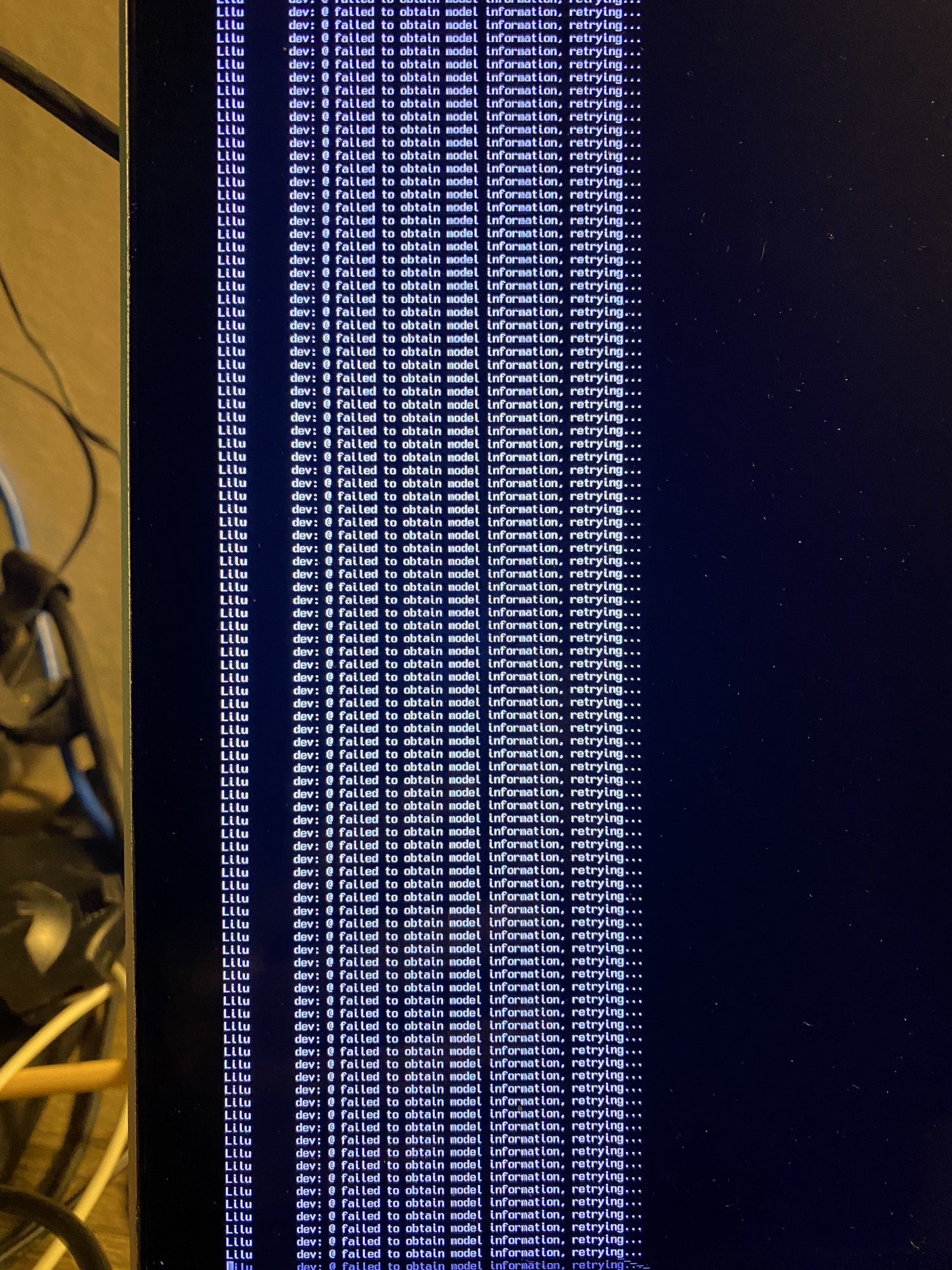

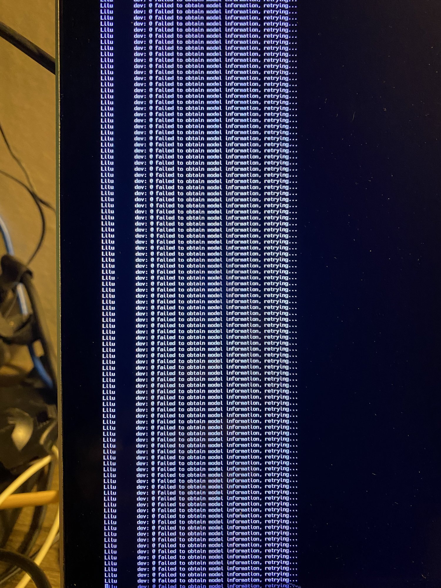

The fix is not working from external FW800/400 spinning drive to internal SATA connected Macintosh HD SSD.
Still the same Ø message on the screen.
I attempted the clean install from 3 FW disks with 3 different FW cables, the internal drive within the MPB seems to be addressed differently by Apple.

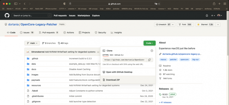

The current build is available for download here (that link is only valid for some time and will not be updated) - you might need a GitHub account for accessing it.
My FireWire enclosures seem to have the chipsets from Oxford Semiconductor - but I think that shouldn't matter for Intel Macs.

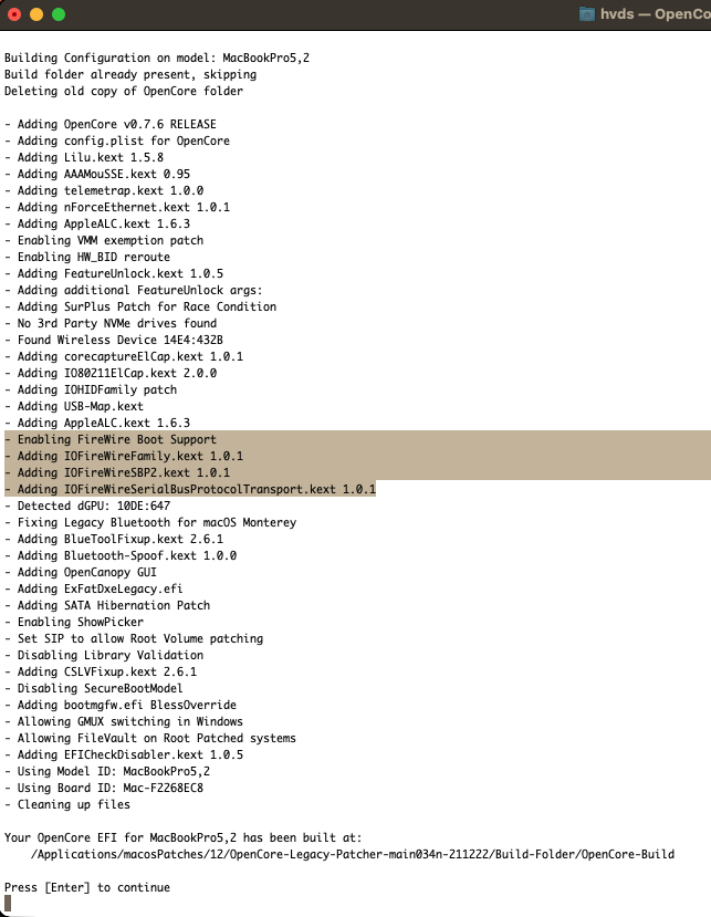

In my setup here, I get the Ø message when trying to boot a FW disk WITHOUT enabling the FW boot in OCLP. That is the case with OCLPs which dont't have the fix, or if the FW boot isn't enabled even in the version with the fix.
Make sure it is enabled in the OCLP with the fix: do
5. Patcher Settings, 4. Boot Volume Settings, 1. Set FireWire Boot, y, Q, Q.
Then 1. Build OpenCore. The build protocol should mention FireWire.
Then 2. Install OpenCore to USB/internal drive.
Sorry if I haven't made clear that setting FW boot is required despite the fix. The bug had just prevented setting FW boot to take effect.

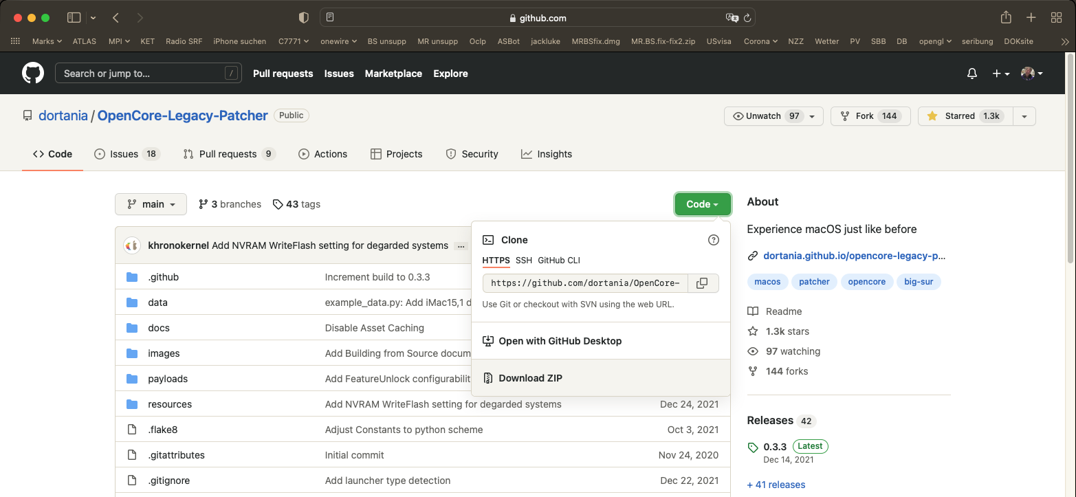

As for access to the nightly builds, on the OCLP Github https://github.com/dortania/OpenCore-Legacy-Patcher, click the green Code button and Download ZIP.
Thank you for the link, which is indeed no longer available for download. I do not have a Github account, unfortunately.
Thank you, hvds, for taking the time to look into the issue once more.
I indeed was looking for the FW prompts in the build protocol and it wasn't there, which was entirely my fault.
So, I built everything again as per your detailed instructions, and it executed as you described.
Thus, the FW issue looks resolved. I hope, it will be in the next OCLP 0.3.4 release.
Thank you for the tip on how to get the n builds via clicking on "Code">download .zip on the Github OCLP page.
Awesome, hvds. You made my day.

Hello!
I have a problem when I boot into the drive: "Display: Lilu Dev:mad: failed to obtain model information, retrying" Model: mpb 15 - 2012 (i disabled GPU Nvidia)
Reactions: hvds
