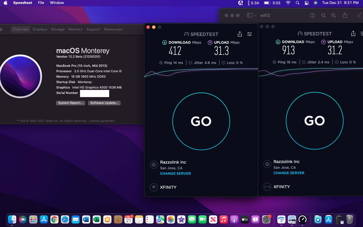

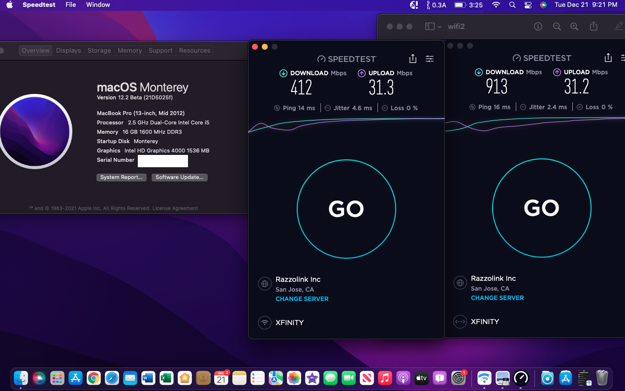

no issues here OCLP 0.3.3 OOKLA SpeedTest app thru Wi-Fi and Wired connections.
What are the specs of your Mac? I tried downloading directly from Apple Store, and copying the APP from another Mac. It crashes instantly upon start. My MAC is a Retina Mid 2012, 2.7Ghz i7 same Intel Graphics. I had upgraded the Airport Card to the one in the 2013 with WiFi n and AC and bluetooth 4. Looks the issue is hardware specific (thought it ran OK in Catalina on the same machine. Everything else seems to be OK

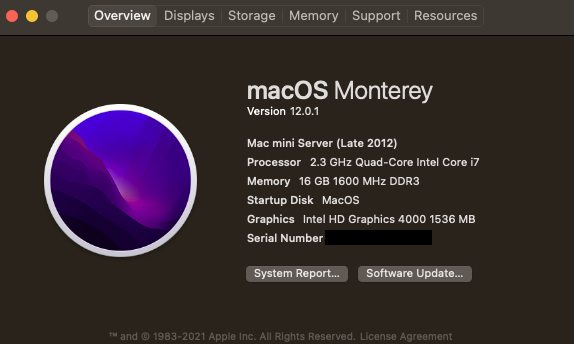

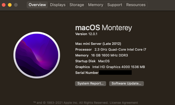

Hi everybody, just confirming the Monterey patch works fairly well on a Late 2012 MacMini. There are a few graphic artifacts around the dock and the edges of some windows, but it's pretty great otherwise. I can totally work with it! I just opened a fairly hefty Final Cut project and worked on it with no problems. Thanks!
