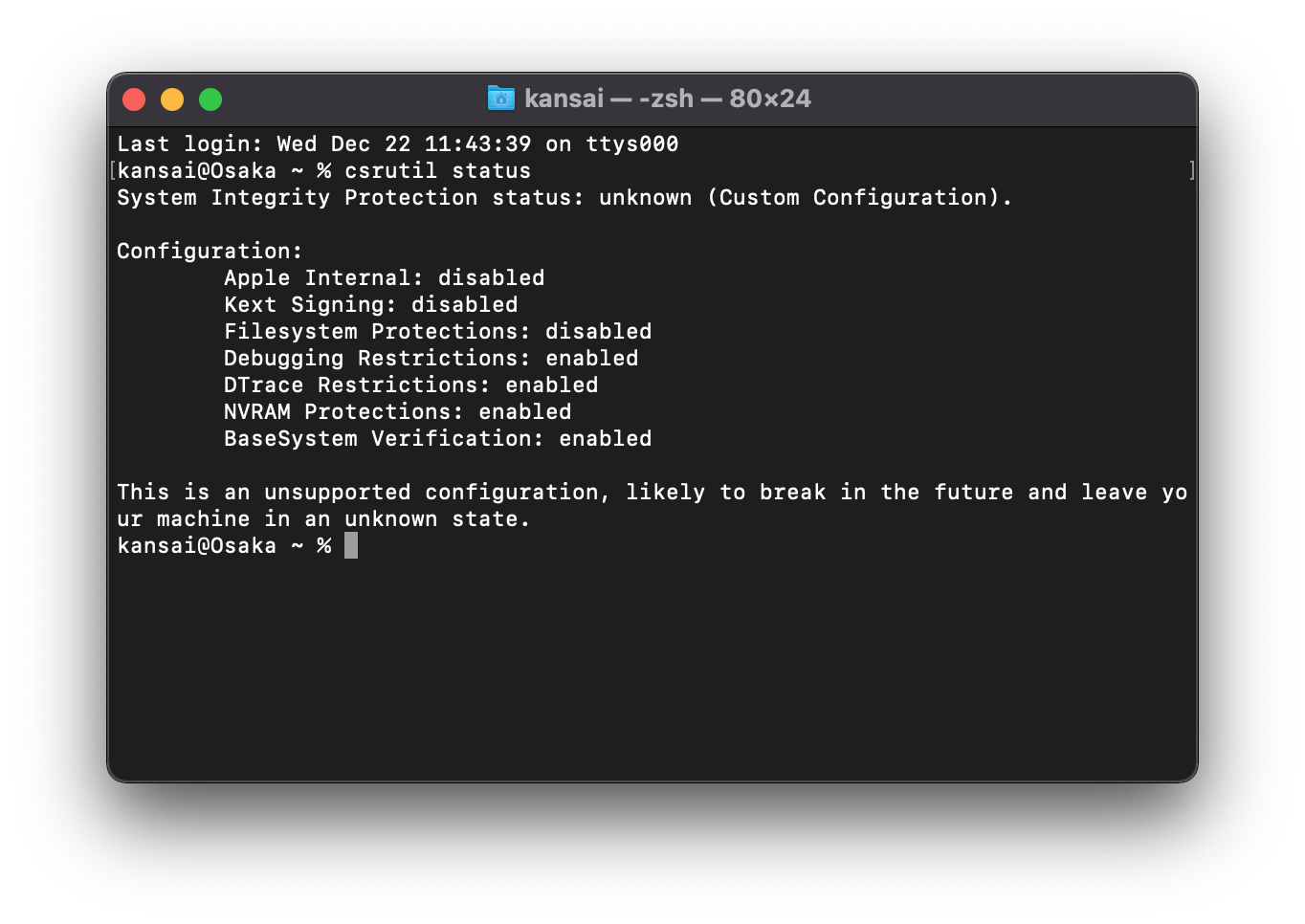

Seriously? Isn't that a major security risk? I thought one of the features of OCLP was that once you're done you can enable security again. Otherwise why would they have SIP/SecureBootModel check-boxes?
So if SIP is now permanently off on my machine, how does that affect vulnerability regarding my data? What is the original purpose of SIP/SecureBootModel?

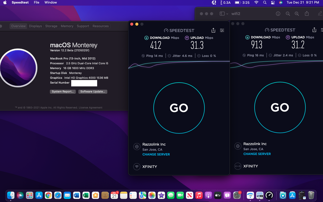

Updated a MBP mid 2012 (with upgrade WiFi card) using OC 0.3.3 to 12.1 Monterrey. Amazing work on the patcher and post installation patch functionality. This is my 1st installation to an unsupported MAC. I am impressed how fast and well the 9 year old MBP functions with Monterrey. So far the only issue on installed Apps is OOKLA SpeedTest - it crashes at launch on the unsupported MBP - works well in my other supported MACs. Is anyone else having issues with this APP? (Their web site works fine)
no issues here OCLP 0.3.3 OOKLA SpeedTest app thru Wi-Fi and Wired connections.
iMac 12,2 Running:
In Separate Partitions - Monterey 12.1, Big Sur 11.6.2, Catalina 15.7,& Mohave … all via OCLP 0.3.3 and Windows 10 & 11 via Parallels Desktop VM’s under Big Sur, I upgraded High Sierra to Big Sur … Monterey clean install all on the same 27” 2011 iMac utilizing the Nvidia K5100M gpu upgrade … Monterey required post volume patching for WiFi and Brightness slider. 2TB SSD APFS partitions i7 cpu 32 GB ram
Would like to Thank all the wonderful & Brilliant folks here (you know who you all are) that made it possible for me to do all the above! 😊💙

Hi. So, are you saying we shouldn't worry about SIP on Monterey? Can I enable SIP now using OCLP-GUI (SIP/SecureBootModel check boxes), build and install to EFI, then disable SIP when I want to upgrade to 12.2? What do you recommend?
Do signed system volumes actually affect security related to remote access to local machines and potentially iCloud data via AppleID's? Or is it only relevant to encrypted hard disks and such?
Thank you.
AFAIK, you cannot enable SIP.
You are missing the point - SSV is signed with Apple keys. Only Apple have it. A patch system volume, like yours, SSV is broken and will fail the checks.
That's the price to pay for running latest OS on unsupported mac.
As to how insecure - I don't know. Not qualified to talk on that subject.
Personally, I don't worry about it.
