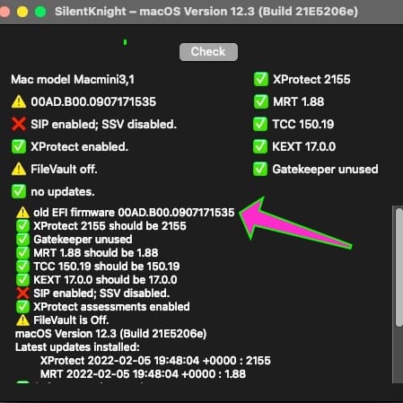

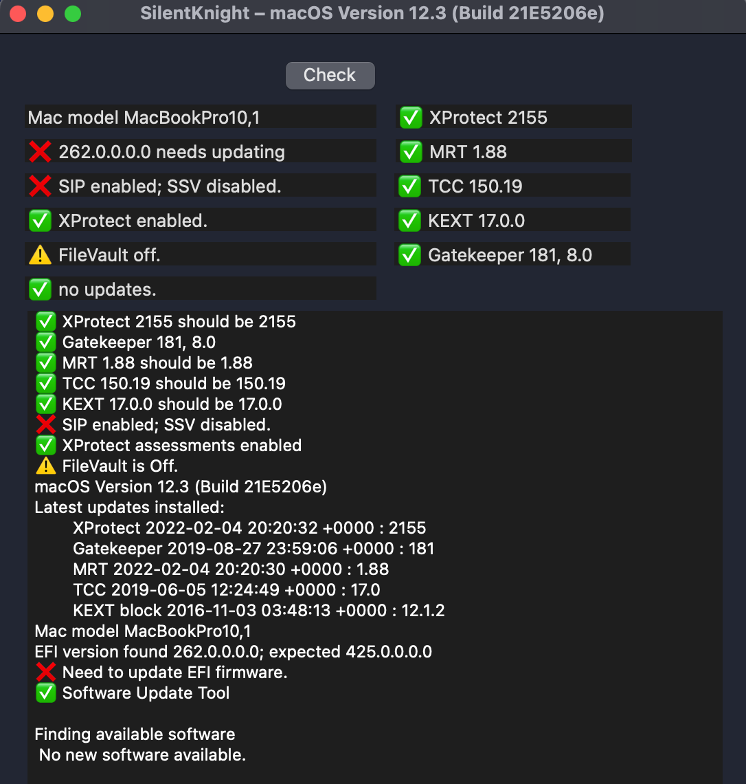

The spoofing by earlier versions of OCLP makes it difficult to tell. Note how the firmware got jacked to max value 999.x.x.x.x
Your should update OCLP to latest, which is spoof-less, and check again.
Thanks, removed the "minimal" spoofing and updated the on-disk OCLP config, rebooted and re-ran SL. Question - how do I now get the latest EFI firmware?
