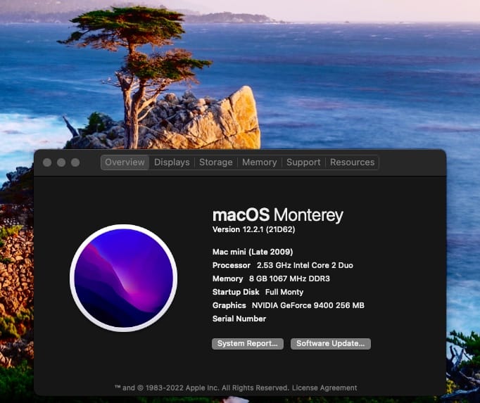

Update to macOS 12.2.1 atop 12.2 OTA via OCLP_043N, hands-free on it's very own partition. Runs better than expected. ;)

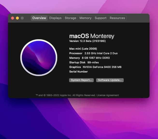

Is there a problem with Monterrey 12.3 ? It's very odd the lack of people in this update
macOS 12.3b2 runs as expected but contains some significant changes which may not function on some unsupported Macs.
Shown is b1 before the update to b2. Uses more overhead compared to 12.2, 4GB machines will need more RAM. 🚧
