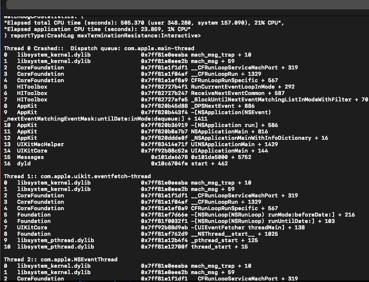

of course I used the latest OCLP 0.4.2 when installing 12.2 on clean disk.
However, I experience 5 or more crashes each day, very annoying 🙁
Running the latest macOS, Monterey, on non-metal GPU is always a hit&miss experience as Ausdauersportler has pointed out before. I've upgraded all my iMacs (which can be upgraded) to metal GPU to have minimised a lot of headache, thanks to Ausdauersportler and all the other developers involved.
I am done with Monterey, back safely to Big Sur, Volume Hash Mismatch did it.
Can't stand it happening in the middle of work, application stops responding and have to restart.
This issue disappeared in 12.1 (21C52), at least for me. Check if mds appears in crash report

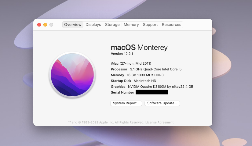

Updated to 12.2.1 using OCLP GUI 0.4.1
Initiated the update, went out or coffee, came back after 1hour and I was greeted with 12.2.1 w/o graphics acceleration and wifi. After running the post install patch, everything works, as it should on my current specs, without any hitch.
Kudos to the brains behind OCLP and to all contributors in this thread.
