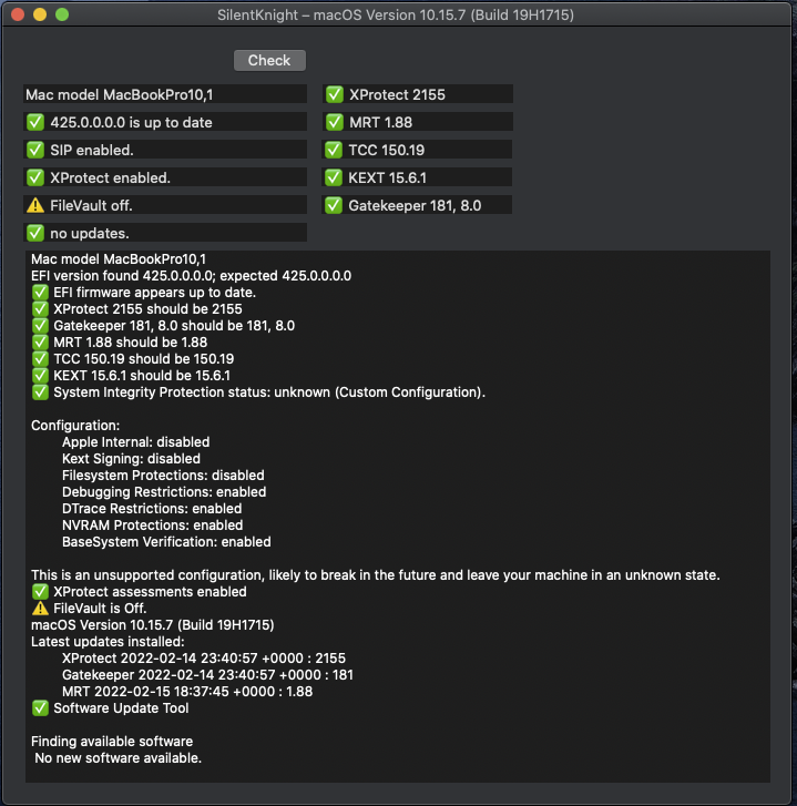

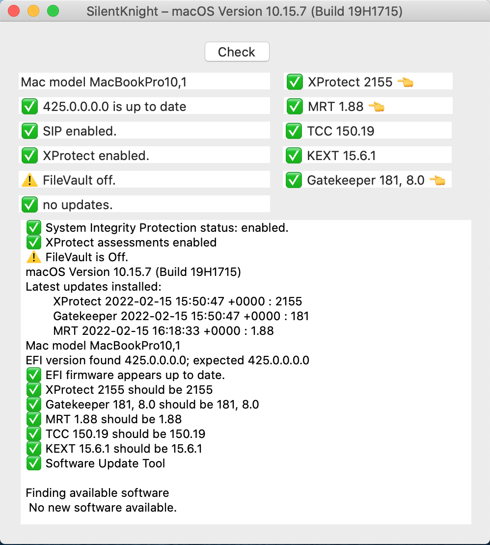

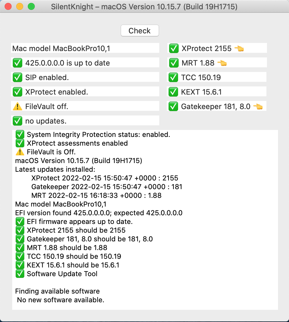

Good News FINALLY - after performing the NVRAM reset and proceeding to reinstall Catalina from USB onto a USB partition AND taking all of the Apple updates, I can report my EFI firmware was successfully updated,
(*above screen capture was while booted into Catalina)
Again, I did not touch the internal SSD with OCLP+Monterey and the EFI firmware persisted when booted into OCLP+Monterey. Woohoo!!!

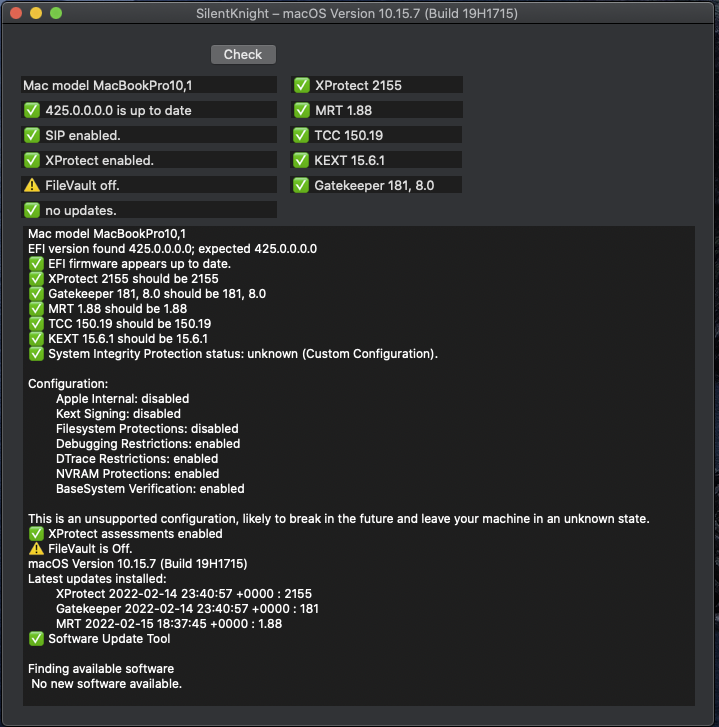

SL booted from OCLP+Monterey still shows EFI firmware at 425.0.0.0.0 with "SIP enabled; SSV disabled".

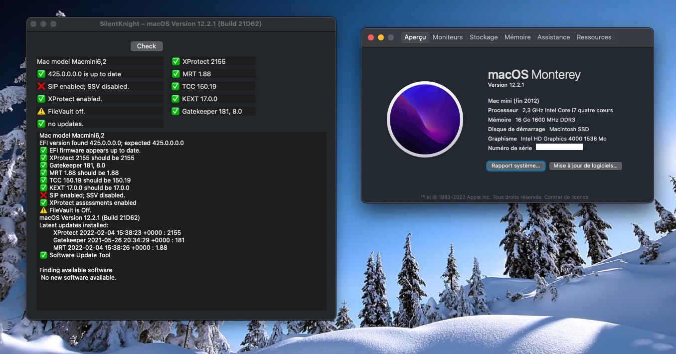

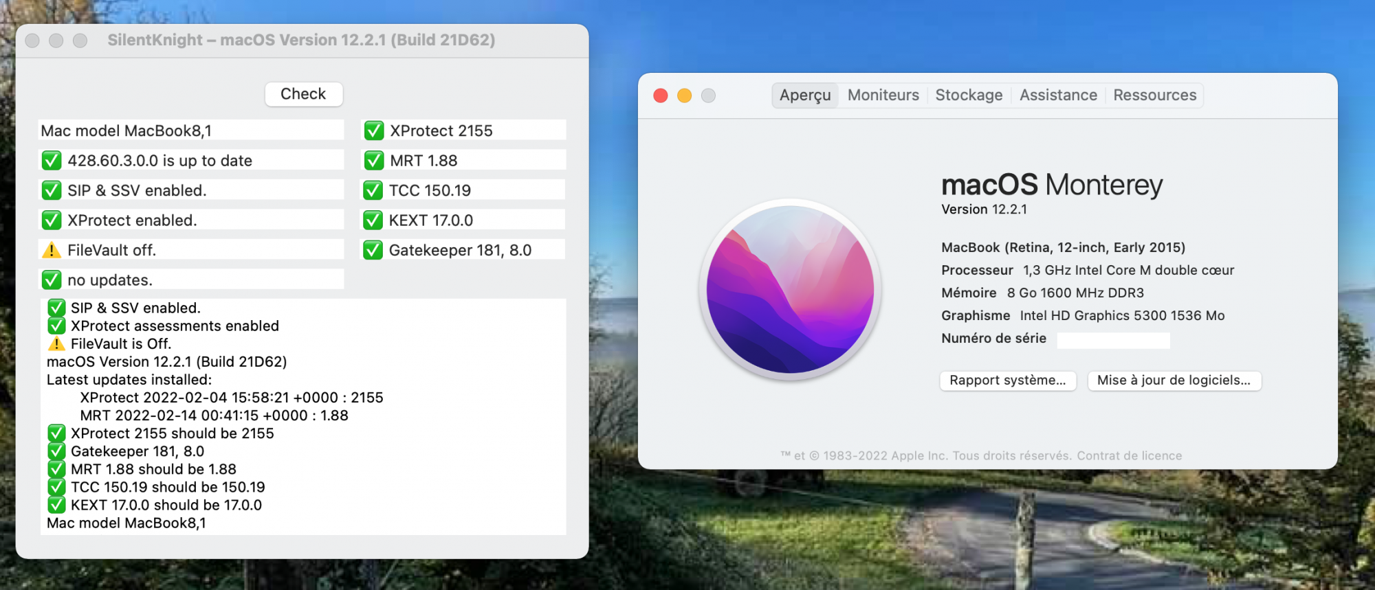

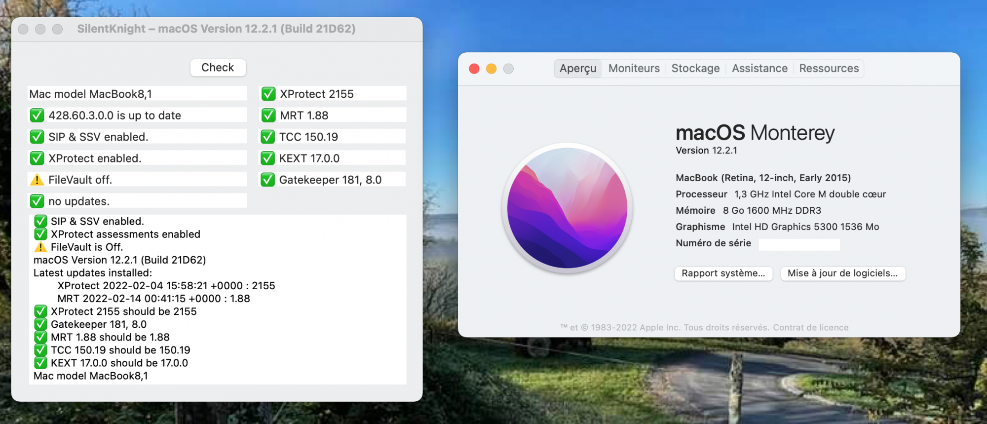

I just updated my macbook 12 " (8,1) firmware that is on Monterey (OCLP EFI, and for which the firmware was not up to date), on an external USB disk on which I installed a Catalina With a USB Catalina key. After the security update the firmware was well updated from 428.40.10.0.0 to 428.60.3.0.0. No NVRAM reset ...
I tried the same thing on my Mac mini late 2012, but the firmware does not want to update.
I actually replaced the internal HD long ago by an SSD ...
I'm trying to install a mojave and update Catalina online to see if it changes something
To follow, these firmware history are complicated :)
And There you go !
My mac mini firmware is up o date 👍🏻
On the Late 2012 Mac Mini 6,2 I went through Mojave installed with a key on an external USB drive, then an update in Catalina online directly offered for the OS Mojave. The firmware of the Mini late 2012 updated well after the security update. I did an NVRAM reset to ensure before updating to Catalina.
I think I could have installed directly from Apple's servers, Catalina on the external USB drive, but hey, let's be crazy :)
I restarted choosing EFI OCLP then Monterey and HOP, I'm home now :)
I just don't know what is SSV 🧐 ??

Finally got the firmware on my rMBP 10,1 from 421.0.0.0.0 to 425.0.0.0.0; after all the updates Silent Knight found no more X's when logged in to Catalina, and just the two expected ones re. SIP/SSV when booted into Monterey/OCLP.
The key to it in my case was a) NVRAM reset, and b) being reminded to use option-boot to bypass the OCLP EFI when reinstalling Catalina from the USB key onto the external OEM SSD. I had forgotten about the option key on boot.
Many thanks to everyone who took the time to shine light on this situation, I continue to learn a lot from you guys. And as someone said earlier, "WhooHoo!"

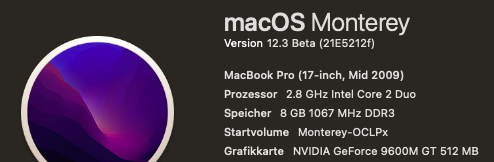

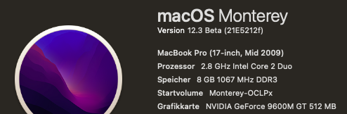

Successful update from 12.3b2 to 12.3b3 OTA fully automatic, system post-install patched by OCLP 0.4.3n, flawless performance, except for BlueTooth Magic Mouse unresponsive for seconds, while websites are loading on Safari and Brave browsers.
Anyways, OCLP is a fine piece of intelligent software by highly ingenious developers and contributors. Thank you, members of this thread, as well.
