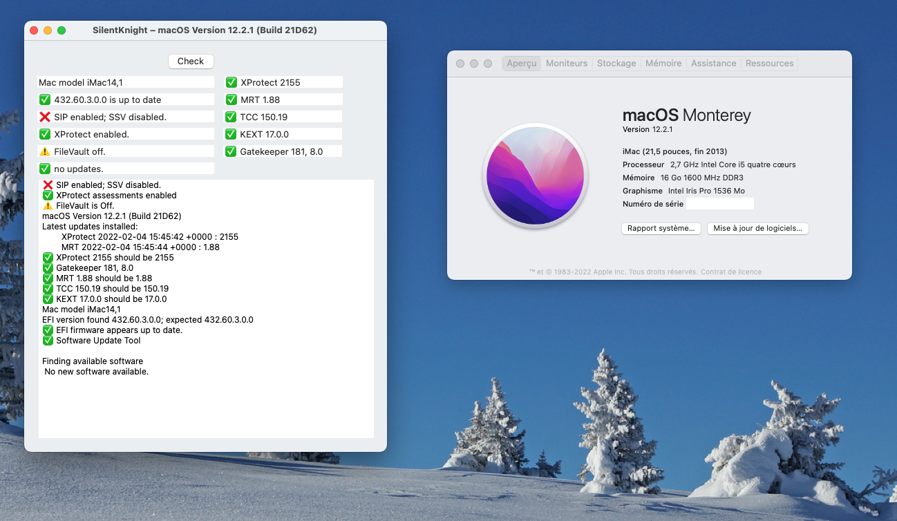

My iMac 21 late 2013 (14,1) firmware is up to date now! 👍🏻
I went through Mojave (same as for my Mac Mini late 2012) installed with a key on an external USB drive, then an update in Catalina online directly offered for the OS Mojave. The firmware of the iMac 21 late 2013 (14,1) updated well after the security update. I did an NVRAM reset to ensure before updating to Catalina.
Small precision, and I do not know why, I have to use a USB 3 hub connecting to one of the USB inputs from the iMac to start the MOJAVE key because it did not appear in the boot picker with the option key.🤔
(I have also a 27" late 2013 (14,2) on Monterey OCLP 0.4.2, but the firmware was already up to date).
Long life to OCLP!👌🏻

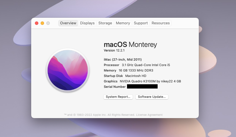

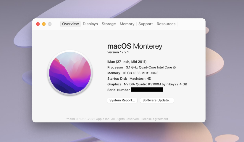

Hello fellow OCLP i have a 2011 iMac 21.5 inch and I have updated to Monterey 12.2.1 and am having problems with the graphics as it seems to glitch on certain parts of the UI. Can anyone help. I have patched it.
Reactions: TimothyR734
iMac2011 Did you change the GPU, if change did you patch?
Yes i upgraded my gpu to K3100M so it needs post install patch, but if you can get your hands on some amd gpus listed on 1st post, you will not need patching. I also would like to get amd gpu but those listed on 1st post are extremely rare here in the Philippines so I just make do with what is available here.

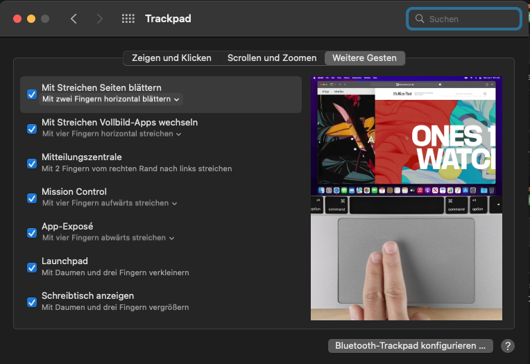

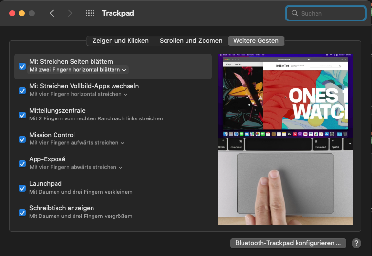

Any idea why 2-finger back/forward in Safari aren't working for me? (12.2, OCLP 0.4.2, MBP6,2)
Setting is of course activated:
I'v had the same problem a while back. K two advised me to check the Discord where I found this solution:
I'd assume you have not upgraded the GPU in your 2011 iMac 21.5". It's normal to see some display glitches due to your non-metal GPU card. For more info, you can have a look "2011 iMac Graphics Card Upgrade" in this forum (not this thread).
Hi :)
Is it possible to paste the solution here, since I have no discord account, so the link doesn’t help?
Thanks in advance!
