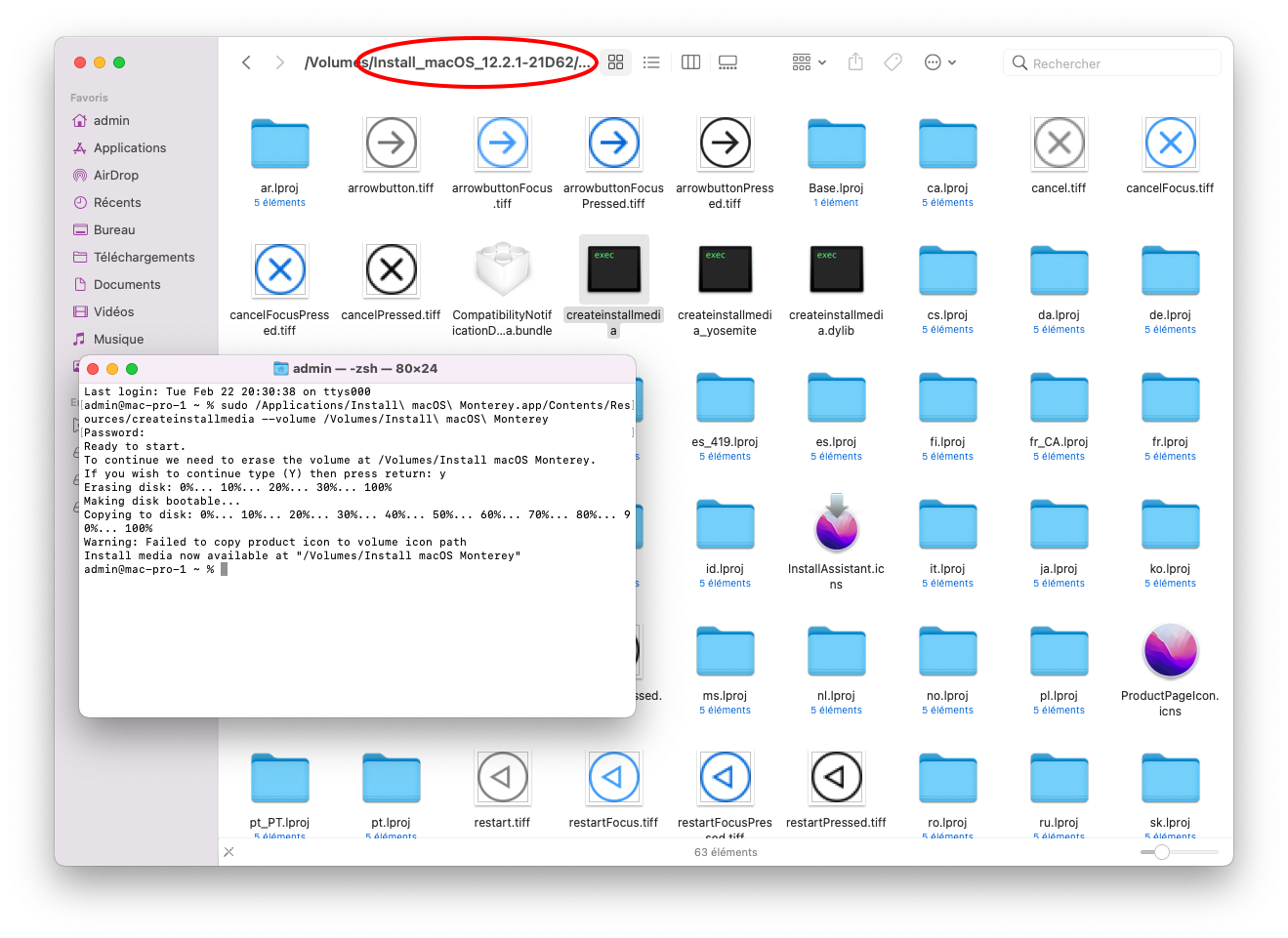

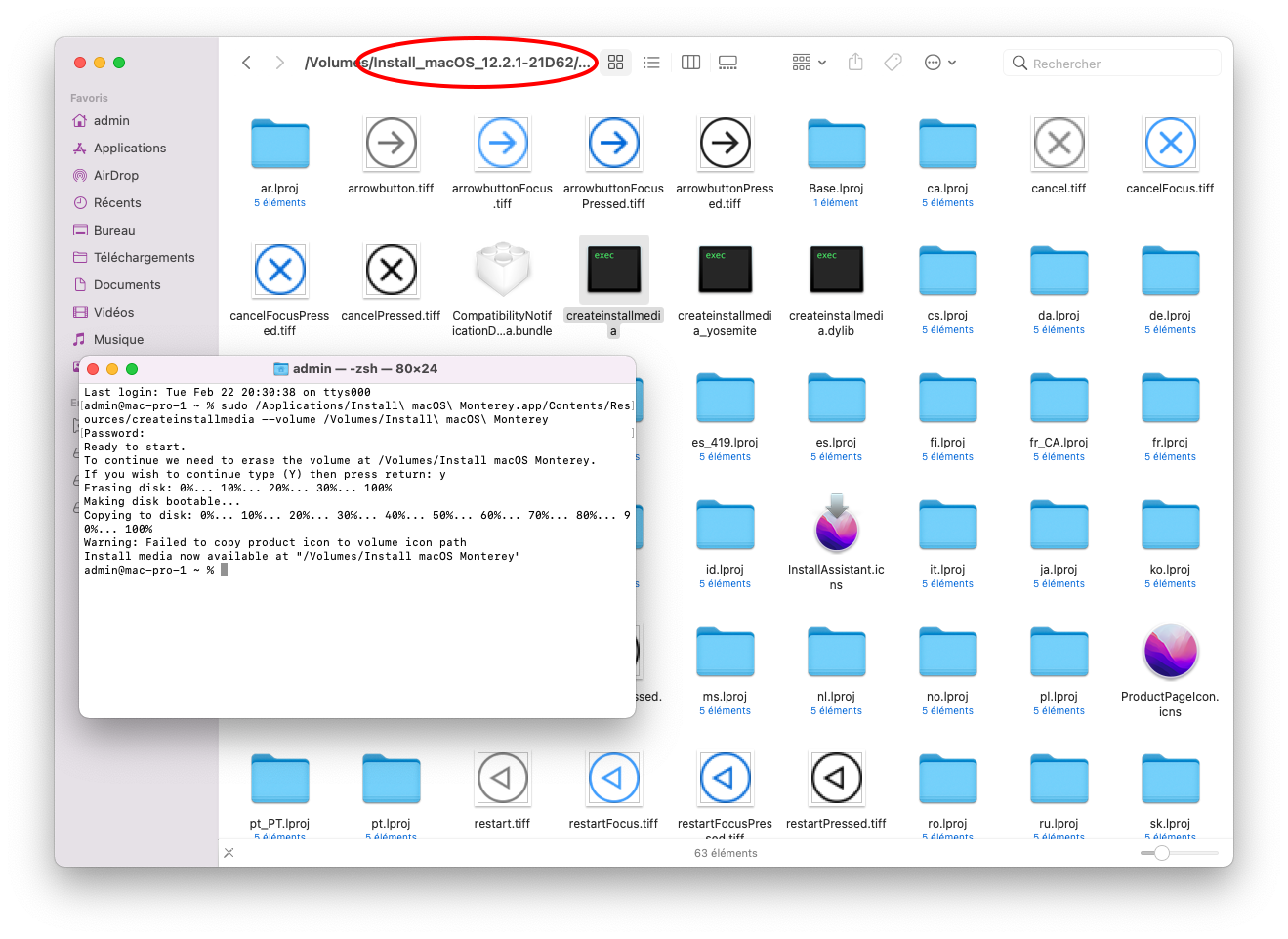

I don't understand, do you mean that there is no longer the possibility to create a USB installer using the Terminal command with "createinstallmedia"
Here it works as always, 12.2.1 downloaded with MDS.app and successfully created a USB installer using "createinstallmedia" contained in "Install macOS Monterey.app"

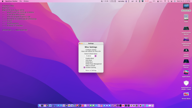

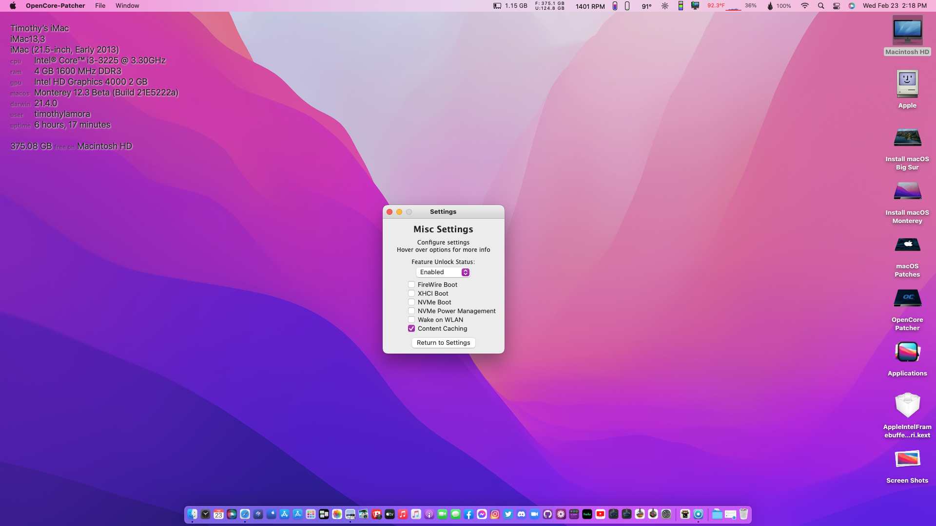

Did you check your OCLP under misc settings to see if the 2 NVMe settings are enabled and work

my suggestion is try it I don't have one in my Mac I saw the settings so maybe it might work on yours since you mentioned NVMe in your post
Yeah its worth a try I guess. I did wonder if this should be enabled. But wondered why it wasn't auto enabled as it had enabled power management itself. Which is ironic as when I had full system crashes, my Mac would be insanely hot and fans going full blast
it was enabled on my iMac as well so I disabled it

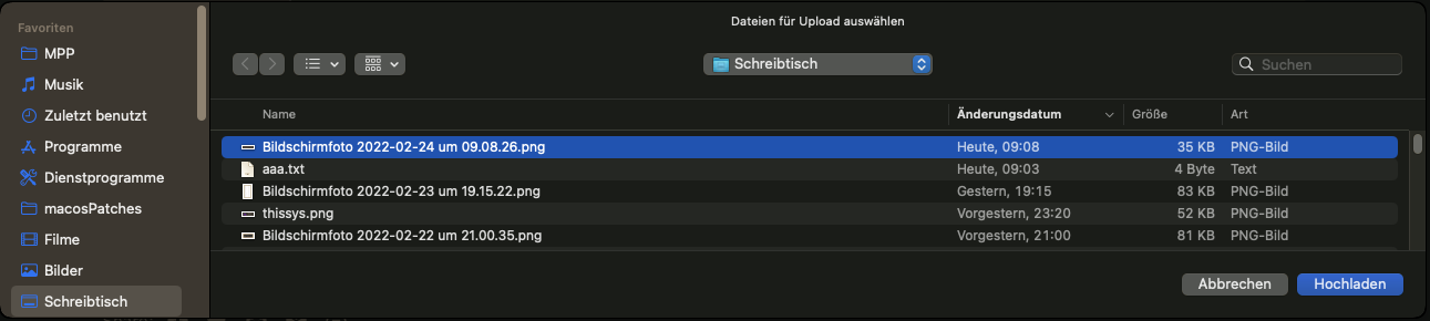

Just have put ASB's latest binaries for SkyLight, CoreDisplay, QuartzCore into my 12.3b4 installation, using Bigsurmountsrw - file save and upload work! Writing from this system. I guess will soon be part of OCLP 0.4.3.
