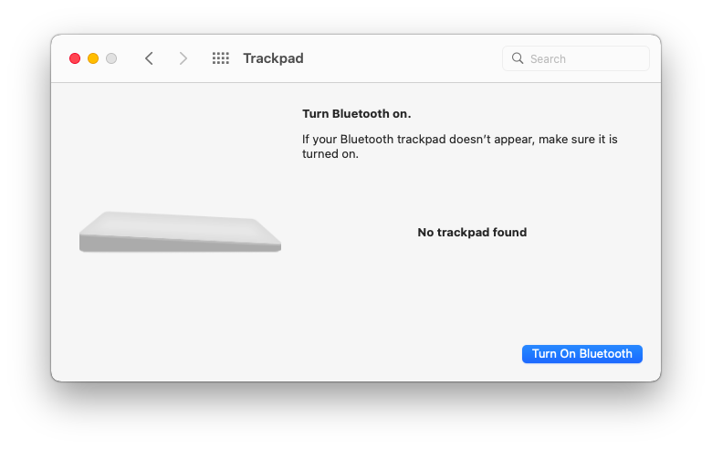

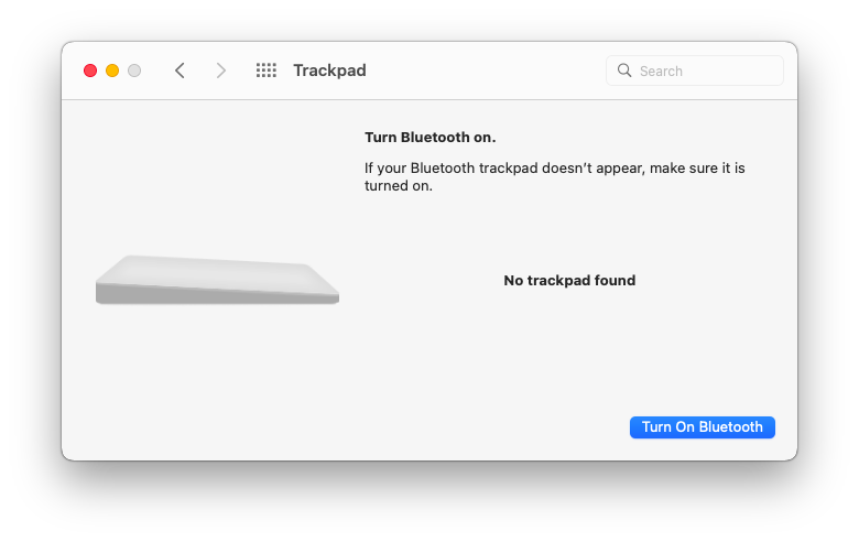

Just installed 12.3 beta, only major issue is trackpad. It's not working at all. Anyone on facing similar issue on MacBook 5,1 or other devices? Do we have any patch or something for it?
