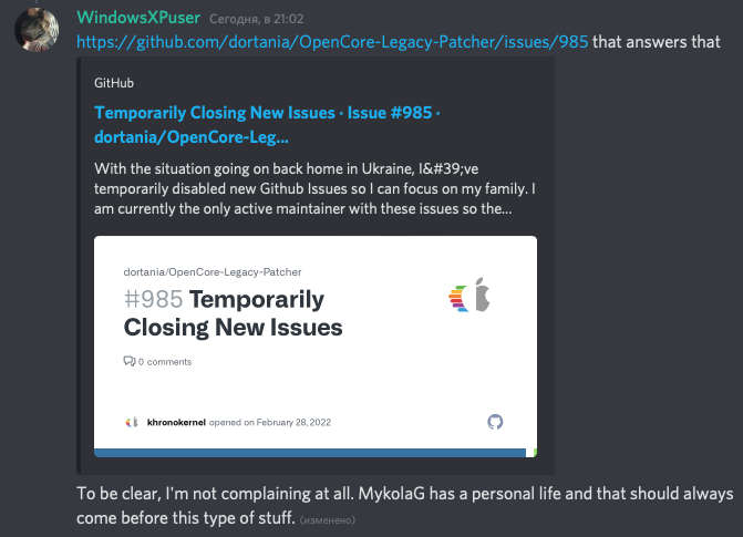

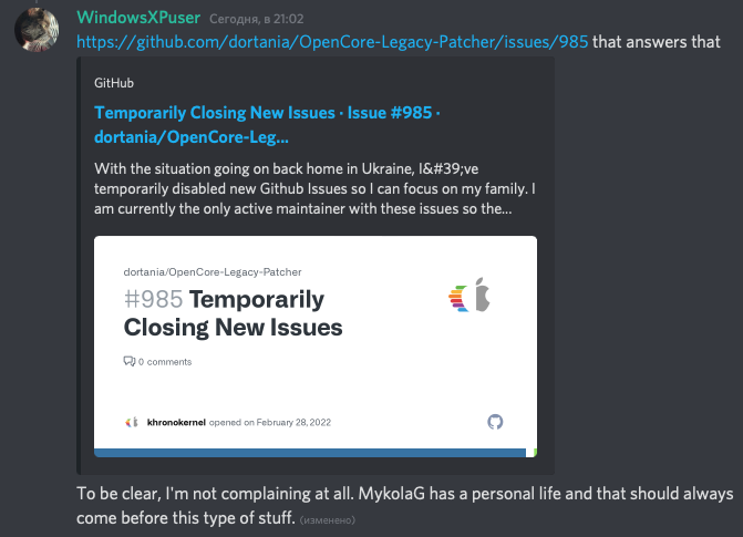

Some very bad news! :eek: OCLP has become a victim of Russian aggression. Development will cease indefinitely. Read about it on Discord. 👀
if you reread discord, I think you used the word indefinitely incorrectly.
The statement indicated temporarily as they are dealing with family issue's.
none the less it is very sad news on both fronts

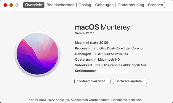

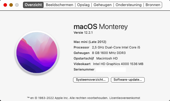

Just wanting to thank the developers for making it possible to run Monterey on most cheap Intel Macs I can buy for about €200. With two drives, my Mac mini has 2TB of storage, something which would have cost me a fortune on my MacBook Air.
Everything works fine for the most part. I only had these small issues:
1. Sometimes the machine gets stuck in the boot process, although turning it off and restarting always seems to fix it.
2. I have never been able to get Boot Camp working with OpenCore and I simply gave up on it.
3. My microphone (Line-In) port does not seem to function.
It is sad to see how Apple simply abandons older hardware. If you can run Monterey on a 2014 Mac mini with 4GB of RAM, why would it not work on a high end Mac mini from 2012 or 2011?
