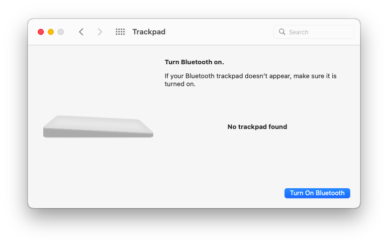

Just to confirm, it was that 'no battery' issue, after editing 'com.apple.AppleMultitouchTrackpad.plist', it's working fine.Just installed 12.3 beta, only major issue is trackpad. It's not working at all. Anyone on facing similar issue on MacBook 5,1 or other devices? Do we have any patch or something for it?View attachment 1965691
Try install to new partition and use Migration Assistant to move files from old install?Looking to see if anyone has has success running 12.3 beta* on a flashed MacPro4,1 > upgraded to 5,1.

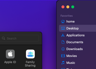

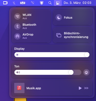

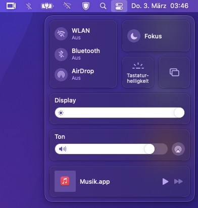

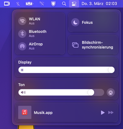

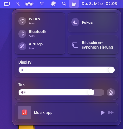

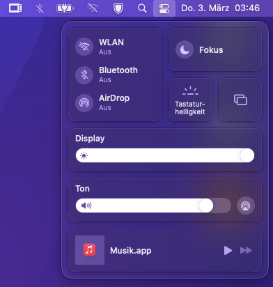

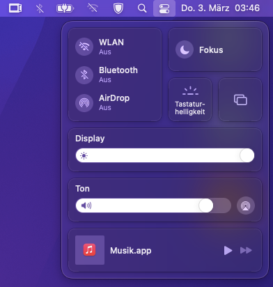

Using the new 0.4.3n post-install patches now also in Big Sur. There I don't see these differences - transparency looks OK. May be also due to my rather low-key screen backgrounds.On Monterey 12.3Beta5 with current OCLP 0.4.3n Menu Bar transparency and Control Center do look different compared to 12.3Beta3 version of SkyLightOld.dylib, or is it just on my machine? (MBP4,1 15-inch)
Maybe @ASentientBot can have a look into it, but anyhow, many thanks for providing these framework fixes and many other essential components, in the first place!
First screenshot shows Menu Bar and Control Center of Beta5, 2nd is also Beta5, but with SkyLightOld.dylib from Beta3:
View attachment 1967461View attachment 1967462

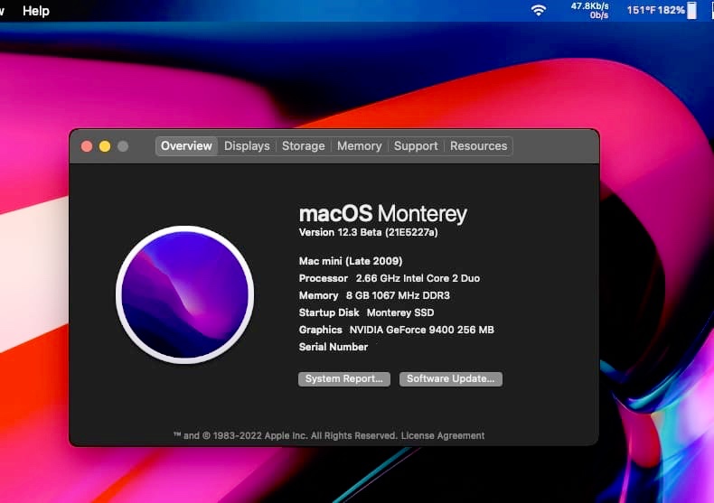

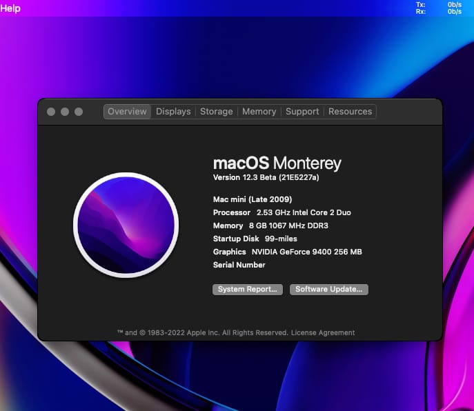

Running 12.3 beta 4 without issues on a 6 core and a 12 core, both with Radeon VEGA RX 64, booting from NVME SSD.Looking to see if anyone has has success running 12.3 beta* on a flashed MacPro4,1 > upgraded to 5,1.
I attempted a Monterey install a week ago, got stuck on an endless boot loop until I downgraded to 11.6.4. While this feels "stabile", I would like to explore the new build of Blender 3.2 which supports GPU rendering, but AMD GPUs are only supported in Monterey 12.3.
Using Radeon 5100 and Sapphire RX580 Sapphire GPUs.

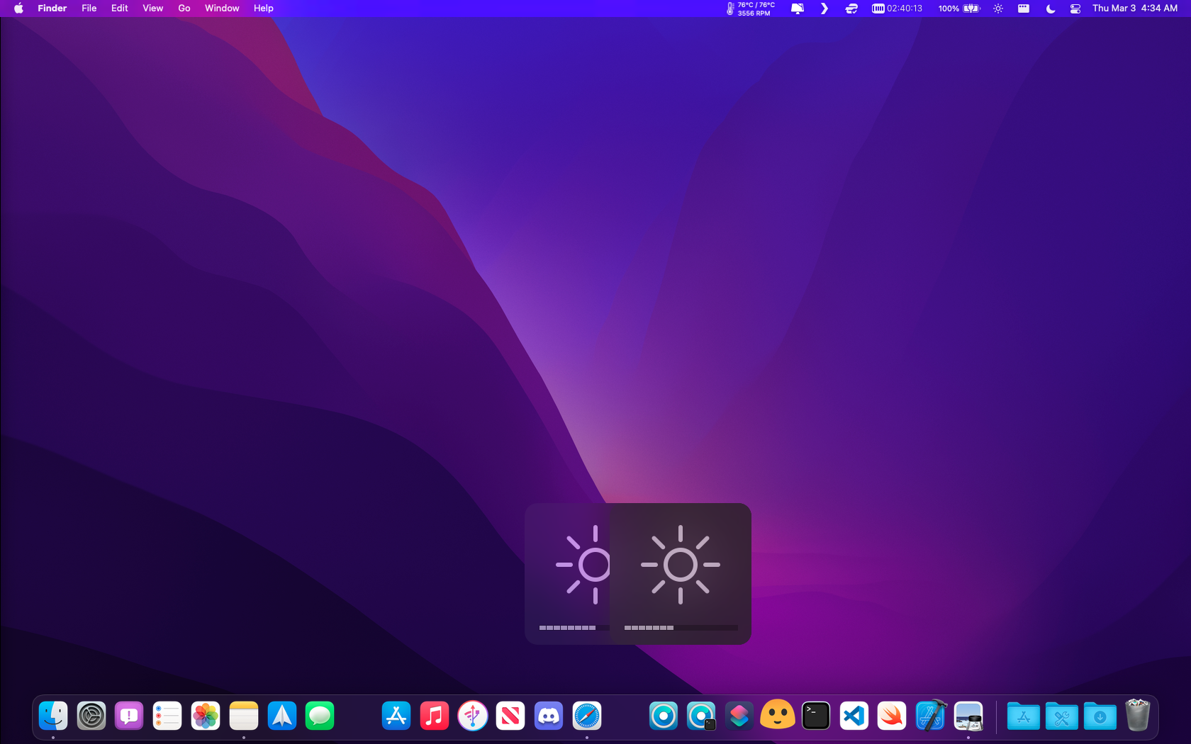

Yes the Keyboard Backlight control button does work for me (with SkyLightOld.dylib from volume patched Beta3), also the standard keyboard keys for that function do work as well (regardless of which dylib is used, that is if I recall that right from my memory).But regarding the keyboard backlight control which isn't shown in your left picture, does this work nevertheless? In my case, it started working only after the 2nd reboot after having applied the post-install patches (in Monterey as well as in Big Sur).
