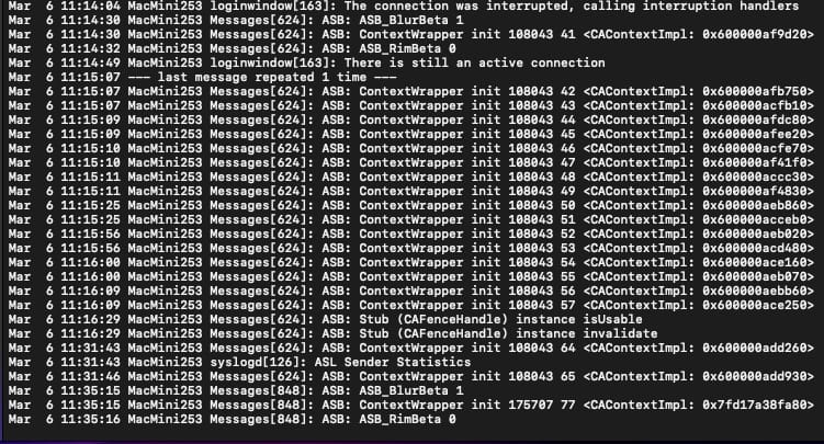

🪓Mini3,1 w/macOS 12.3b5>OCLP_043nTUI offline variant - the "Messages crashing after 20 minutes bug" is back.💣 macOS 12.2.1 Messages v.14 also crashes after 20 minutes. 💣 System log gave this, attached -
ASB🟢 might want to look into this?;)

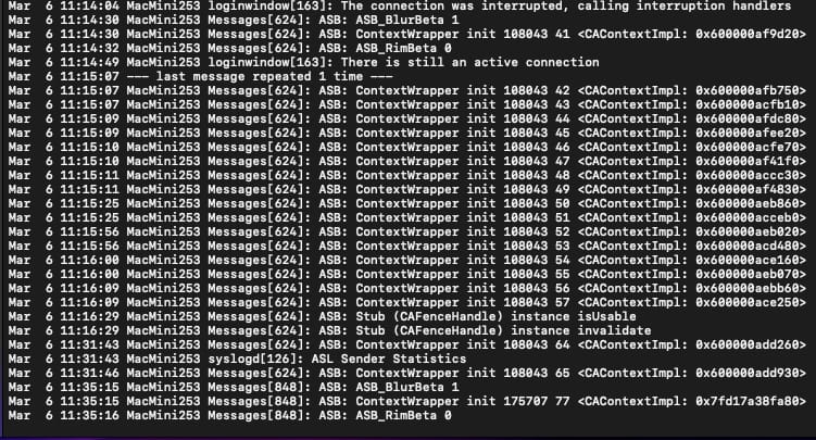

This is always the case after the fix for the “Catalyst Scroll” issue, even on the latest Big Sur with the latest OCLP nightly build on my non-metal 2009 iMac. I suspect this has become the same issue as the default maps, News etc.
Reactions: hvds
Looking at the log, clearly BlurBeta which pre-dates the Catalyst Scrolling fix by a month or two is implicated. ASentientBot aka ASB or 🟢 has been working on the Legacy Video Patches, hopefully this is on his plate? 🤷‍♂️

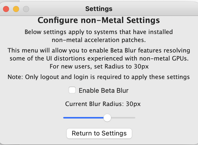

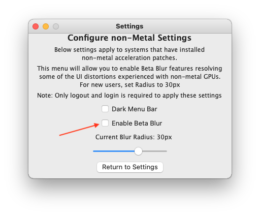

If this is the case, can you disable the "BlurBeta" feature in OCLP to see if it makes any difference?
Update: Just tried by disabling the OCLP v0.4.3n "BlurBeta" feature running Big Sur 11.6.5(20G525) on my non-metal 2009 iMac. The Messages app still crashes every 20 minutes.
Reactions: K two
Please describe how to "turn-off" BlurBeta? Serious question.👀

That feature is not in the TUI. BlurBeta was set once with the Terminal after an early beta as a test with ASB🟢. Persists to this day. Never used the GUI which obviously has bugs. Still looking for the Terminal cmd to actually remove the function and confirm. 👀 defaults write -g ASB_BlurBeta -bool false Nope, Messages crashes still there.
The GUI has been re-developed lately and shares code and functionality with the TUI (exceptions are possible). I am still using the TUI because I wrote some simple scripts to generate configs from a single machine for different target systems.
