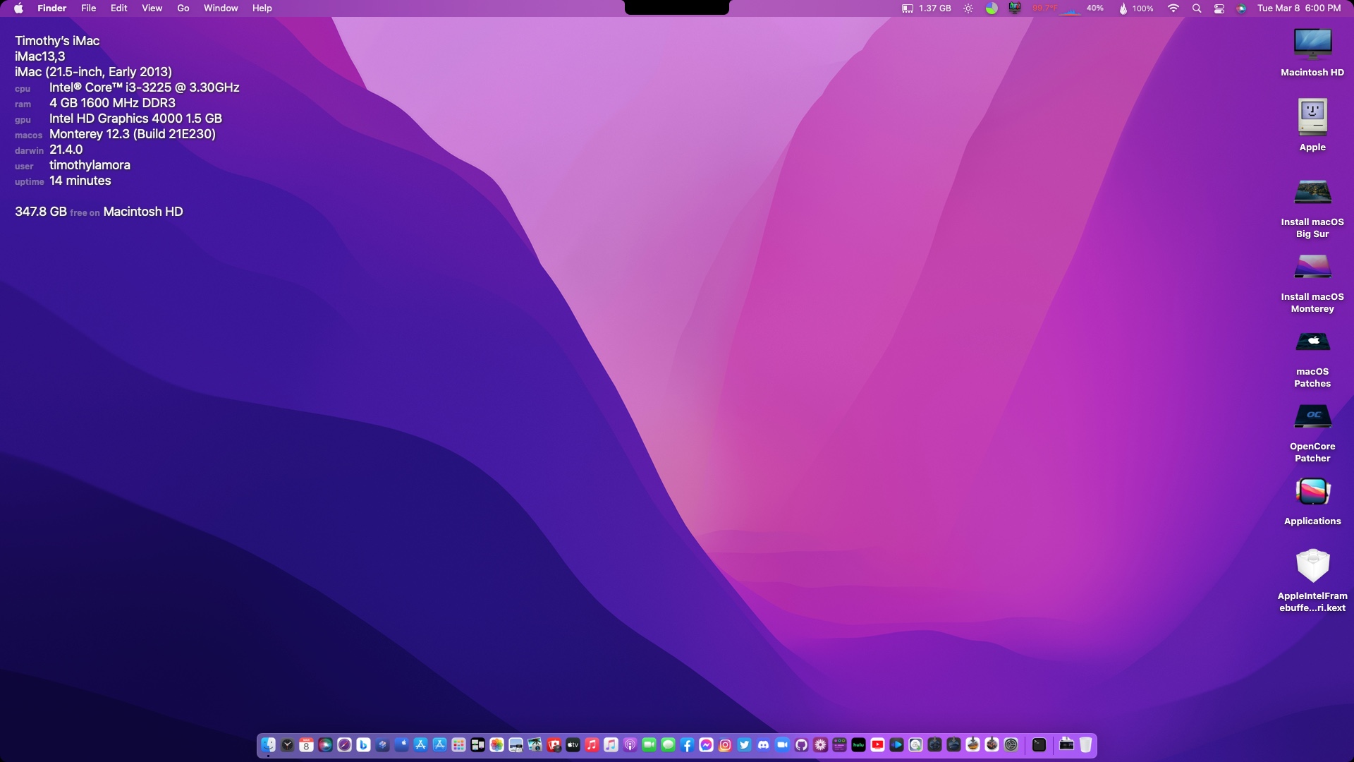

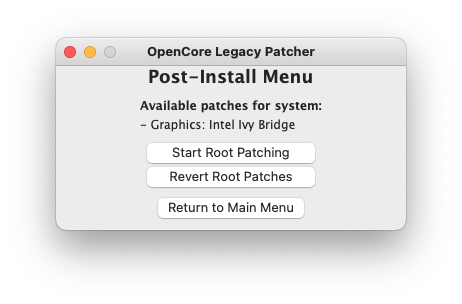

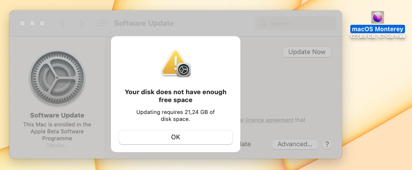

As FYI: OCLP 0.4.3n Cant revert rootpatches. No effect after restart. Also:OTA fails with insufficient space left error. Deleting time machine snapshots did not solve the issue. Creating a new 10GB .dmg file triggered MacOS to recalculate remaining space though. OTA installation went through just fine after that.

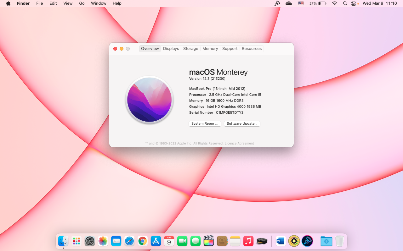

Hey guys! All great after updating my MBP 9,2 mid 2012 non-retina OTA to macOS Monterey 12.3 using OCLP 0.2.5. Everything works great. Have a good one everyone!
Out of cuiosity: Are there any graphical issues left in the build you just installed on your machine?
