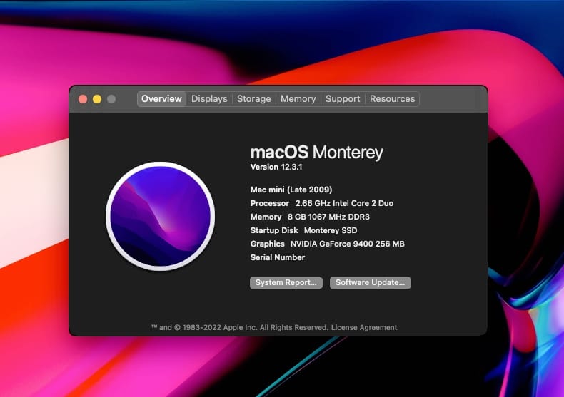

MBP5,2: installed 12.3.1 over 12.3 OTA, using OCLP 0.4.3 including for post-install volume patches.
Smooth updating, result looks fine.

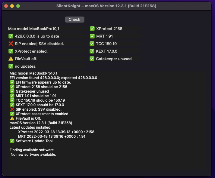

You need an external USB drive or external SSD drive, install Catalina 10.15.7 on that. It will update the firmware on your m/c; on mine it took me from f/w version 425.0.0.0.0 up to 426.0.0.0.0
To find out what firmware you should be running on your m/c search for 'SilentKnight', read all about it, download, install and run it. Highly recommended, screenshot below.
