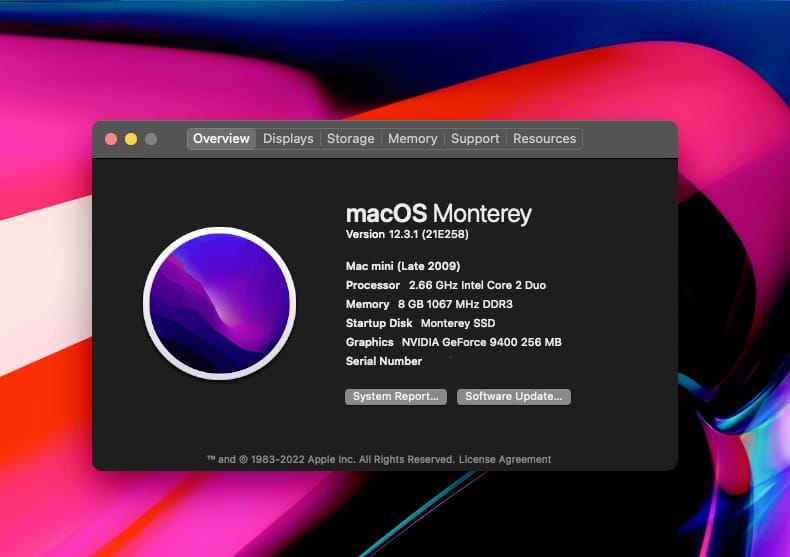

Smooth update from 12.3. to 12.3.1, OCLP 0.4.3, and patch installs; very good performance of all apps. I also did an update FW to 426.0.0.0.0 from 425.0.0.0.0 on my MBP 2012 (9,1) via external drive partitioned for a Basic Catalina install with updated security updates that got me to 426.0.0.0.0. confirmed by Silent Knight. I tried the USB installer as suggested bt ******* but didn't update FW. Most likely human error on my part. I will try again on next FW update if any.

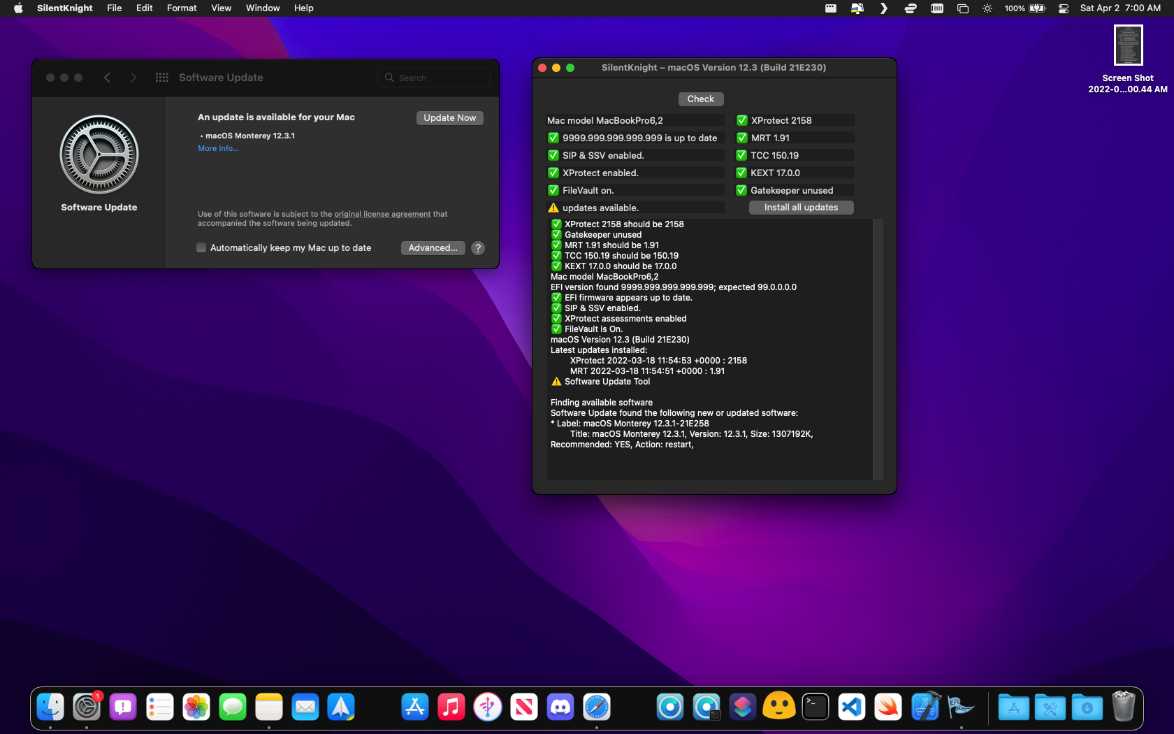

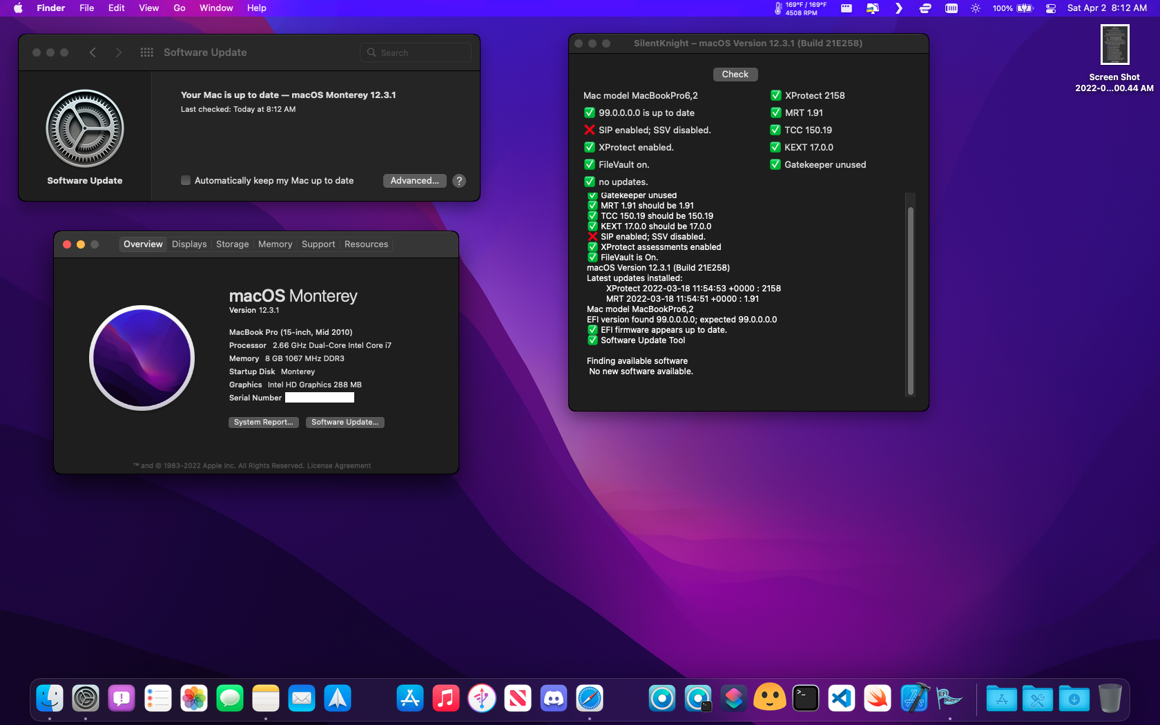

So I'm confused as to why I'm not receiving updates. I've reverted root patches, fully enabled SIP, restarted and it still won't see the 12.3.1 update. Thoughts? Thank you.

What is the spoofing level?
If I am not wrong, spoof-less at this point means you don't get updates - something about a bug with VM method of spoof-less.
Try setting to minimal spoofing and see if the update shows up.
Never messed with the spoofing before, but I set to minimal, rebuilt and installed. Rebooted. Still nothing.

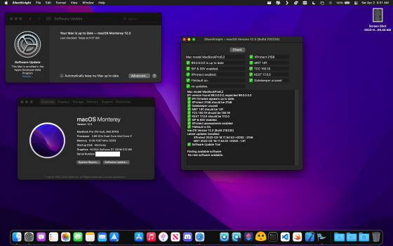

UPDATE: So I didn't change anything from last post. But it seems that i had to unenroll from the mac beta program in the software update screen. As soon as that went through I got the update.

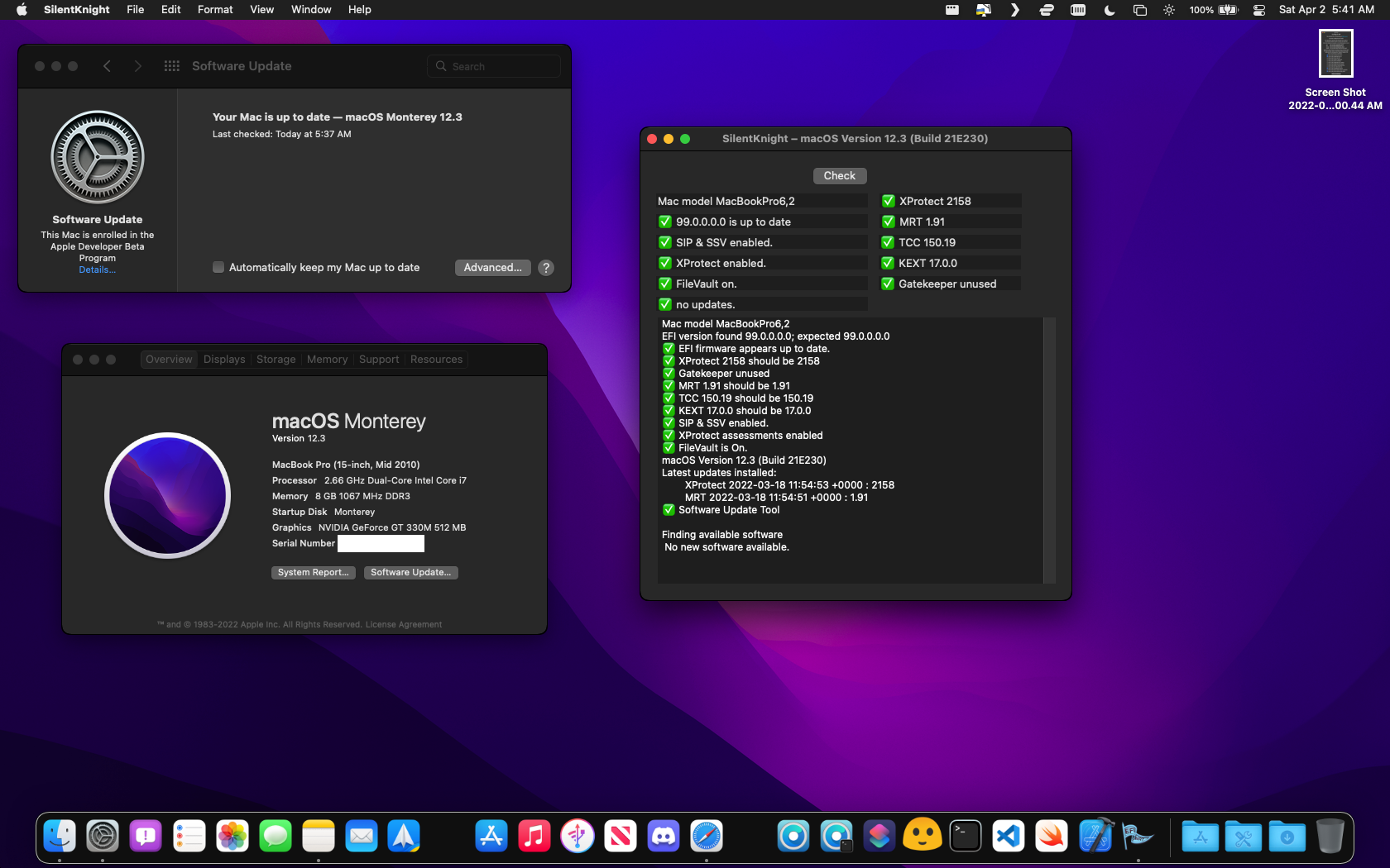

Reporting back. So this is new 😂
You were on beta? And now you want to run latest public release?
Hmnn, have always thought you need to reinstall macOS going from beta to public release.
Could be wrong, someone else can comment on what works.

I was in the beta program yes. I unenrolled, reverted all OCLP setting to default, minus showing picker.
Rebooted and now it’s processing the update now. Will report back once I go through the post install.
Maybe going from 12.3 RC to 12.3.1 is different?

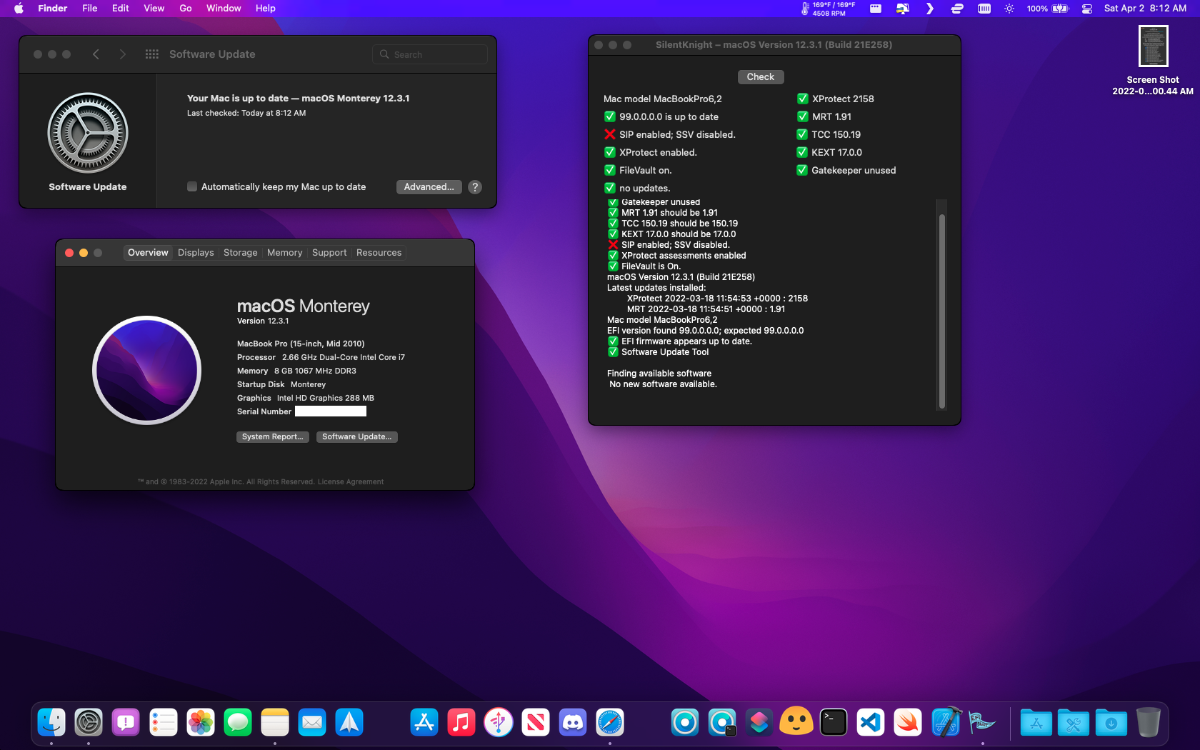

UPDATE:
It appears we're all good here 👍

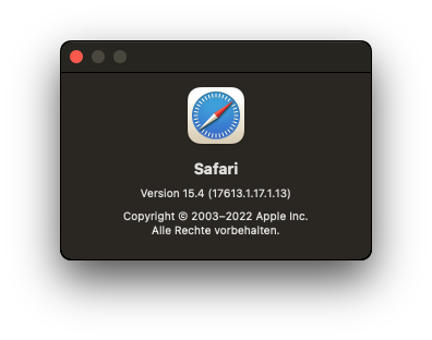

just tried to reproduce this on my 12.3.1 installation, using OCLP 0.4.3 (default settings). But Safari behaved normally, no logout.

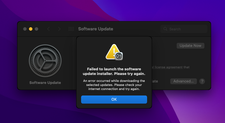

Tried today to update from 12.3 release to 12.3.1 release on an external ssd with enrolment for betas. 12.3.1 did not show. Meanwhile updated to 12.3.1 from the InstallAssistant.pkg (to test also this).
Before, did the upgrade from 12.3 to 12.3.1 on the internal SSD which has no enrolment to betas, and there the 12.3.1 showed, so updated this OTA.
Both with OCLP 0.4.3, standard settings.
So this confirms your observation, but I don't remember it was like this with earlier updates.
