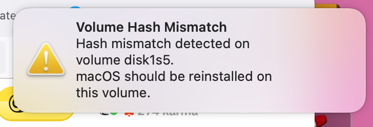

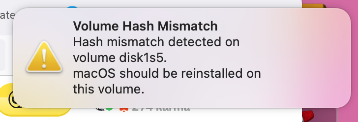

Uh oh! Never seen this before. OCLP on 2014 13'' MacBook Pro. Should I be concerned? Can I fix this? Can I ignore it? Have yet to reboot the machine.. hopefully it comes back up! No concern on data loss as it's a new machine to me. DriveDX reports the disk to be in good health.

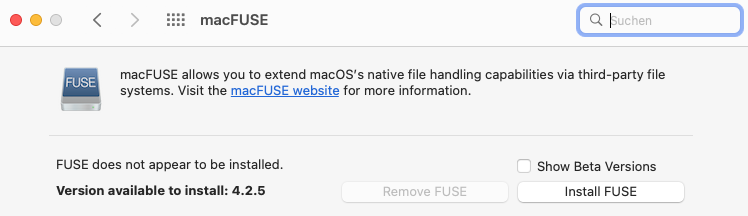

After updating to 12.4 macFuse doesn't work on my non-metal MBP8.1 any more. I use this extension in combination with Cryptomator. The preference pane proposes to install (what I had tried), but after the installation process, nothing has changed.
It's been there since macOS 12 beta 1 and no fix for it till now, been said that it happens with certain models only (Not Sure).
Should you be concern, NO as no data loss or any harm whatsoever have been reported so far.
Just ignore it till there is a fix, Apple does not fix bugs instead they come out with a new OS without the bug, So hopefully the next macOS will come without this bug.
I was seeing this on the same machine, I turned off the 'unlock features' setting in OCLP and I never see it anymore.
