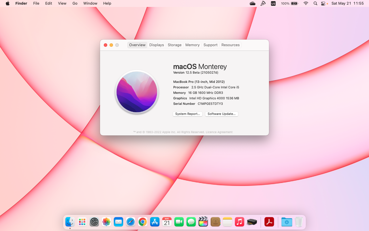

Hi everyone, just finished updating OTA my MBP 9,2 mid 2012 non-retina to macOS Monterey 12.5 Beta 1 using OCPL 0.2.5 and everything works great! Have a great one!
