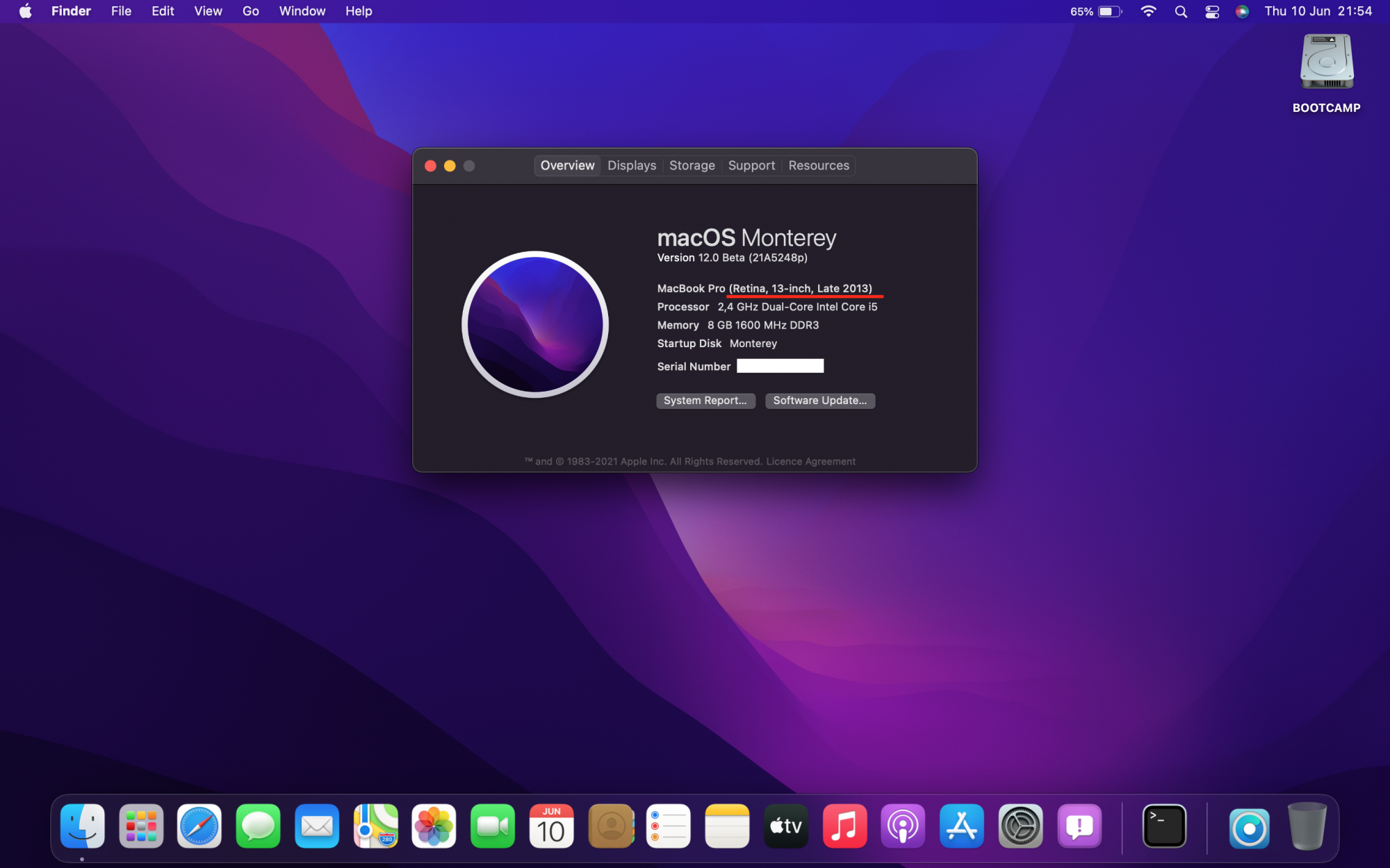

For eg, I did some absurd experimentation to finally run unsupported Bootcamp version to run unsupported Win11 on a partition on 2010 MacBook Pro running supported High Sierra.
All working well now, so it stays like that, not fiddling with it some more, lol.
I was about to try that, was going to downgrade to an earlier MacOS version from 2017 or something, install bootcamp from there and then upgrade again to Monterey, when Monterey randomly finally decided to make bootcamp work. So I didn't have to go that far.

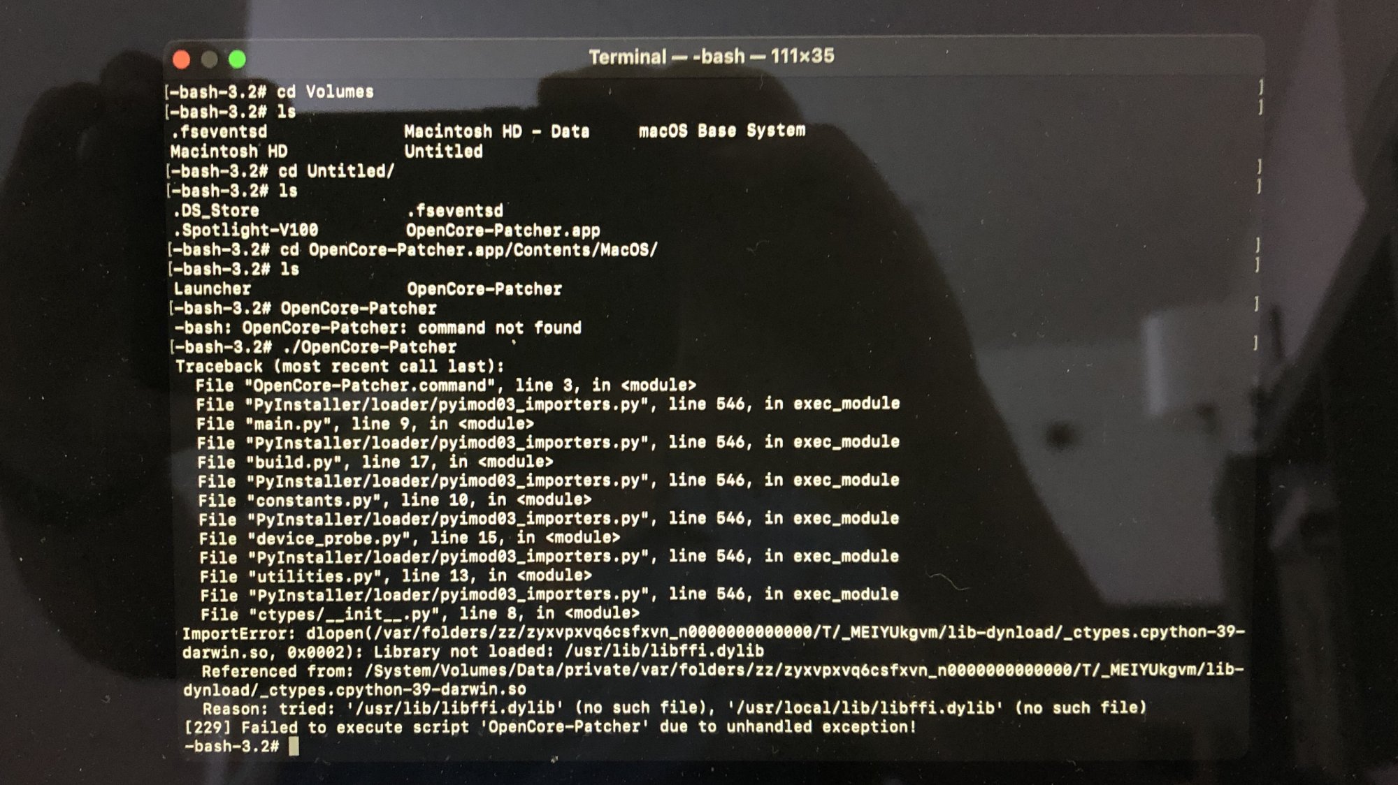

Well, I just tried and it's not that simple. I am afraid we were too optimistic with the idea of running the patcher from Recovery (hence "theoretically" in my post).
Unfortunately, the Recovery environment does not contain all the libraries needed for the Patcher to run:
As for now, it seems not possible.
(BTW @******* - the exact command was cd /Volumes/usbname/OpenCore-Patcher.app/Contents/MacOS/ and then ./OpenCore-Patcher ;) )
Hi everyone, is there a way to install opencore patcher from Terminal in recovery mode?
I hadn't got round to testing, and didn't think it was worth speculating - correctly as it turns out - that it probably wouldn't run in Recovery. The (positive!) reason for this additional comment is that you asked if it was possible to install OCLP-configured OpenCore in Recovery mode. Yes - if you have another Mac (and you know all the settings for your Mac) or if your Mac can still boot in normal mode. You can run OCLP not in Recovery mode, ask it to write to a non-standard output directory, e.g. a USB, then install by copying those files into the right place (e.g. onto your ESP) in Recovery mode.
Yupp, exactly. I may only add that booting from said USB by pressing "C" on startup and choosing "Recovery HD" from OpenCore picker would help. Obviously the config.plist must contain:
Code:
<key>HideAuxiliary</key>
            <false/>
... or you can just press space ... !
Reactions: hwojtek
