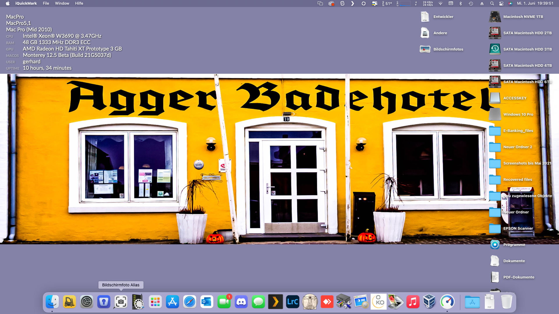

MBP4,1 Early 2008 17-inch -- successfully updated from 12.5b1 to 12.5b2 via OCLP 0.4.6n of today June 1st.
Will report, if and which flaws occur. the latest changes khronokernel has made to OCLP solved a harsh problem of system crashes that persisted trough all betas of 12.3, 12.4 and 12.5. the only stable version being 12.3.1, thus the back port by khronokernel of libs. I cannot thank him enough for his outstanding work, helping us all out.

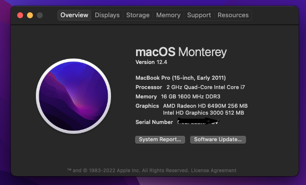

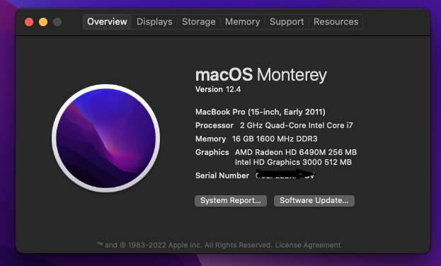

This morning I had the full screen on my 2011 MBP 8,2 with OCLP 4.5 on 12.4 screen turn red all of a sudden. After I rebooted I noticed my AMD dgpu was listed - I had not noticed that before but I don't always check.
A few versions and OS updates back I had disabled it via nvram. Not to clear on how or when it came back and if that was the cause of the red screen. The MBP seems to be running fine now however should I disable the dgpu again? Are there any other setting in OCLP developer I should enable or disable. Thanks!

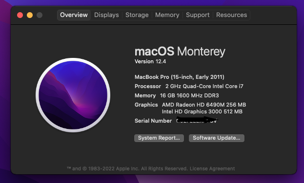

This morning I had the full screen on my 2011 MBP 8,2 with OCLP 4.5 on 12.4 screen turn red all of a sudden. I went to reboot and noticed my AMD dgpu was listed - I not noticed that lately but I don't always check.
The NVRAM entries will go away after a single NVRAM (PRAM) reset. So in case you are not sure if the (known to fail) AMD 6490 is still working properly disable it and keep it disabled on the long run. Guess the OCLP guide explains how to maintain this.

I went ahead and disabled it again - just not sure how it changed or got wiped out from nvram on its own since I had not done it - the laptop is just kept on and open all the time with the screen saver on when not in use. I have just simply rebooted a few times since 12.4 and OCLP 4.5 update. Also, I never tried any other OS on this laptop - just went from High Sierra to Monterey - very happy with it by the way.
