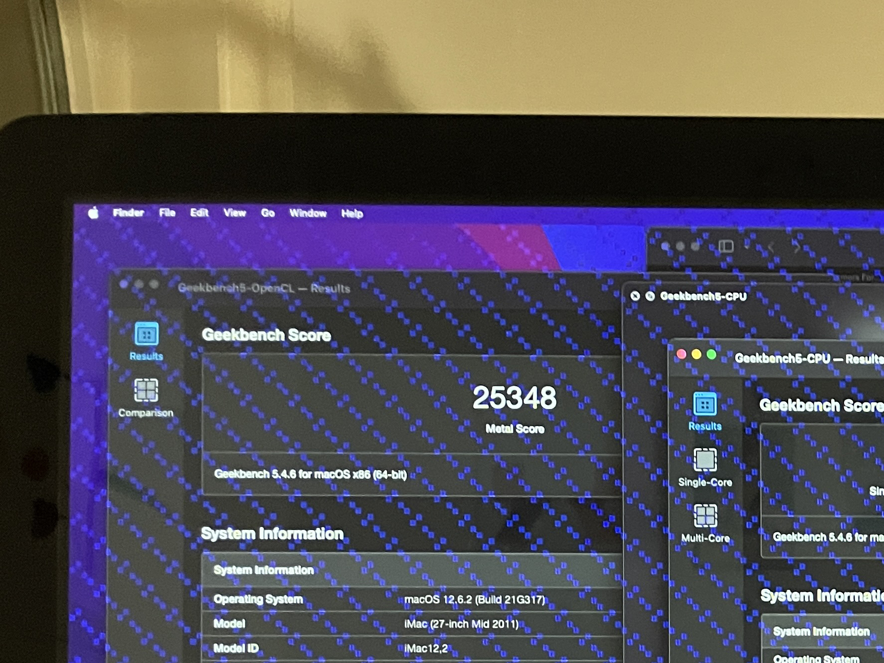

I just completed a fresh install of Monterey on an iMac 2011 WX7100. After major troubles with a non-working brand new USB-stick, everything went fine. I had to jump right from High Sierra to Monterey 12.6.2 and used OCLP 0.4.11, which is the most recent version relevant to my machine.
Monterey works flawlessly! Everything is smooth!!!
But before continuing to setup this new machine and installing everything, I wanted to verify some drops in benchmarks I noticed. I am not concerned, because everything works perfectly. A slight reduction might even be expected, but I remembered a video, which I encountered when researching this upgrade, where a fresh install on a Mac Pro 5.1 produced a drop in GPU performance of about 30%, whereas an install above Big Sur saw no reduction in performance. When I ran the benchmarks after my install I remembered the research carried out by the author in this YouTube video. (link to the relative section in the video)
High SierraMonterey 12.6.2
Geekbench5 CPU734 / 2666678 / 2217
Geekbench5 OpenCL40.74825.821
Geekbench5 MetalGB5 metal benchmark crashes27.027
Valley fps / score69.8 / 292157.5 / 2406
Can anyone confirm my values?
In case your values are different: How did you get to Monterey? Erase/install? Install above Big Sur?
Again the performance is more than enough for this machine and for Monterey on this machine, but since I would like to conclude my upgrade voyage with a comparison in a post, I decided to double check my findings.

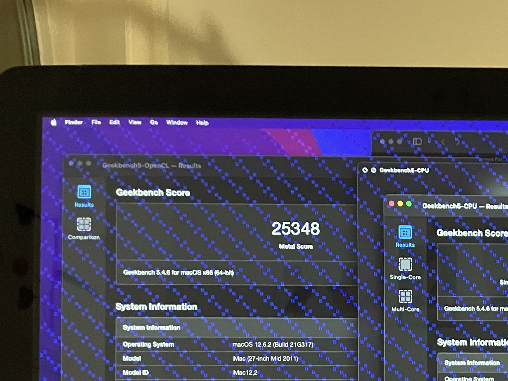

Send the system to sleep and compare pre-sleep with post-sleep results.
Check the tables linked on the first post of the GPU thread to compare results yourself.
Add your high scores to the same tables.
Valley drop seems reasonable, metal not.
Hint: Connect an external display and redo all benchmarks!
Thanks for the hints. I had already compared the Valley results, but had a discrepancy, which I could not explain. Sending the system to sleep magically let the values rise. Apparently taking a short nap has the same effect to this iMac as it does to me ;0)
High SierraMonterey 12.6.212.6.2 after sleep12.6.2 after sleep+2.disp
Geekbench5 CPU734 / 2.666678 / 2.217714 / 2.603742 / 2.753
Geekbench5 OpenCL40.74825.82140.84740.713
Geekbench5 MetalGB5 metal benchmark crashes27.02742.59444.589
Valley fps / score69,8 / 2.92157,5 / 2.40663,1 / 263860 / 2512
The values are now in line, with what I expected.
This saves me from doing the experiment to do a Big Sur erase/install and Monterey install to find out, if the video has a point or not.
Obviously I will upload all values in the iMac 2011 GPU Upgrade thread. I will also prepare a comprehensive post in the same thread documenting the performance of the whole upgrade (hardware + software) in comparison with other systems I can get a hold on. I feel more comfortable now to write this post with these values.

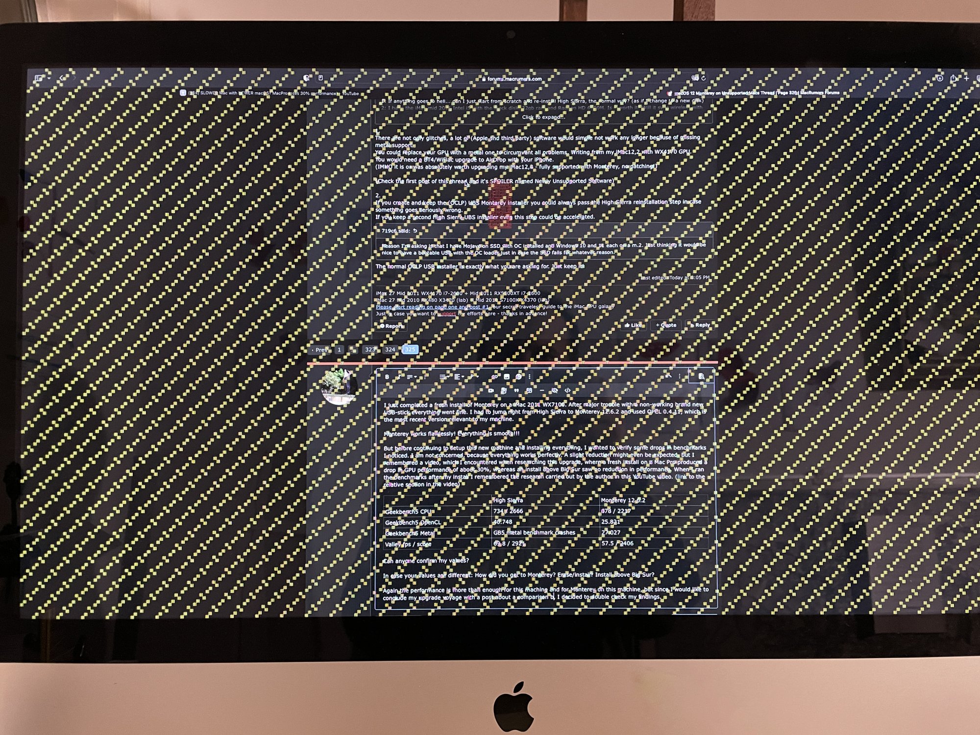

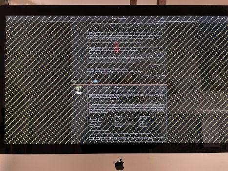

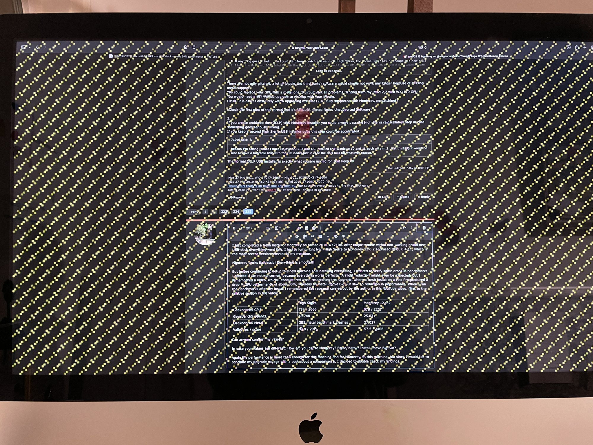

After solving the benchmark issue I would like to troubleshoot hopefully the last thing I encountered upon my path of upgrading this 2011 iMac. Yesterday, when writing my post about the strange benchmarking values, the UI froze and displayed a strange yellow pattern. I could still move the mouse, music continued playing, but the UI had become non responsive. I had to press the power button to force a restart.
After that the computer worked. After some time, when rerunning the benchmarks, the same thing happened, but with a blue pattern.
After a force restart everything worked without issues for several hours until I shut the computer down.
This morning, when turning the computer on, for 5-6 times I had the same experience: the blue pattern appeared and the UI froze almost immediately after login into the system.
What does this depend on (GPU, Monterey, OCLP, an app misbehaving?) and how could I solve this?
It is currently only Monterey 12.6.2 + the Safari 16.1 update. I had Safari, Geekbench 5 as well and Plexamp open when the crashes happened.
