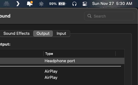

AppleALC 1.6.3 (last used in OCLP 0.5.1) is the last version that enabled the audio jack correctly on my machine. I did do some trouble shooting and worked my way backwards from the newest version (1.7.6), backwards to 1.6.3.
Steps taken:
  1. Mounting EFI. (diskutil list, diskutil mount /dev/disk0s1 (your volume may vary)).
  2. Replace file (only replacing AppleALC.kext).
  3. Rebooting every time.
  4. Repeat until I have audio port sound. Gaining sound should also change your status bar icon.
Hope this helps, and thank you @armanism for that rabbit hole I went down 👍

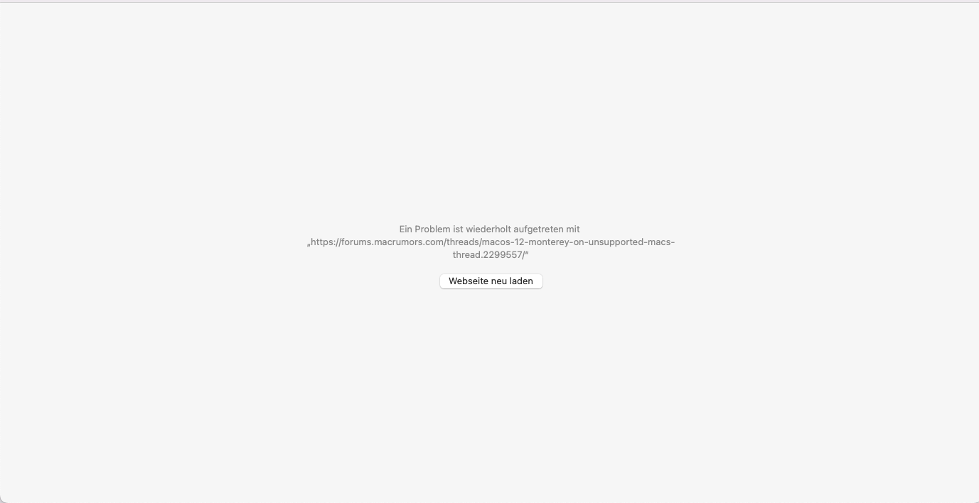

I have just updated my Imac12.1 to MacOS 12.6.1 and Safari 16.1 and OCLP 0.5.2. Safari is crashing and giving me the attached fail message. Anyone the same experience?
How it translates to English? May have the same problem too with some sites (brew.sh i.e)
First Safari tries to reload the page. After second attempt is says "A problem occured repeatedly with page xyz... and a shows a button "reload page ""
I get the same problem with some websites, Monterey 12.6.1 with Safari 16.1 on my MacPro3,1. It didn't happen with earlier Safari version. You can temporarily disable JavaScript (in Safari Security settings) to load the webpage.
