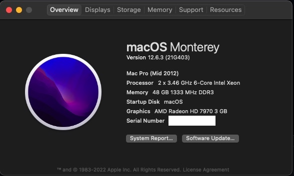

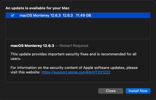

Updated MacPro5,1 from Monterey 12.6 to 12.6.2 successfully. Afterwards I needed new RootPatches in OCP 0.5.2 in order to support my Nvidia GPU again. I have to stay with Safari 15.6.1 since Safari 16 crashes with most websites, Safari 16.1 or 16.2 are no better. The crashes appear to be related to Javascript.
12.6.3b is out

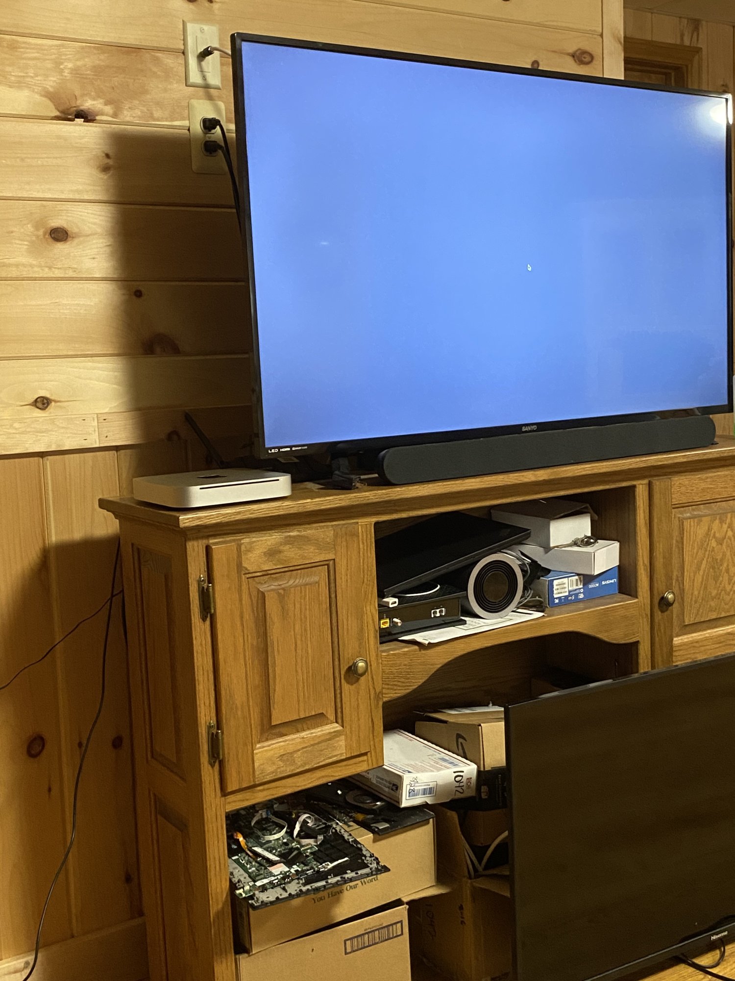

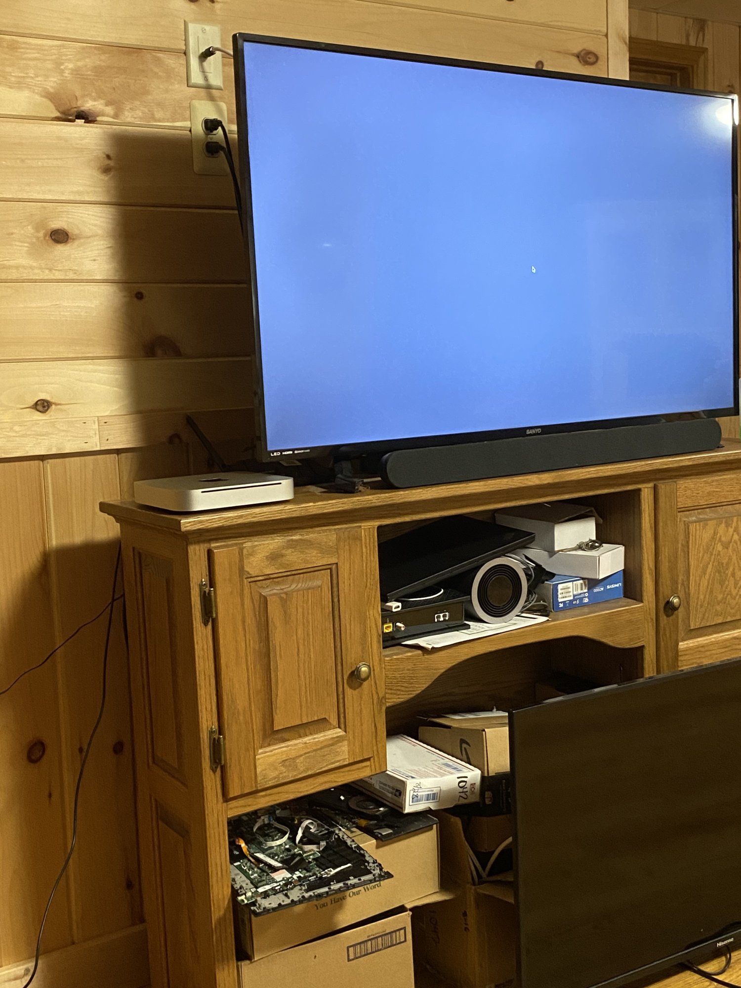

Well taking the plunge and updating my Mac mini mid 2010 to Monterey was able to get installed after installation and first boot hello screen comes up and when you hit the forward arrow it freezes for a minute then goes to a gray screen and seems to be stuck there…multiple installs same thing….it did take multiple hours to install and got stuck on the less then a minute remaining….but installsucceeded….now all this slowness I have a feel is due to the core 2 no supporting aes….anyone run into this and what did you do…back in the day in leopard there was a way to boot into command prompt and execute a var setup done command which bypassed setup assistant after install is that still a thing? I attached a photo this is the screen im suck on after you hit the forward arrow on the screen that says hello in different languages.
