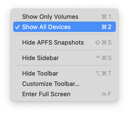

This is the difference in the "View" menu of Disk Utility:

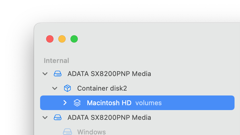

What you did erase:

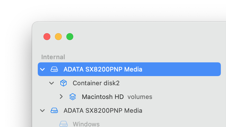

What you should've erased:

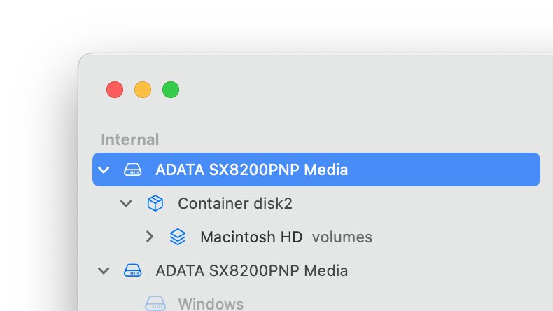

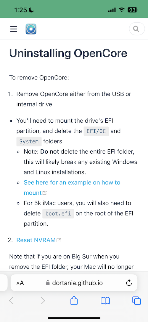

You refer to guide's page (as below) and follow the steps, right?
That would have been ok, provided you could boot up normally. Since you could not, reset NVRAM has to come first.
Do you see now that good understanding is important, rather than just following steps?
Do you see now that good understanding is important, rather than just following steps? --------------
