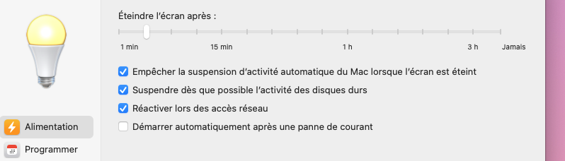

Hello
On Monterey (ocpl 5.3 / Mac midle 2010) I had a problem with the screen and a coming back after a sleep. In the energy saver I select the first item and the problem is resolved.

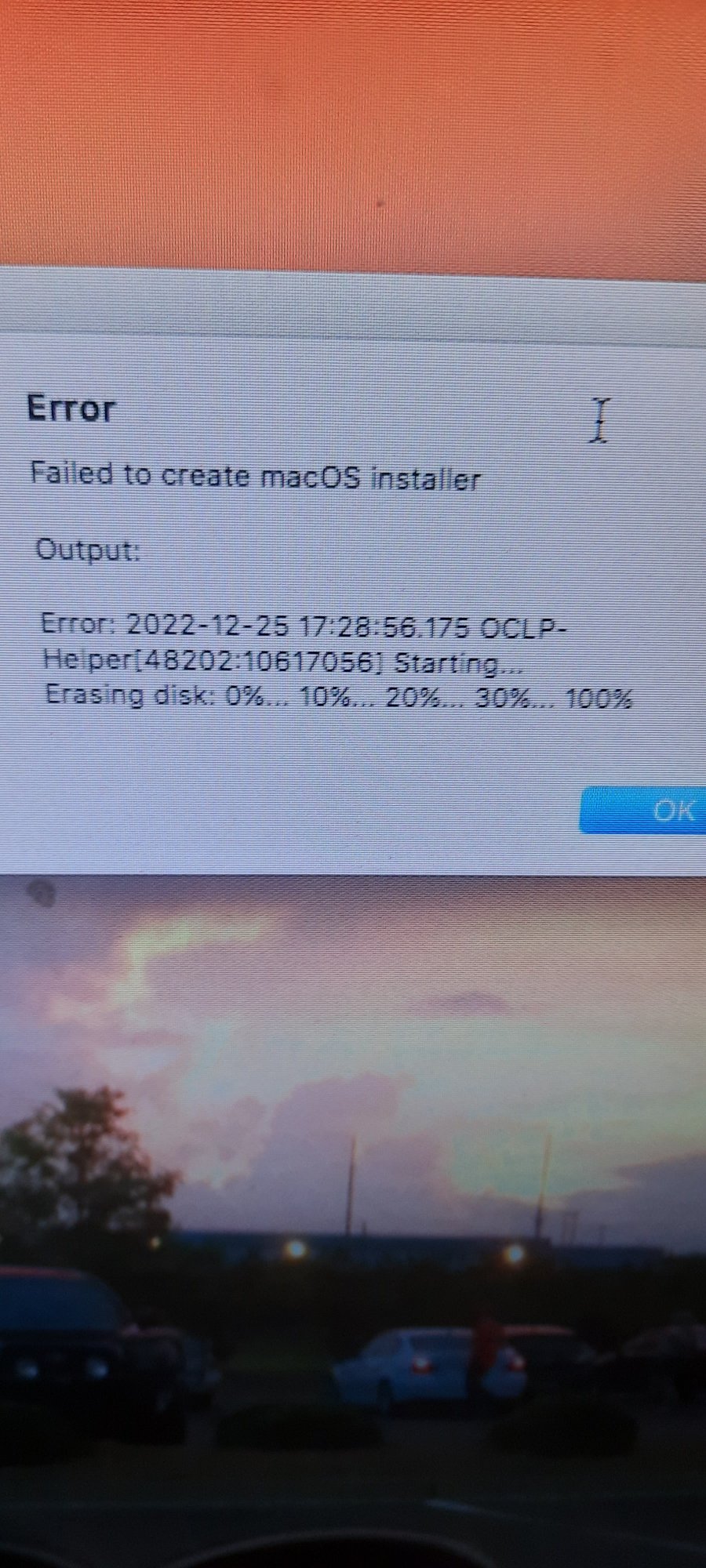

hi....im on my 2009 mac mini...with sierra 10.12 (from Dosdude Patcher)
i want to go to montery....but can i just go oclp steps....im wondering about the APFS ,will the install work...or do i have to do the APFS Patch first.....or can i just use my 0.5.3 oclp and create install usb ,and install
ive been having the error creating usb install with oclp....my monterey install is in my applications folder.
i read where someone took it out of applications,and put in other folder,then oclp create media worked
but if i try and move installer,it just moves a 4kb shortcut...but remains in applications.
thanks for any help.

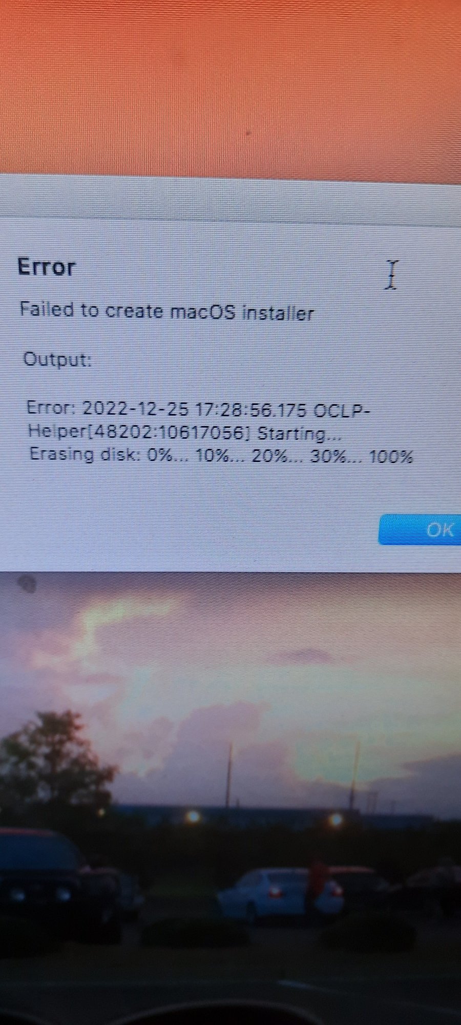

OCLP shoud be able to create a USB installer from the Monterey install in the Applications folder. Did you download it from OCLP? What is the error?
You can move something from the Applications folder in Finder by holding down the command key and dragging into the other folder.
After booting from the USB installer EFI maybe you could start with installing Monterey to external media first and see how it goes.
thanks

thats my error.....yes i downloaded monterey from oclp
im trying again tomorroe with an ssd drive as external drive
