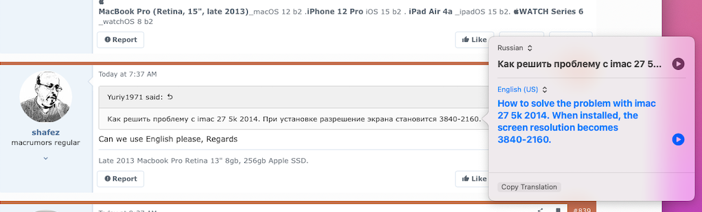

Как решить проблему с imac 27 5k 2014. При установке разрешение экрана становится 3840-2160.
How to solve the problem with imac 27 5k 2014. When installed, the screen resolution becomes 3840-2160.

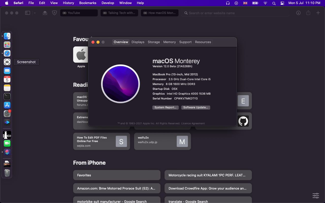

How is scrolling and animation performance compared to Big Sur?
EDIT: mid 2011 (not mid 2012)🙄🙈
For me, on my mid 2012 27” iMac, Monterey has ran a lot better than any version of Big Sur.
My experience is that it felt like Mojave. I stayed on Mojave as I thought GUI performance in Big Sur was poor on my old MacBook Pros. I'm running Big Sur on my M1 mini and it's fine but it's an M1. I also tested Big Sur on the 2020 iMac 27 and performance was fine. It seems like you need a good GPU to run Big Sur and that this has been fixed on Monterey.

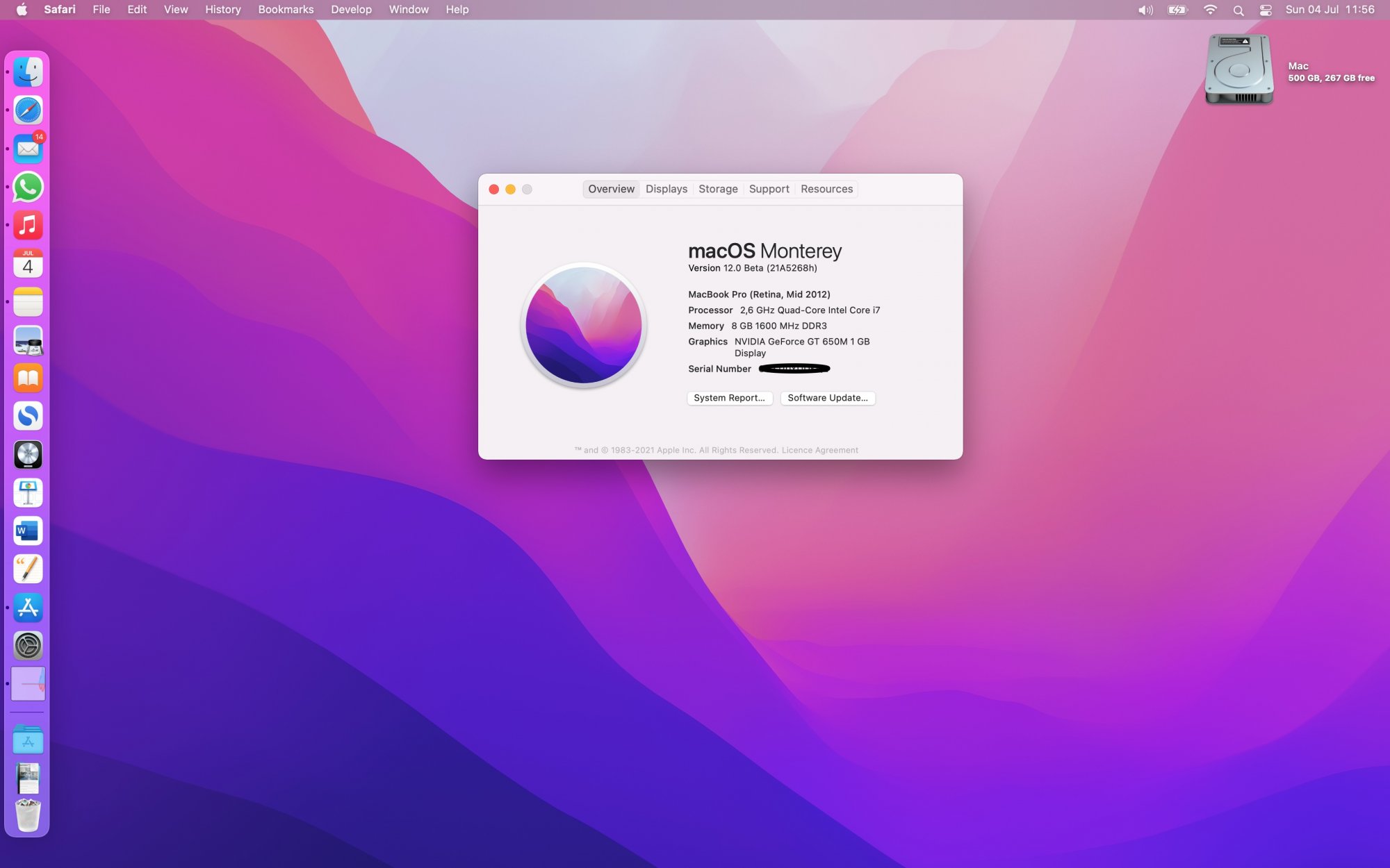

I wiped my Monterey partition (which had been running quite well), thinking I'd try an 'unsealed' install of the OS this time. However, the old 0.51 BS micropatcher will only modify the Installer files if you rename the drive and app to Big Sur. That did boot but stuck just before displaying the Monterey install window. Is the only current option for trying 12.0b1 to use OCLP and end up with an encrypted/sealed OS...whether you like it or not?

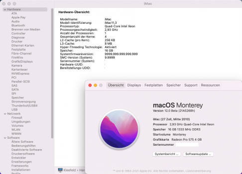

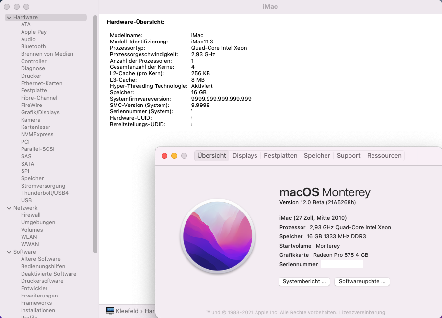

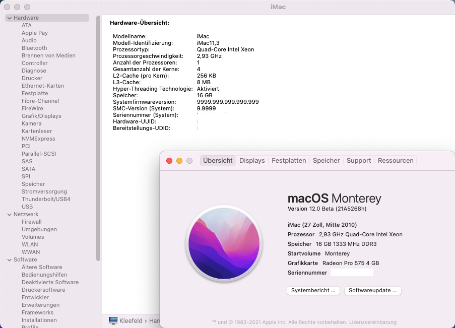

The iMac11,3 2010 with RX480 is rock solid during the normal usage, I do not reboot every day unless I do updates, it never fails, it never reboots.
Even with my recently upgraded CPU (X3470) it is quite happy.
